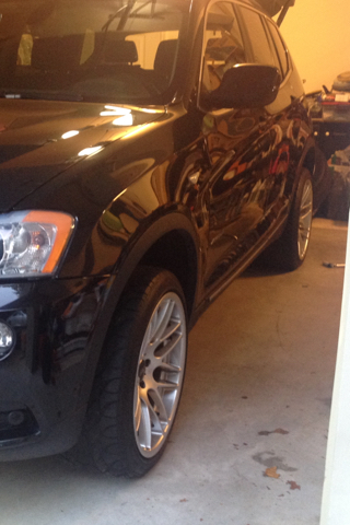

Oh and here is my 20" setup as well. I had my own thread but for the sake of this one.
245/45/20 all around MRR H-10.
I've since modified the BMW center caps to fit the wheels so it looks more OEM.

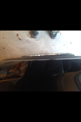

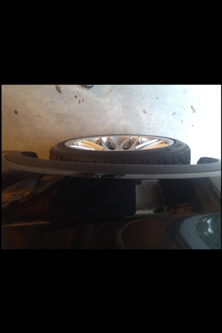

Okay so here are some pictures. What you see is the 10" wide 275/35/19 in front and rear. (They were the rears on my coupe. )

One last try. Top down at two different angles.

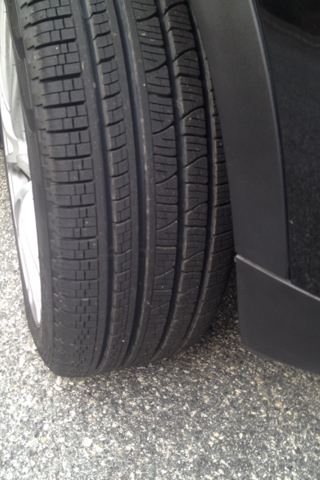

245/40/20 Yokohama Advan A/S. SoFla to Iowa and viceversa. No choice but to, as I wasn't going to run summers in temps below 40F. I'm liking these tires so far, was going to go with the Continental Extreme DWS or Michelin Sport A/S. So far I am pleased with the peformance and looks of the Yoko's. I even put a set on the MINI :thumbsup::thumbsup:
