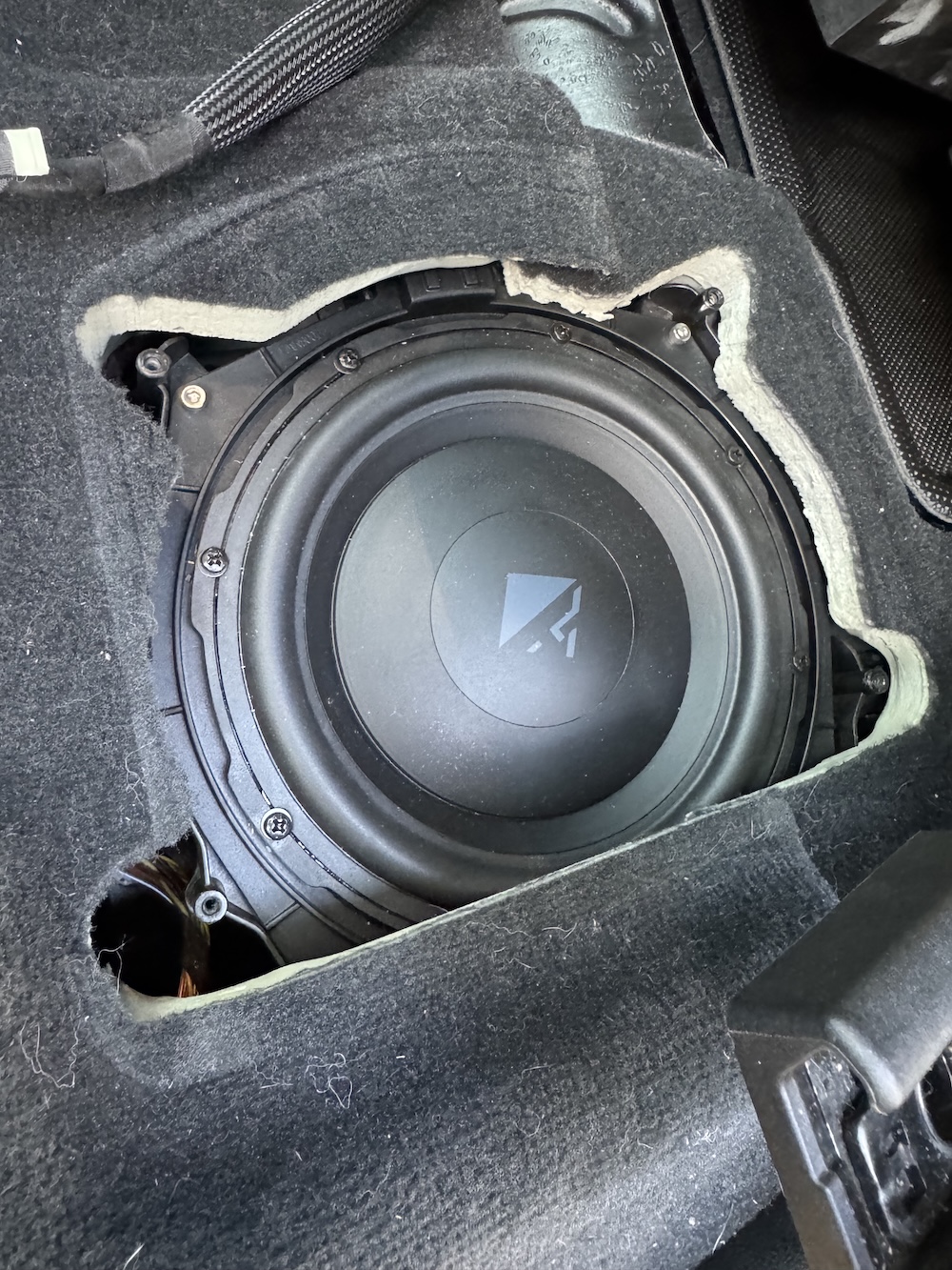

I am using a JL Audio ACS110LG-TW1 powered subwoofer which includes a 400W amp.
I have already coded the B&W feature in the head unit but that was a couple weeks before I installed the subwoofer.

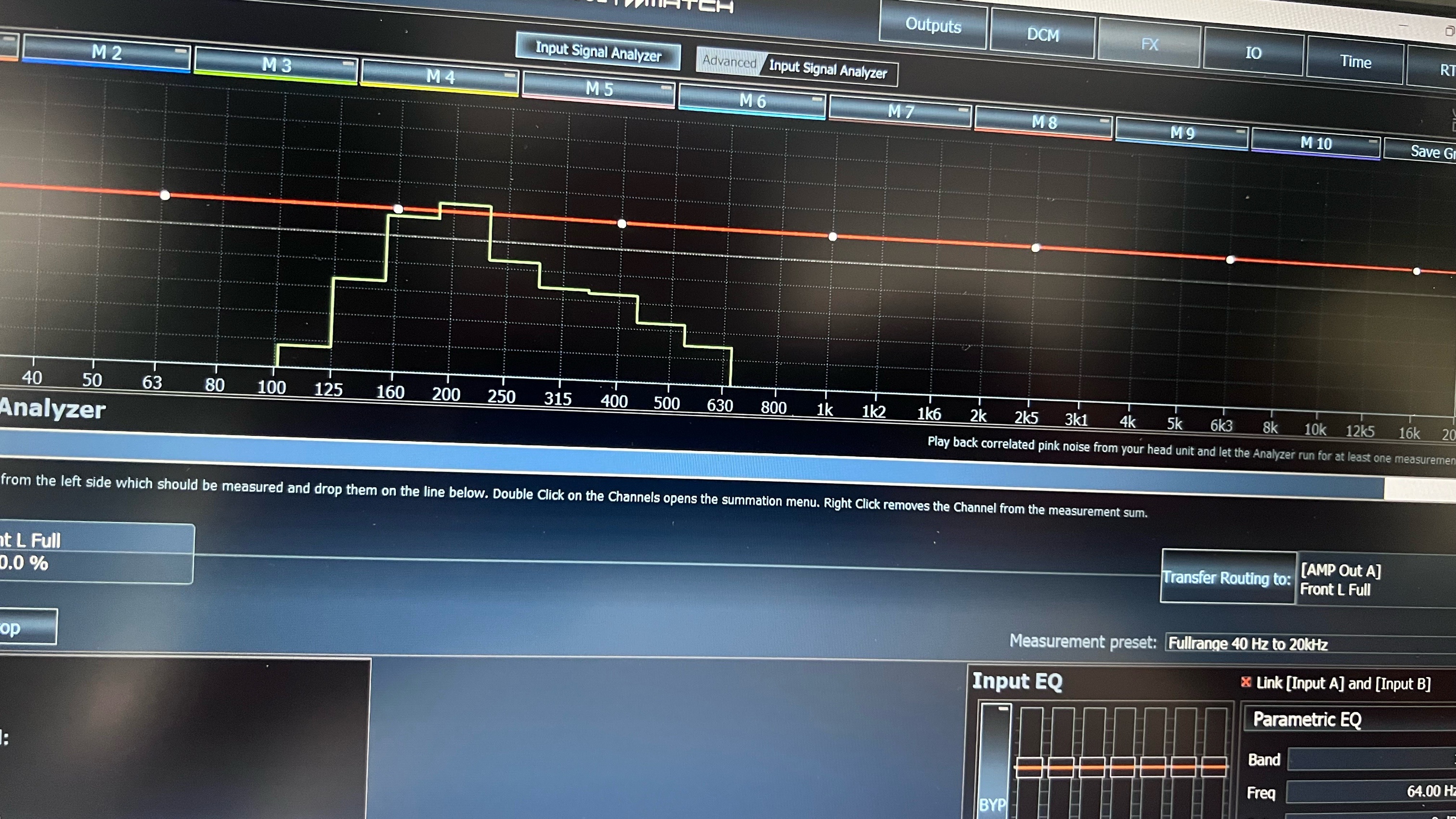

I though this was interesting. I’m running pink noise thru the input Rta and look how much the factory amp KILLS the upper frequencies! They pretty much boosted all the mids and cut all the highs. Flattening out the curve makes a HUGE difference! I believe THATS where having the dsp on this system is gonna come in handy, not just the implication but the Eq correction!
Folks were wondering why I thought the timbre of Sports talk hosts sounded different in this car than any other car!
At least now we have technical proof that BMW "didn't even try"!
Yeah the factory curves are usually pretty funky, but I was surprised how much life they sucked out of the frequency range….

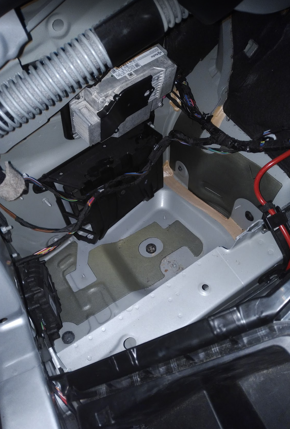

Excellent writeup, thanks! Getting ready to pull the trigger on a new RAM and Booster now. The 8DSP was enticing, but considering that I can get the subwoofers and modules on eBay for $500 total, I'll probably be happy with that for a while. I'm a sucker for the Logic7 surround effects even if the overall quality isn't the greatest.
At least on my car, I saw that the booster would be hooked up to fuses 214 and 217 in the rear power distribution box. Were you able to use the typical auto parts store "fuse taps" (the ones with two fuses and a wire sticking out) in these spots, or are they not pre-wired?

Quick adjustment to my last reply - looks like fuses 214 and 217 are already in there (what they're powering, I'm not sure - my 530e doesn't have a booster from factory). My game plan is to use an add-a-circuit fuse tap on F214 to run the 5A supply and run a 40a fused line straight from the battery to the booster.
My remaining question is, what was your mounting solution for the booster? Did you shell out for a new bracket, or employ a more creative solution? Here's what mine currently looks like, no mounting point for the new booster.

I used the factory location for the booster. On my amp bracket there is an empty area on the back of the bracket the booster normally goes. Is there not a factory location for the 5 series? I would look up where it goes for HK equipped 530e vehicles.
I added a fusebox terminal from behind, the fusebox panel is easy to remove to get access to the back. The add-a-fuse method should work fine though.

Unfortunately, the bracket I have doesn't have any good mounting point for the booster. Did some digging and not only is the bracket part number different for HK-equipped 5 series, but the cubby in my trunk is also too large to mount the booster in the stock location. Shouldn't be a problem - I don't mind getting creative with the mounting location. Duct tape may be involved...

That I'm not sure, because I have ASD disabled. I'm pretty sure I retained it, and SiriusXM works, the radio ID just changed so if you have a subscription, you'll have to provide a new radio ID.
