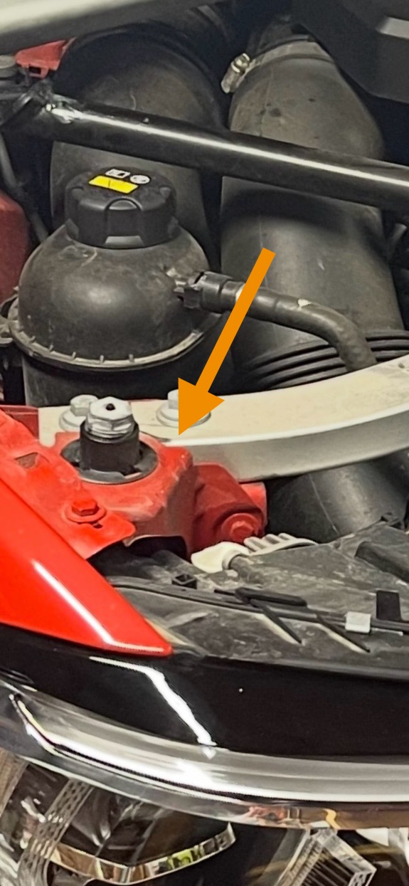

FlowState wrote
You can use just an extension through the fender well door to get to both of the lower headlight bolts. They don’t need to be fully removed. Just loosened and backed out a bit.
If you haven’t already, plan on getting the shorty 1/4” ratchet to get the screws for the modules out.
https://www.harborfreight.com/14-in-drive-compact-socket-and-bit-set-52-piece-70695.html
Sweet, Yes I have 1/4 drive low profile milwaukee torx and some extensions I can combine to get the headlight bolts. We'll see if the low pros are shallow enough. Doing them this way, does the light move fwd enough to leave the metal brakets with the hood adjustment pads in place?
03-21-2026
FlowState user avatar
FlowState
///M Driver
297 REP
2.1K POSTS
Nah, you definitely have to remove that bracket.
Stuff a few towels in that space so you don’t lose your bolts if they fall.
You’ll need to use a towel against a prybar to gently pull the headlight forward enough to release the module and reinstall the module once the top headlight bolts are out, and lower ones are loosened. It’s definitely a tight fit so don’t rush it.
