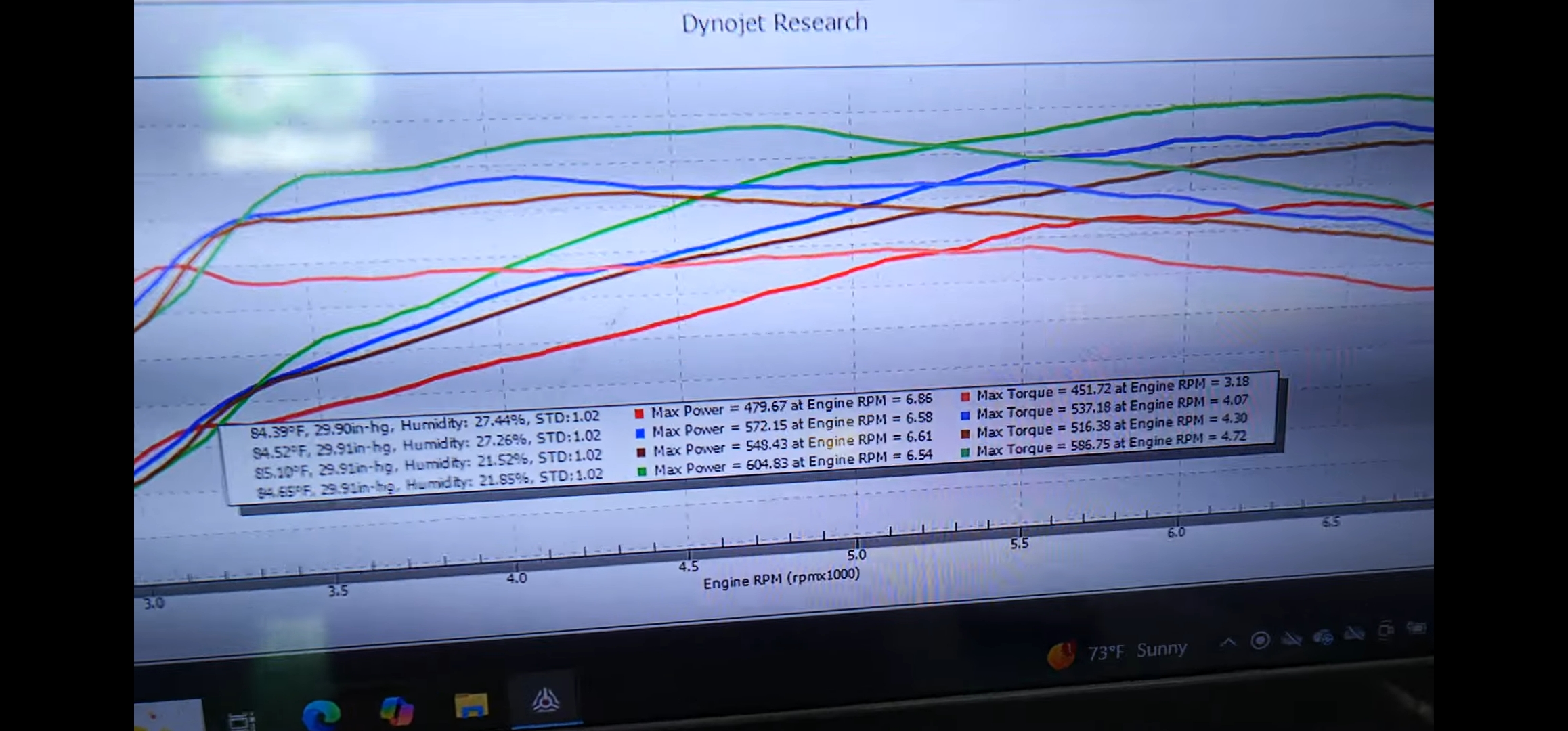

Will probably look into it eventually. Don't wanna hijack Brock's thread though lol. I wonder if someones compared the OTS stage 1 to a custom one and what the delta was

Racebox did this and the peak gains higher, but the mid-range from a custom tune was where the major gains came from. Screen shot from video shown.
BMW M2
Stock 479whp/451wtq
MHD OTS 93 stage 2 572whp/537wtq
Racebox custom 93 604whp/586wtq
