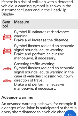

All of these plus the triangle as mentioned at the bottom of the attached picture. This is from the manual. Highly recommend to :sign0012:

Thanks for the replies. I also assumed collision warning, but I’m fairly certain that lights up in the center of the cockpit (and on HUD) and is accompanied with lights. I’ve seen it plenty of times, and is an orange/red car per the image titomi posted.
My wife says location was to the left, above the speedometer, no sound, on a highway straightaway.
The manual also doesn’t have a car icon with a triangle on top of it listed anywhere that I could find.
It’s at the dealer now, maybe they can figure it out.
Thanks!

lifeshonanstyle's user avatarlifeshonanstyle picture is from MY18, so might be different in your car.
It WILL eventually engage the brakes. That's part of the emergency braking and it's not so well documented in the manual.
