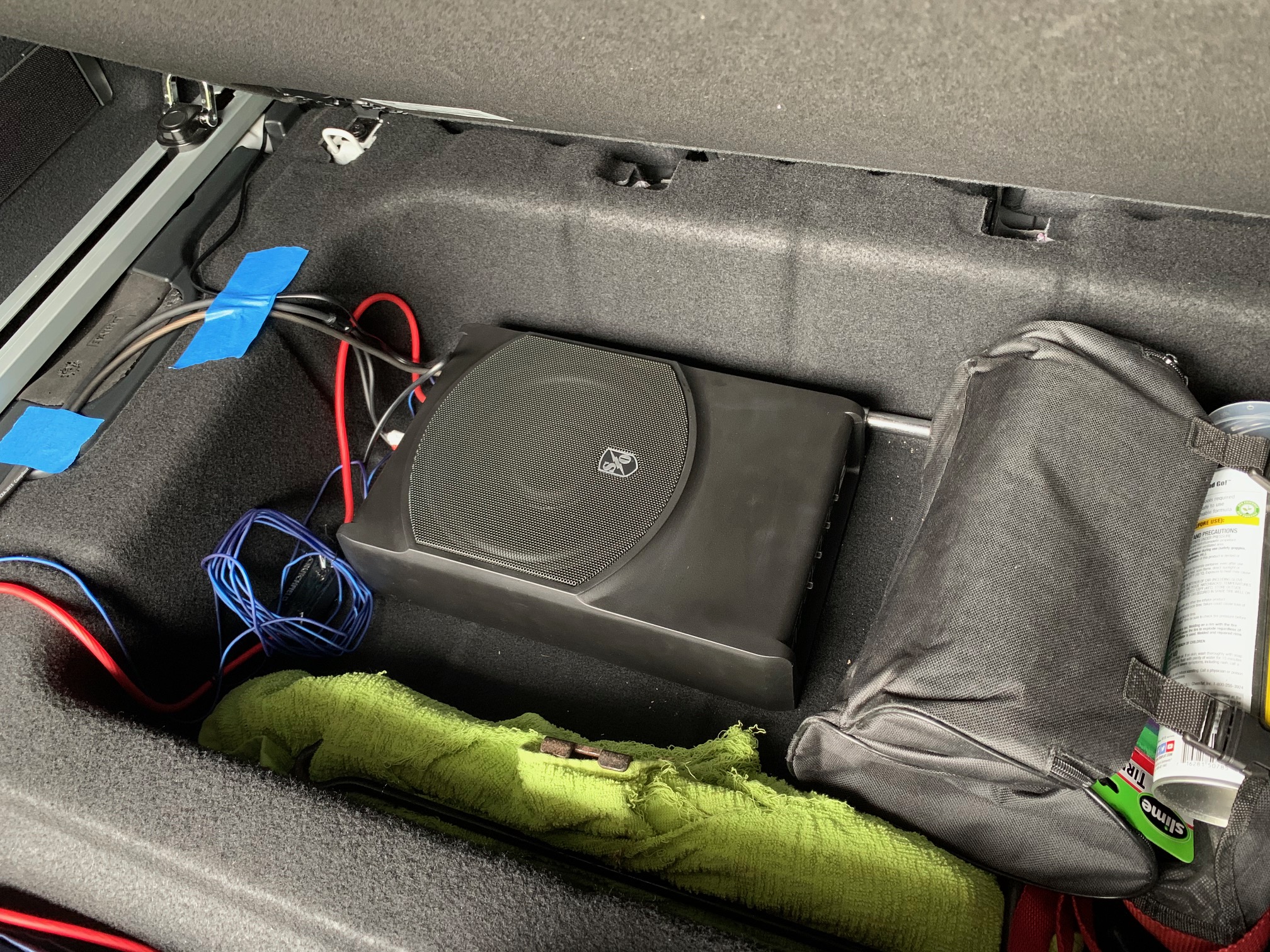

I got so tired of the lackluster X3 HIFI stereo . It sucked bad.
In my beater Tacoma I have a $150 JVC with 4 Polk 6" er's plus a Sound Ordinance 8" powered subwoofer that blows the BMW out!
So I bit the bullet and finally bought the AudioTech Fischer Match Up7BMW.
Well needless to say it was an improvement but not a $1,000 one by any means . I really didn't want a Sub in the back so I opted for the Match underseat sub replacements . They really hype those speakers . Another $400 ....meh , nothing burger .
I couldn't see at this point any real benefit at $1400!
The under seat subs are a royal pita to get out of their enclosures without damaging the factory 25watt speakers if I wanted to swap back (not happening).
At this point I'm all in and not quitting. What's another $200 at Crutchfield ? ( sub and cables etc ... ) I bought another Sound Ordinance 8" powered sub 125watt rms 250 max and temporary velcroed in the storage boot.
Huge difference !
Still needs some tweaking and for a small enclosure it's good enough for this old man . It will rattle the rear license plate with the right song but I'm not all about that . I just want some depth in my music . I bluetooth Pandora or my iTunes playlist via iPhone . No audiophile here really .

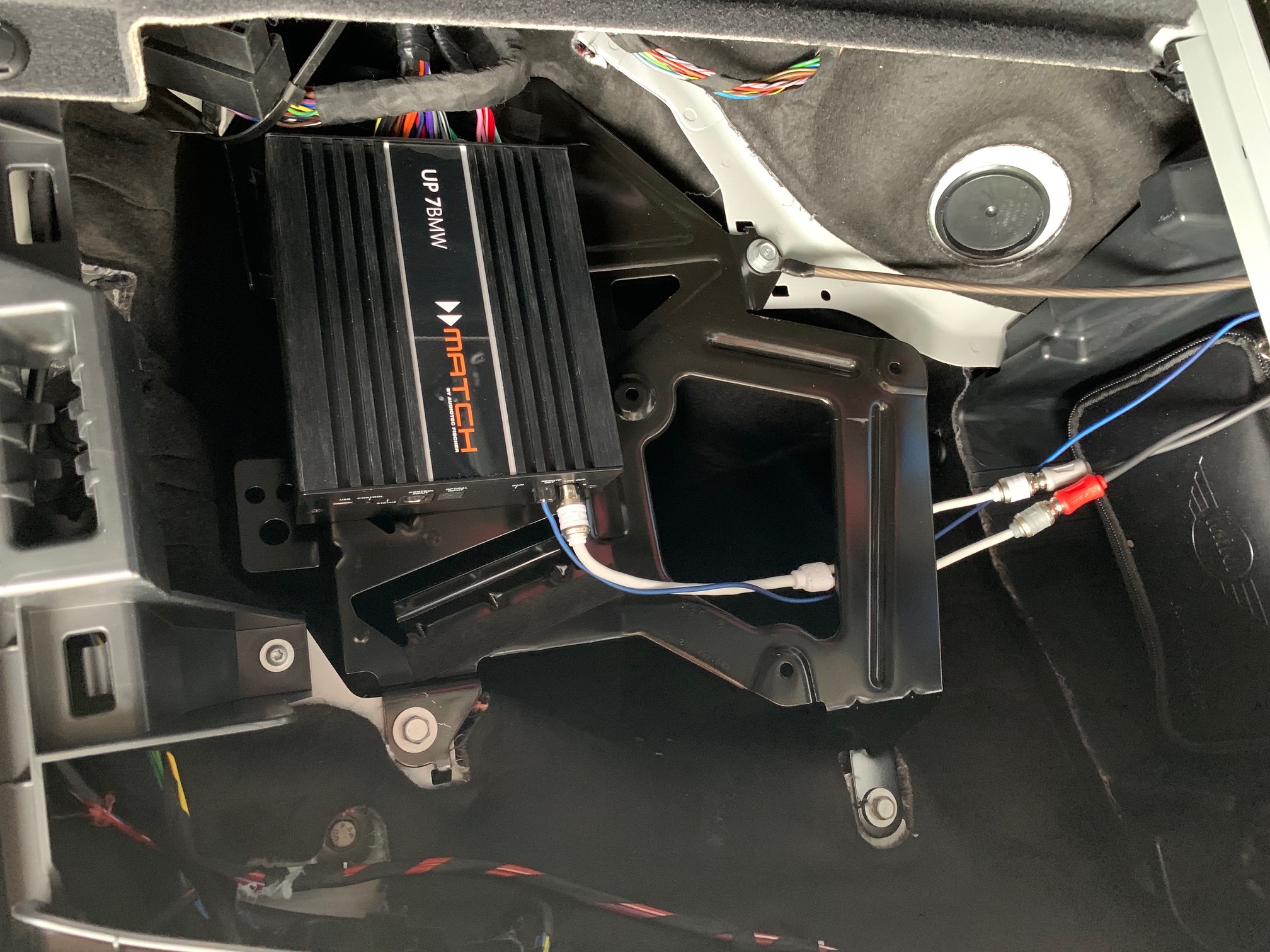

The one saving grace of the amp is the RCA out for a sub rather than jump off the underseat subs for a signal and run wires ( pita).
Another plus with the S.O. Sub is it's an in house Crutchfield designed/designated product with a 3 year warranty. The one in my Yota has held up at least that long .
more will be revealed hopefully with some guesswork with the DSP software for the amp . Unfortunately it's Windoze based software for a laptop . :sigh: . Haven't found anyone locally that knows tuning DSP. Plenty of installers , posers.
note this is not a permanent set up . wasn't sure I would hear/feel it locked down back there . it will be much neater sans the painters tape :confused0068:

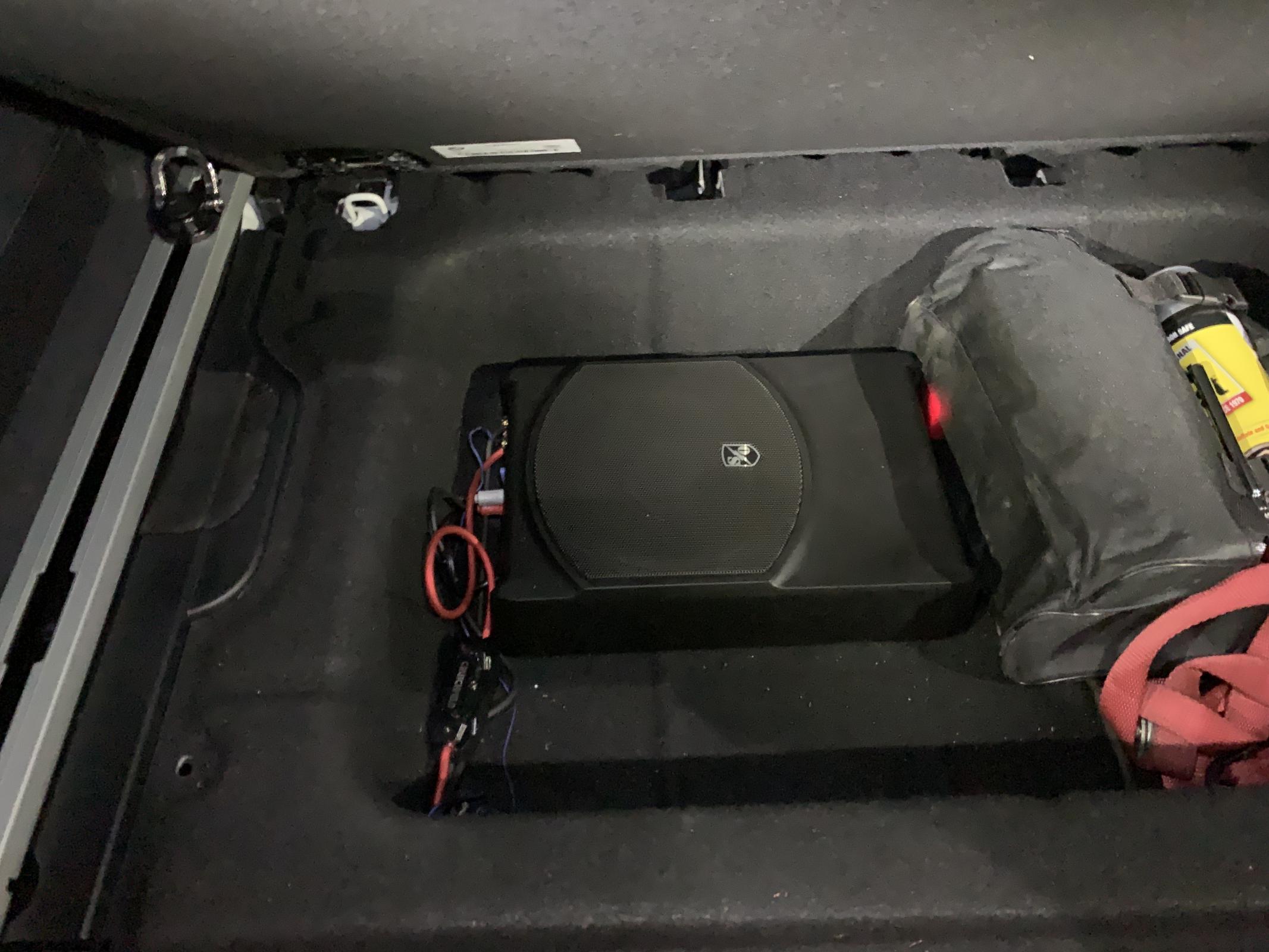

follow up on hifi stereo fix .
after a couple of adjustments to sub (gain , phase ) it found it's groove .
This is by no means a mind blowing experience but given the fact that Harmon Kardon has been taken off the table on new orders this is a viable option .
If I had to do this experiment all over I would definitely skip upgrading factory under seat subs .

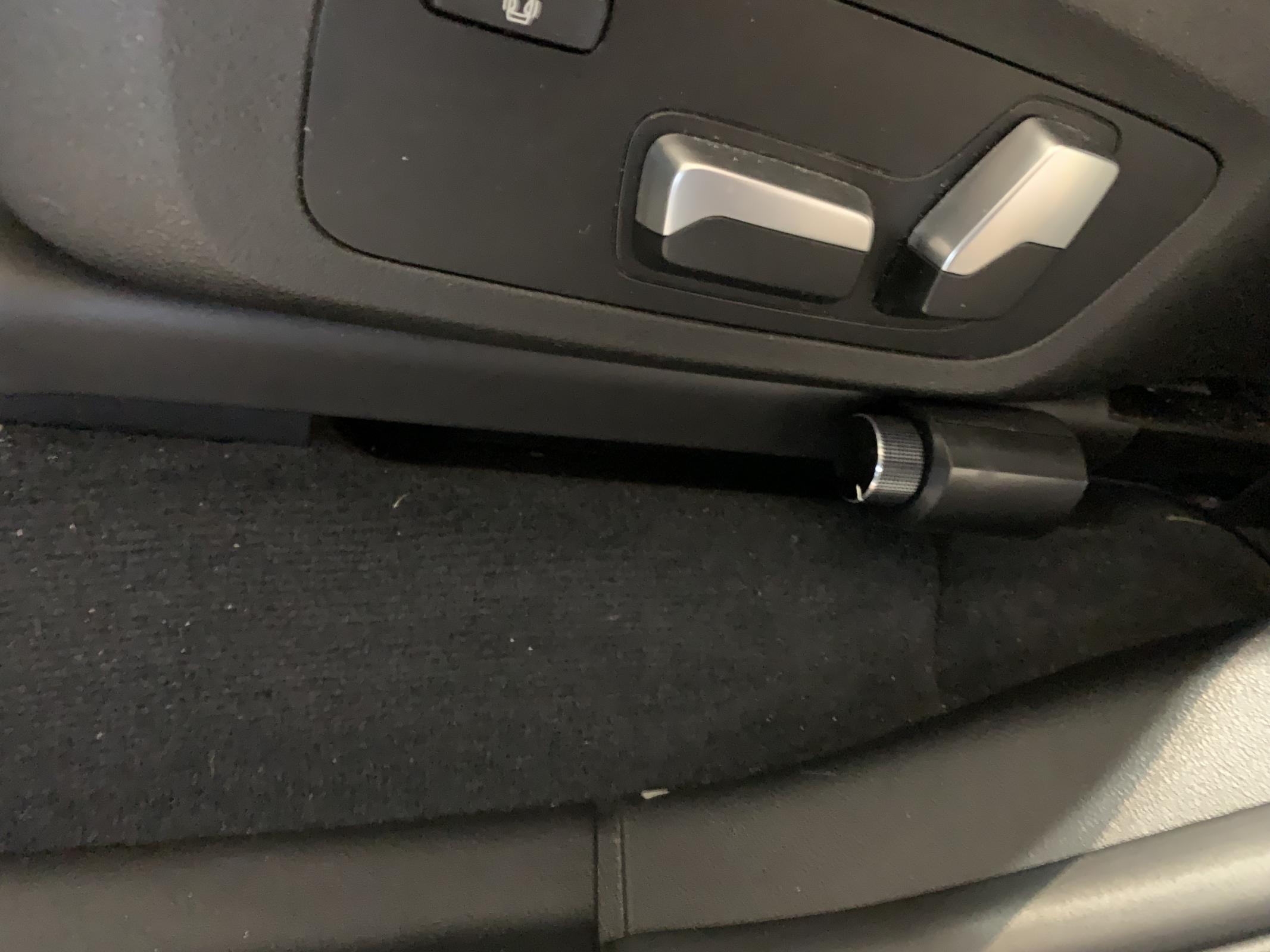

If the bass gets to be too much I have the supplied sub controller 3m tape mounted next to the seat controls (pic #2)
The sub doesn't take up too much room . I have room for the aftermarket spare tire ...lol

Hello
I recently installed the 7bmw into my hifi-system and WOW..
Yesterday I installed a external monoblock amp(Gas alpha 500.1) and a 12" sub(Gas alpha 112) in the trunk
BUT I just could NOT get any sound out of the subwoofer..
As I realised there is some settings that might have to be "activated" in the dsp-tool, right?
Is there anyone who also has installed external mono and subwoofer in the trunk and has made/found a good working setup-file
and would mind sharing it with me to try?
It is also interesting if someone would mind telling me what settings I need to configure to get some sound out of my external setup?
But as said, I would be more than excited if someone in here have installed a external subwoofer in their trunk and would consider sharing your file for me to try!

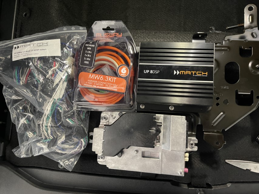

After reading this thread and the other one regarding the RAM amp in the BMW sound system, I decided to order the Match UP 7BMW. Then I tried to order it through dealer in UK, and he told me that I shouldn't get the 7BMW. My car is 2022 ID7 Hi-Fi with 11 speakers and the RAM amp. He said I should go for Match UP 8DSP instead. Thus, I ordered the set of Match UP 8DSP + PP-BMW 1.7 RAM UP 8DSP Edition + MW6.3 wire kit。
It took 2+ weeks to ship.... guess it's the cheapest UPS plan.
Below is the set and the original RAM amp sitting in the trunk. I forgot to take a picture of the box with the harness and the cable.
https://x3.xbimmers.com/forums/attachment.php?attachmentid=3131250&stc=1&d=1679044372
sorry for one picture, I'm still trying to figure out how to post here.
