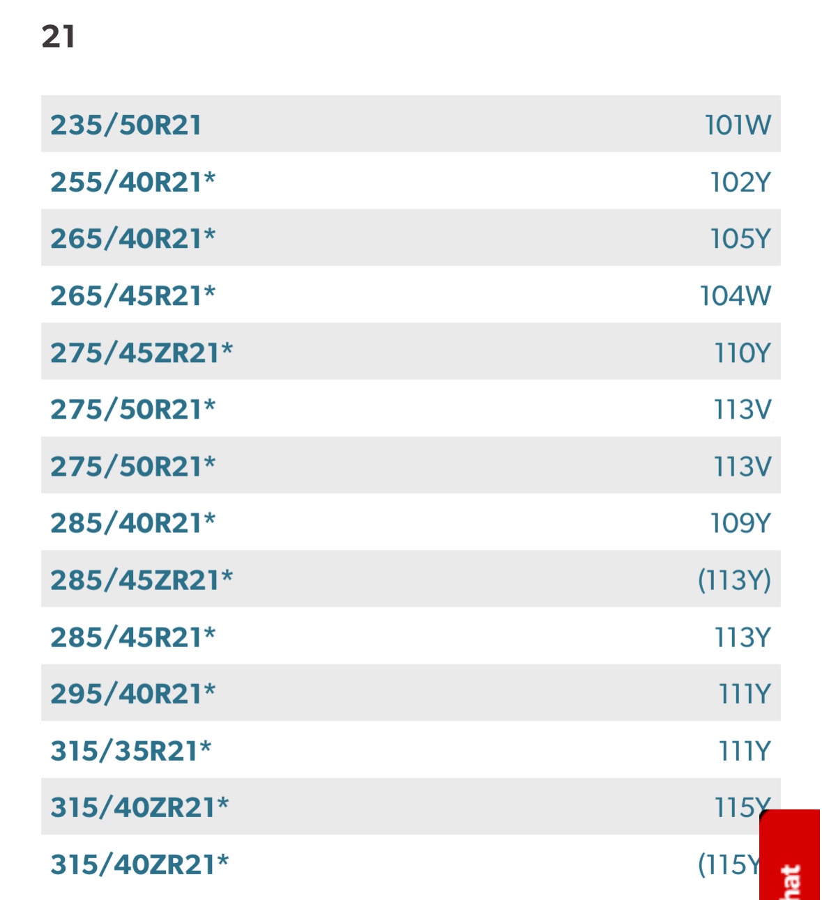

I saw mention of running pilot sport 4 suv tires on the 718m but after looking couldnt find staggered sizes to stay within 1% diameter.
Anyone ever run these and what sizes?
255/40-295/35

Originally Posted by peeezy View Post
255/40-295/35
Dont see the 295/35 anywhere.
you can find them u just have to search better. tirerack has em too.
https://www.michelinman.com/auto/bro...sion/295/35/21
Yea man not there lol.
Pilot Sport 4S shows up on tire rack but not the Pilot Sport 4 SUV.
Try this: https://www.michelinman.com/auto/tir...ot-sport-4-suv
Looks like a great tire.

Originally Posted by ContactPatch View Post
Try this: https://www.michelinman.com/auto/tires/michelin-pilot-sport-4-suv
Ive checked there. Its takes you to a page for the PS4S not the PSSUV.
This is all tirerack has available for the SUV tire.

Yea that's the problem with these 718m. There's such a slim selection for tires if you aren't looking for summer tires. I'd mess around with the tire calculator and figure out some combos where the diameter difference is under 1%, and also don't forget to make sure the circumference is close to the stock number so your speedometer reads the speed right.... And oh also don't go too wide or else you won't have strut clearance...
I know.. looks like i will either do Michelin PS4S or Pirelli PZ4 in 255/45 - 285/40 or 255/40 - 285/35. Wouldnt mind a little more sidewall for a bit more comfort.
Won't the bigger sidewalls change the speedometer readings?
Does it? Had no clue. Guess im sticking to the 40/35.
