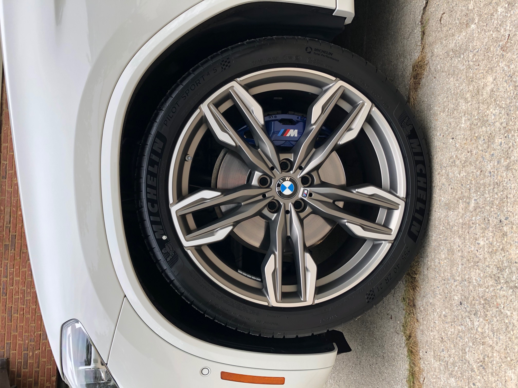

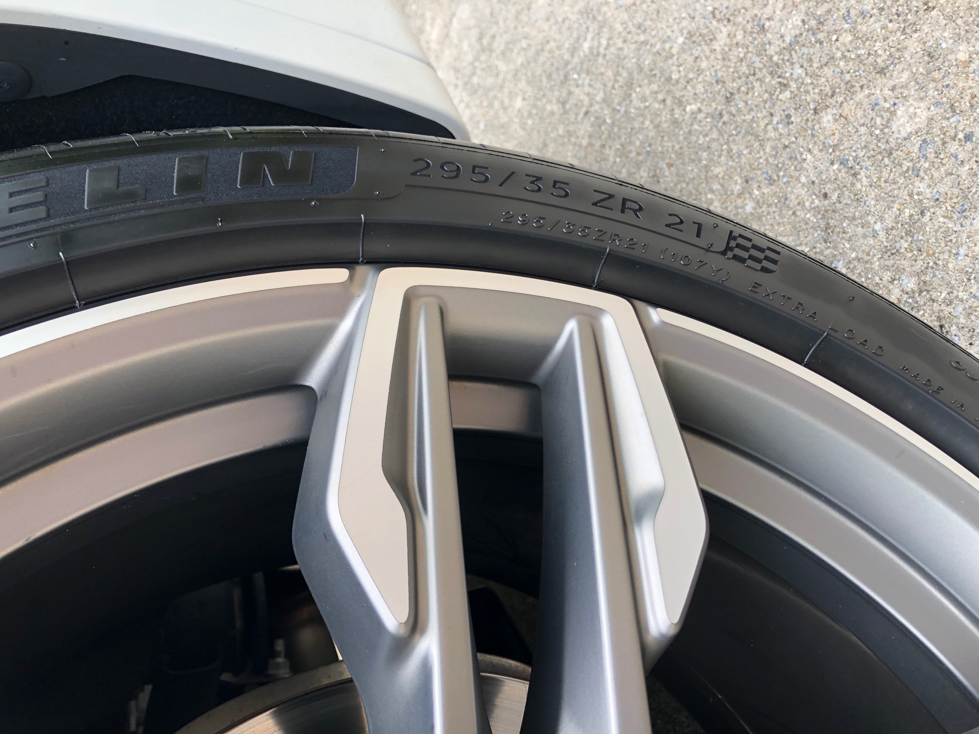

I finally upgraded to my old Bridgestone Potenzas RTF's to no RTF Michelin pilot sport 4s in 255/40 and 295/35 on the stock 21" 718M wheels. Mounting was done without any issues and the ride is much smoother and quieter. I really like slightly meatier sidewall especially on the rears. During higher speeds, car feels more planted but I do feel the turning is slightly slower with this staggered set up. Regardless, I wish I have switched long time ago but was worried with fitment issues. I have 0 rubbing at full turn and I am lowered on H&R springs.
With this set up I’m still at .3% difference between front and rears.

Can you take a few more of the tyre side on so we can see the overhang better ?

I’ll take some better pics today

what made you go with 295 on the rear ?
They do a
275/35 ZR21 (103Y) XL
and a
285/30 ZR21 (100Y) XL
      09-24-2020, 08:27 AM   #8

Those won't work. I did my research.

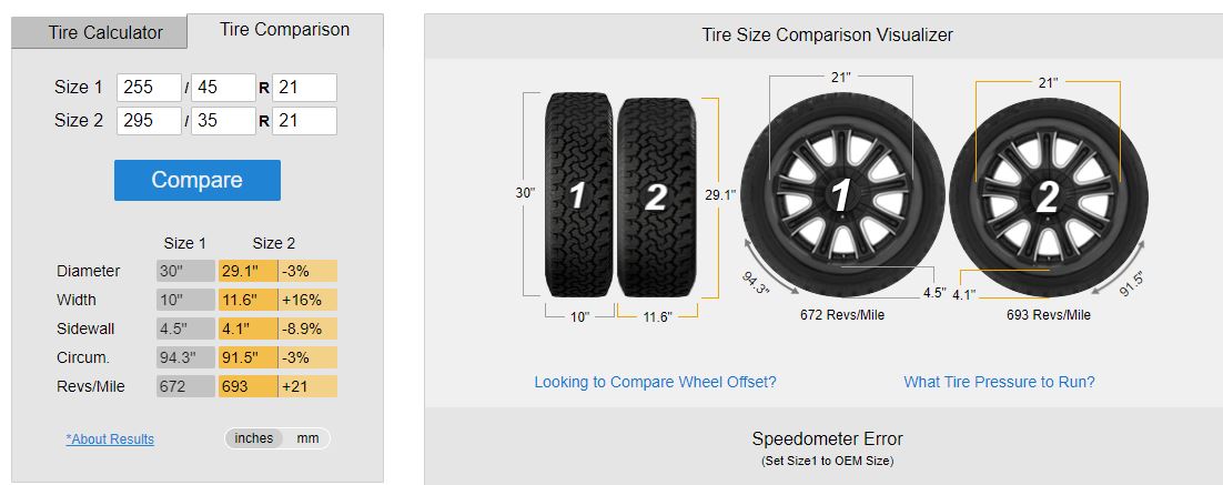

Diameter difference between front and rear must not be higher than 1% in our xDrive system...so with 255/40 at front none of them will work.
You can check it in websites like this: https://tiresize.com/comparison/

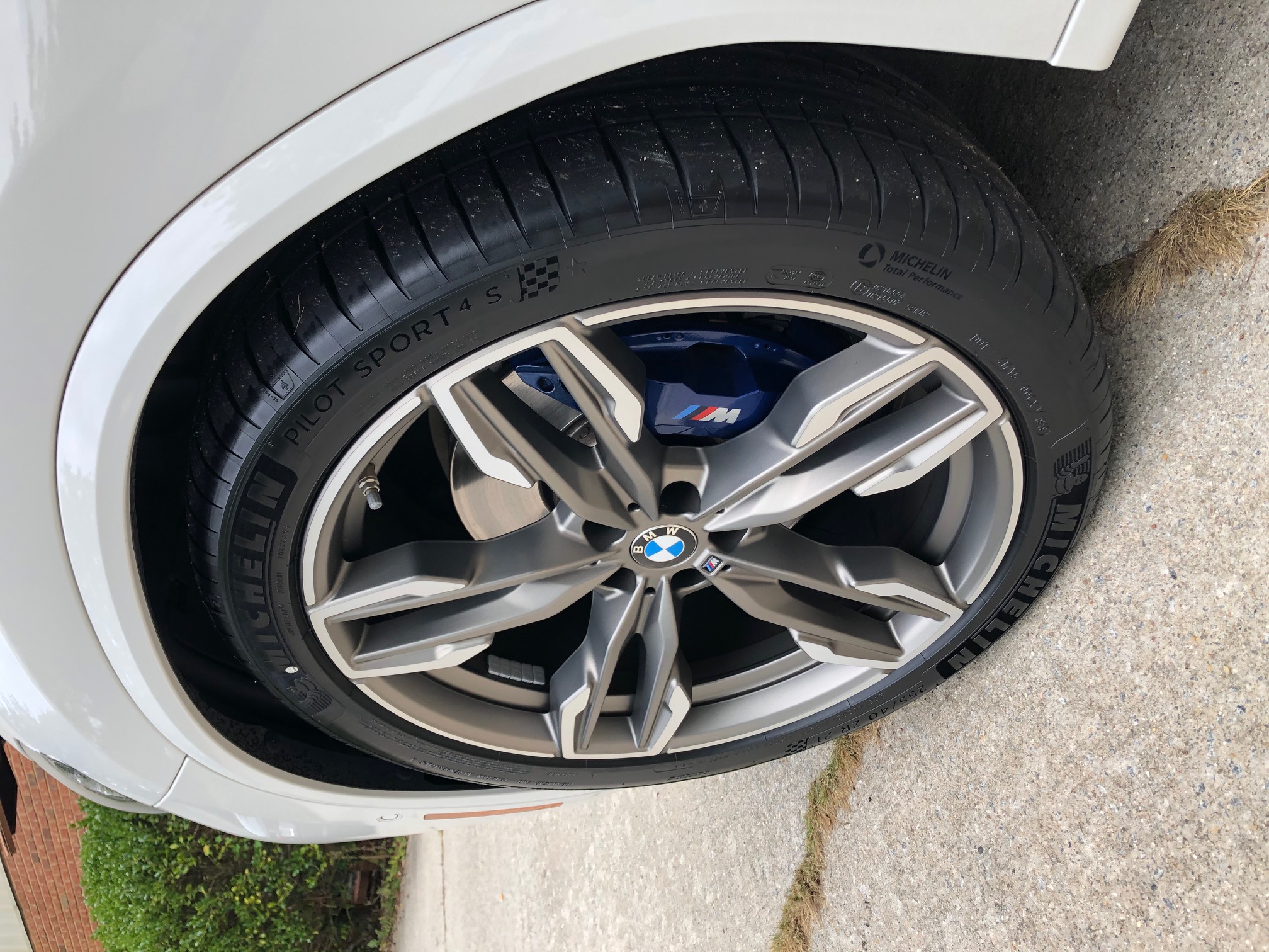

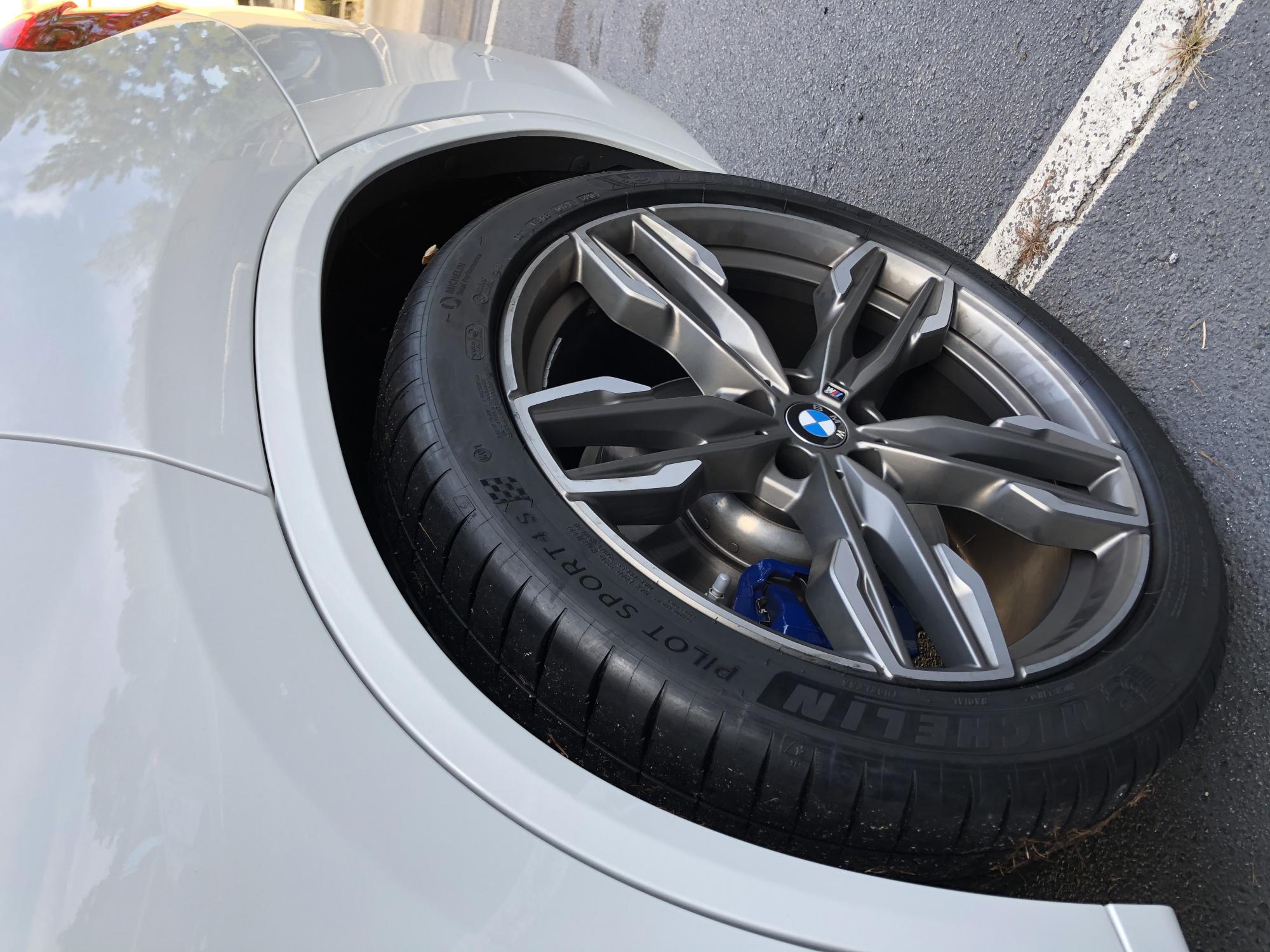

new updated photos

Looks great! I see that you have spacers installed. What width are they and did you need to realign the steering geometry?

thanks. I don't have spacers installed but plan on doing 12mm all the way around

So 255 45 20 and 295 40 20 should be similar to your % X drive difference with the 21"?

255/45 wouldn't work, it would be at 3% circumference different. see comparison photo below

So 1% is the max for our cars?

It’s what’s considered safe and approve by bmw

That does look much better and probably what I'm looking to do as well. Can you take a picture of the tire flushness and one further back from the side to see the whole car?
