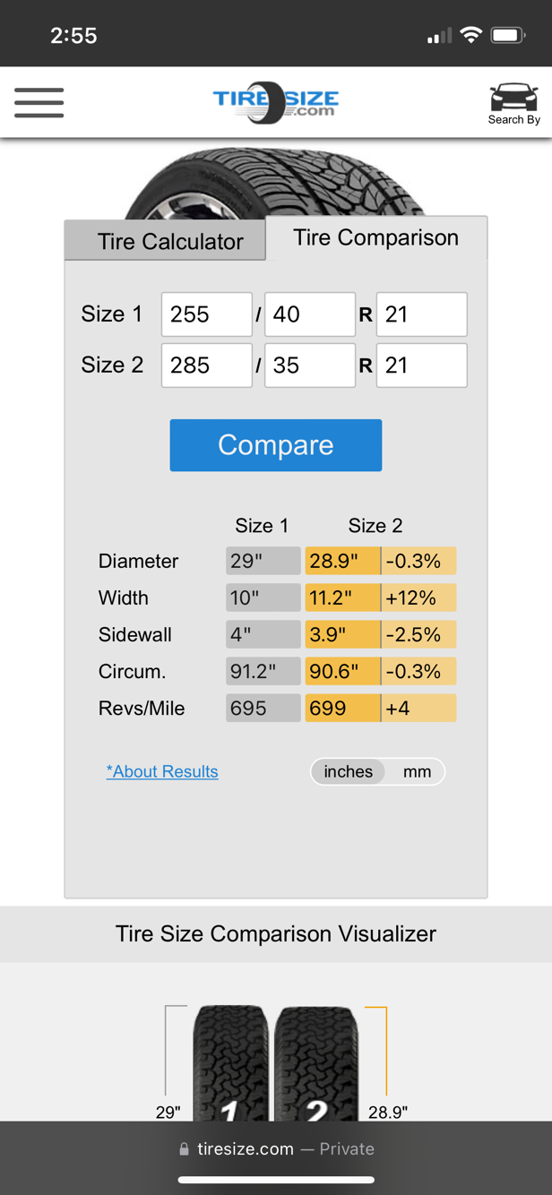

Originally Posted by suby01 View Post
So 255 45 20 and 295 40 20 should be similar to your % X drive difference with the 21"?
Sort of...
255/45/20 vs 295/40/20 - dia delta 29" vs 29.3" @ ~ 1% difference
255/45/20 vs 285/40/20 - both dia are 29" hence ~0% difference

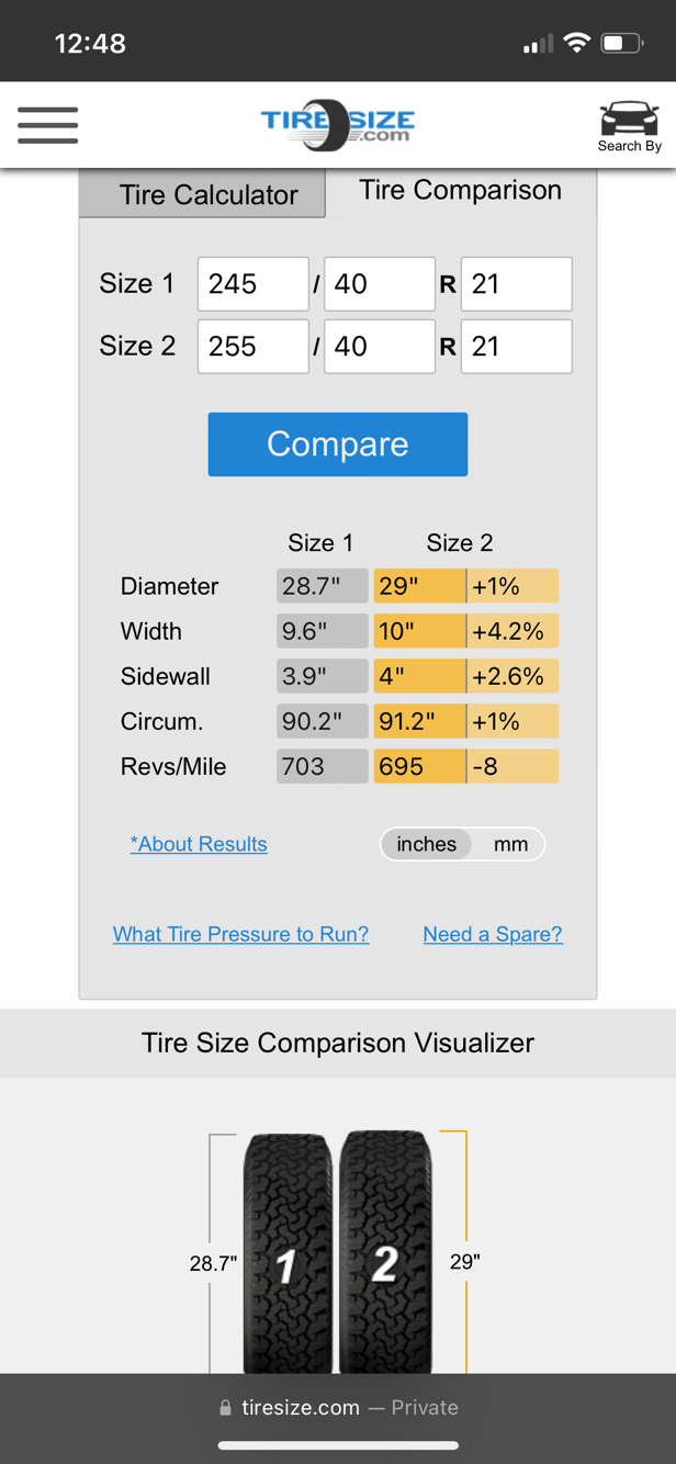

Originally Posted by 12v_dub View Post
255/45 wouldn't work, it would be at 3% circumference different. see comparison photo below
Looking at some replacement tires and reading through some threads. Just a point of clarification on this post - he asked about 255-45 20, not 21, which is the exact same diameter as a 255/40/21. So those would work, and I've used that exact size on my X3 in the Continental DSW06 just fine, no rubbing, etc.

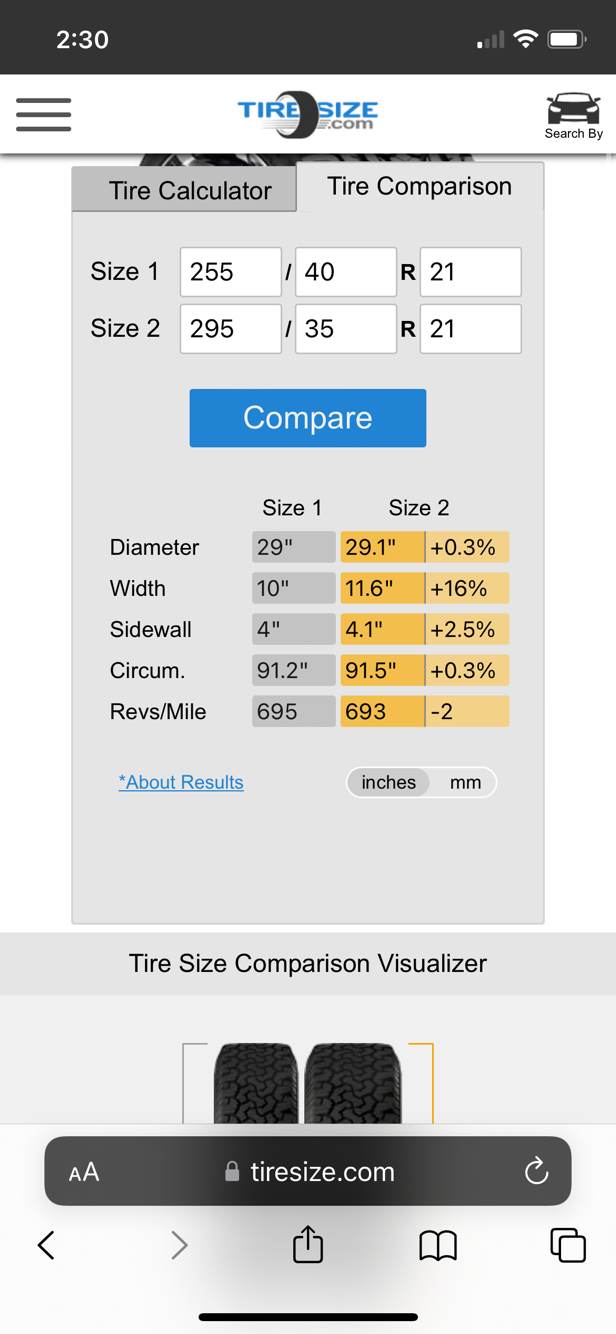

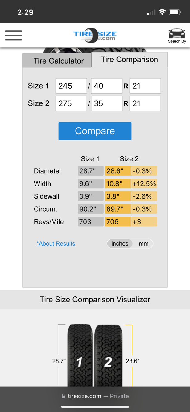

@freshxdough, I don't mean to beat a dead horse, but WTH I'm doing wrong when calculating these 21" tires sizes?? Everything I've read here says 255/40/21; 295/35/21 work on stock 21" M40i wheels (obviously, you are riding on them as are many others). But how are these OD calculations .3% like noted below in that Thread? Aren't they more like 1.05% front and 1.7% rear, which exceeds the 1% xdrive rule?
New Michelin PS 4S 255/295 on 718M https://x3.xbimmers.com/forums/showthread.php?t=1760448
cehrl7 I tried responding back to your PM, but your mailbox is full. I don't see Michelin offering the PS All Season 4 in 285/35/21
'24-I20 iX 50; '23 RS etron GT; '23-G26 i4 M50*; '22-G82 M4Cx*;20-G05 M50i*; '20-F82 M4CS*; '18-F80 M3CS*; '18-F80 M3CS*; '18-F85 X5M*; '18-G01 X3M40i*; '18-F80 M3ZCP*; '17-F80 M3ZCP*; '15-F15 X5*; '15-F82 M4*; '12-E92 335is*; '11-E70 X5d; '11-E89 Z435is*;'09-E89 Z435i*; '08-E92 335i*; '06-E90 330i*; '05-E83 X3*; '04-E83 X3*; '03-E46 325Ci* *retired
You are not using the calculator correctly. Size 1 is front and size 2 is rear. So 245/275 is the stock setup. 255/40R21 and 295/35R21 is the upgrade setup. Insert 255 as size 1 and 295 as size 2.

Apropos of nothing; I'm going with aftermarket rims for the new ride (here 5 days ago)
20 x 9 front and 20 x 10.5 rear
Michelin 4S 255/40 front and 295/35 rear with a 0.3% difference
Wanted to go 265 up front but chickened out
Thank you, Sir

@cehrl7
So it looks like 255/40/21; 285/35/21 would work too, but again, I don't see where Michelin made a 285/35/21 in PS All Season 4?
