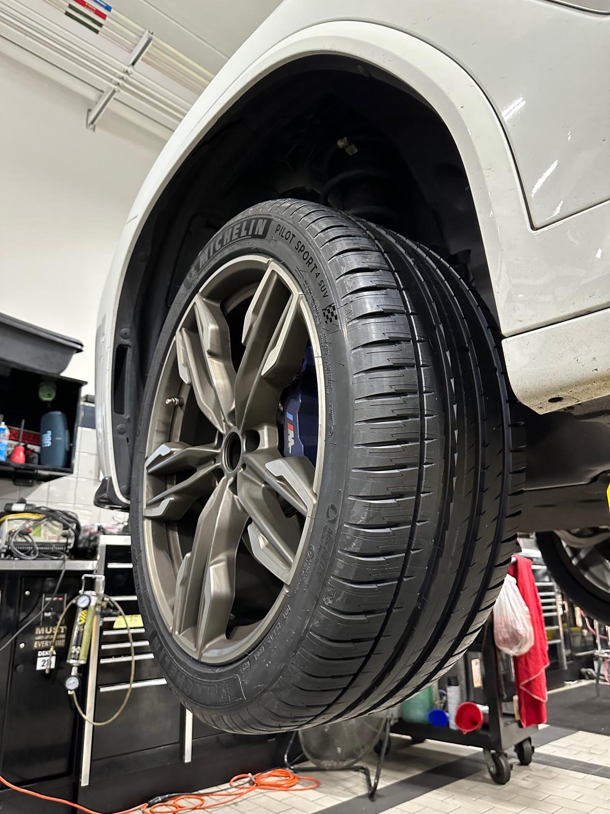

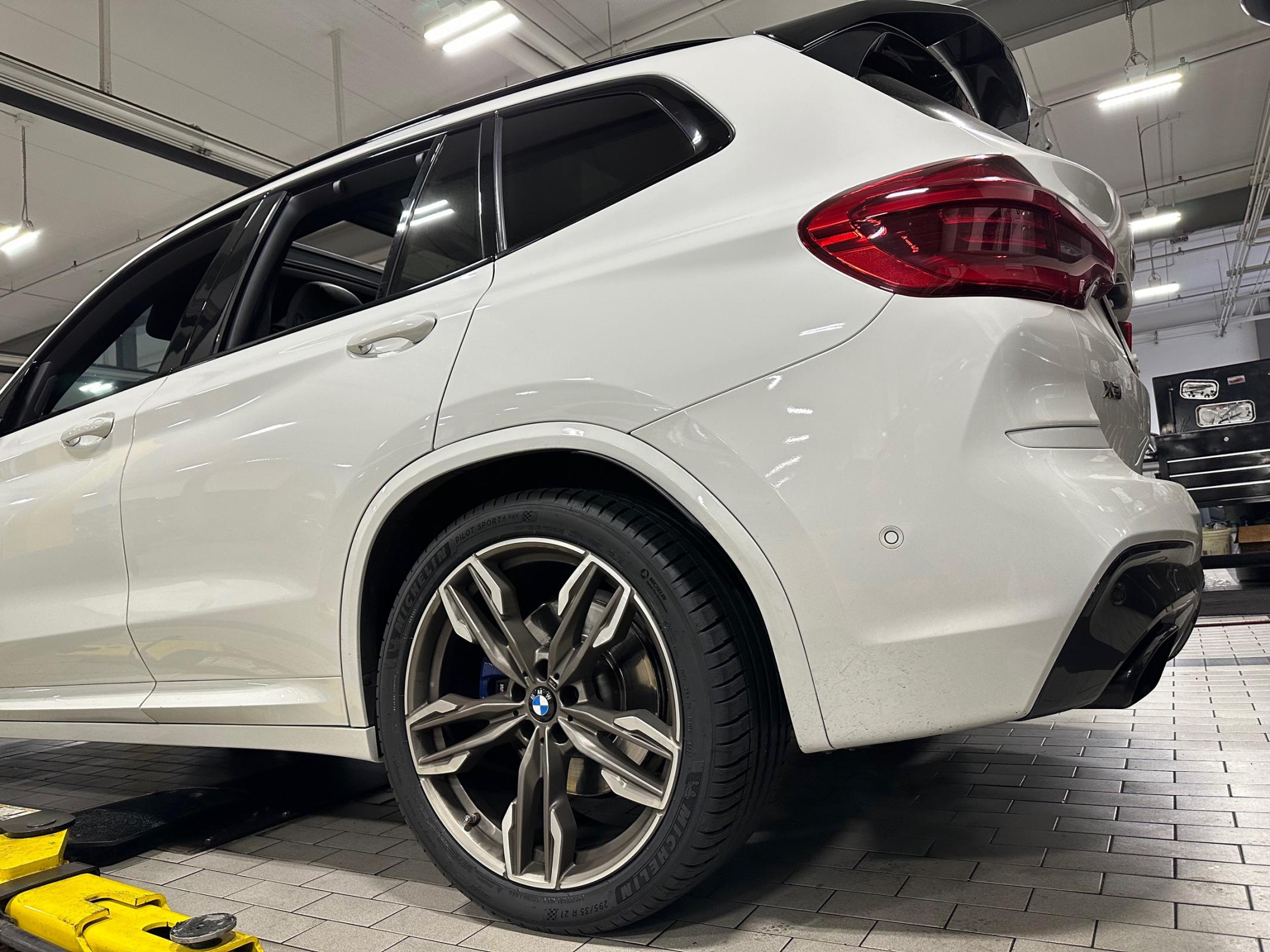

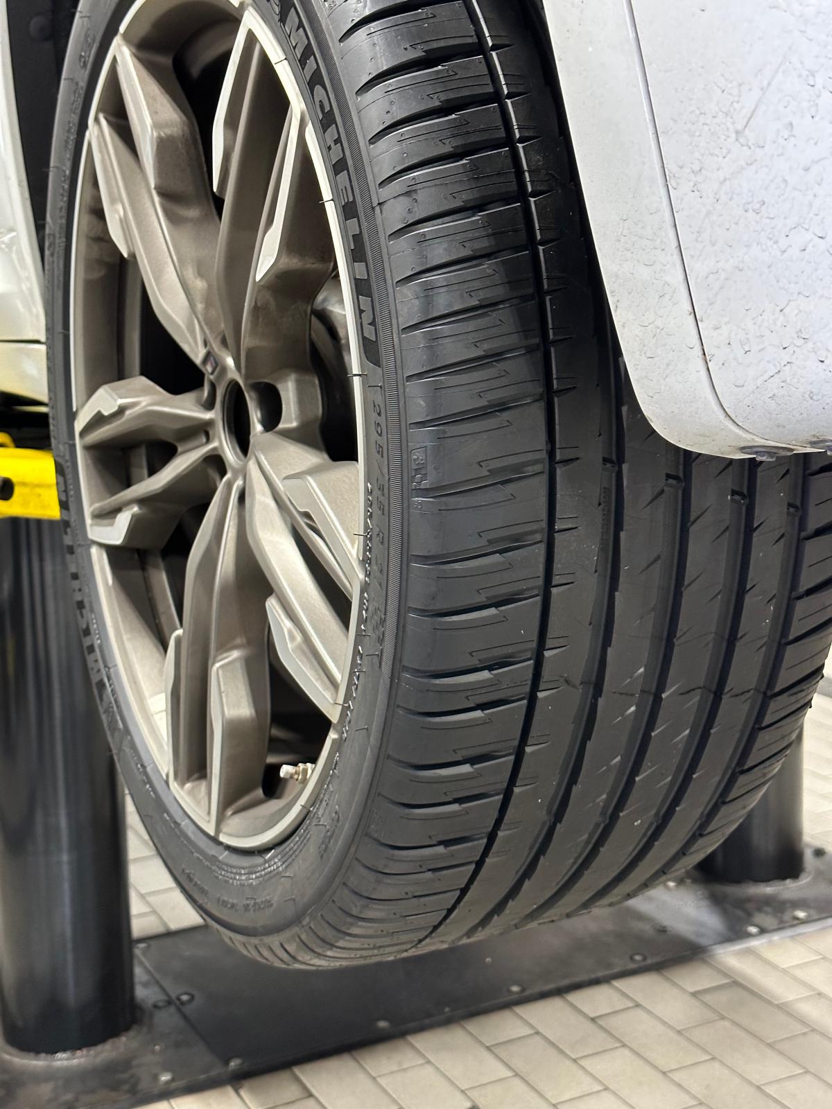

Anyone have any real world experience with these yet. Just switched to MPS 4SUV from worn MPS4S. Same size as the MPS4S at 255/40R21 and 295/35R21. Obviously comparison of a worn and a new tire isn’t always absolutely accurate.
Tires seem soft. They go over the highway dots and smaller bumps like driveway gutters softer and less crashy. Don’t know 100% if this is exactly how the MPS4S felt brand new as well. Haven’t really ran them in yet as it’s only been a few days. Hoping they last a long while like the MPS4S. Got about 25k miles out of that set. They wore down way better and lasted much longer than the factory Alenzas. Fronts were wearing on outer edge and rears still had 3mm.
Also did an alignment. And for anyone asking about yearly or every other year alignments, just because you don’t hit anything or your car doesn’t ‘pull’ doesn’t mean your alignment angles aren’t out and you can’t benefit from an alignment.

255 width tyre on 8” wide wheel and 295 tyre on 9.5” wide wheel ?
As you can see.

That’s awesome that those sizes fit on the OEM rims with no issues.
I’ve been pulling my hair out over the last few days trying to find an all season tyre in the OEM sizes for 21” rims in the UK and they don’t exist matched front and rear.
I can get Michelin Cross Climate 3 in the 255/40/21 & 295/35/21 sizes and tire.com shows those sizes as working.
I wouldn’t have thought those sizes would have fitted on the 8” & 9.5” rims.
