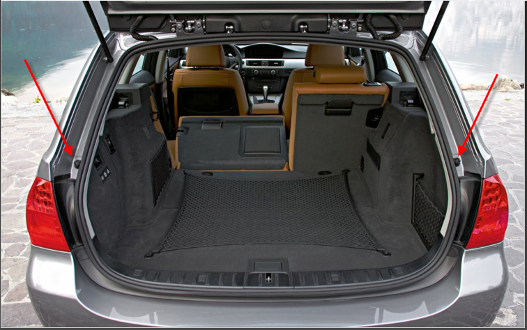

Yes, please see the red arrows in picture below that shows the black plastic stoppers that needed to be adjusted. Just give them a half turn (counter clockwise) and check to see if tailgate is more secure. Only a half turn has solved our tailgate rattle issues! :dance:
*Note: the picture is not of my X3, but the same parts are on the X3.
I hope this helps for your tailgate rattle issue as it helped me!
