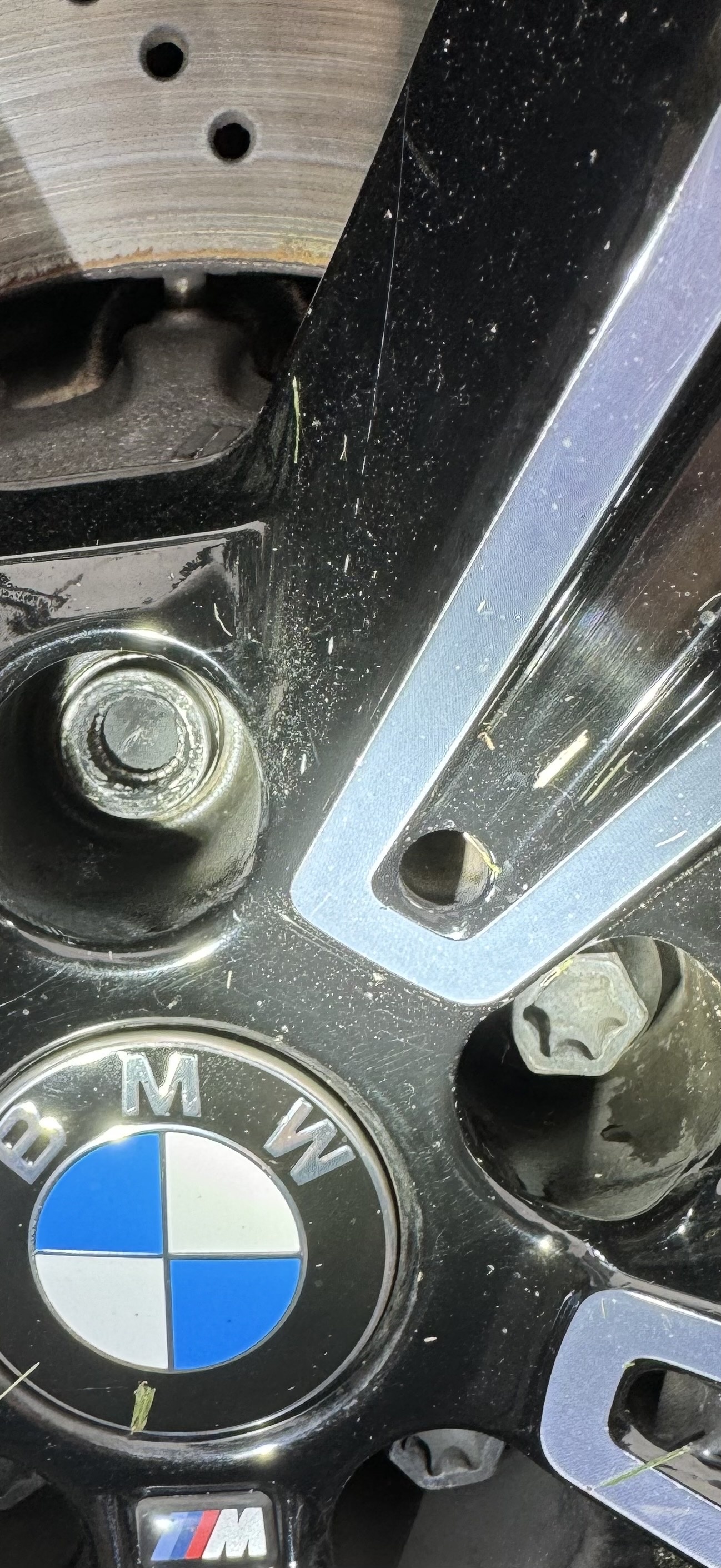

I recently had my vehicle's wheels balanced, and the shop over tightened the wheel locks upon reinstallation. I've taken it to BMW twice. The first time, they broke my keys and their master key trying to remove them. The second attempt resulted in them giving up after over four hours. They suggested cutting the wheels... which seems sorta ridiculous especially because the wheels on my X3M are pretty expensive. Do you guys have any alternative solutions or recommendations I could try? Thank you.

the spline locks, updated from the flower style, is pretty robust. take it to a decent established tire shop, im confident they will be able to remove it.

Every decent shop should be able to solve this. Never heard of cutting wheels. One should cut the nut if needed, but you can get replacement security nut adapter at any bmw shop

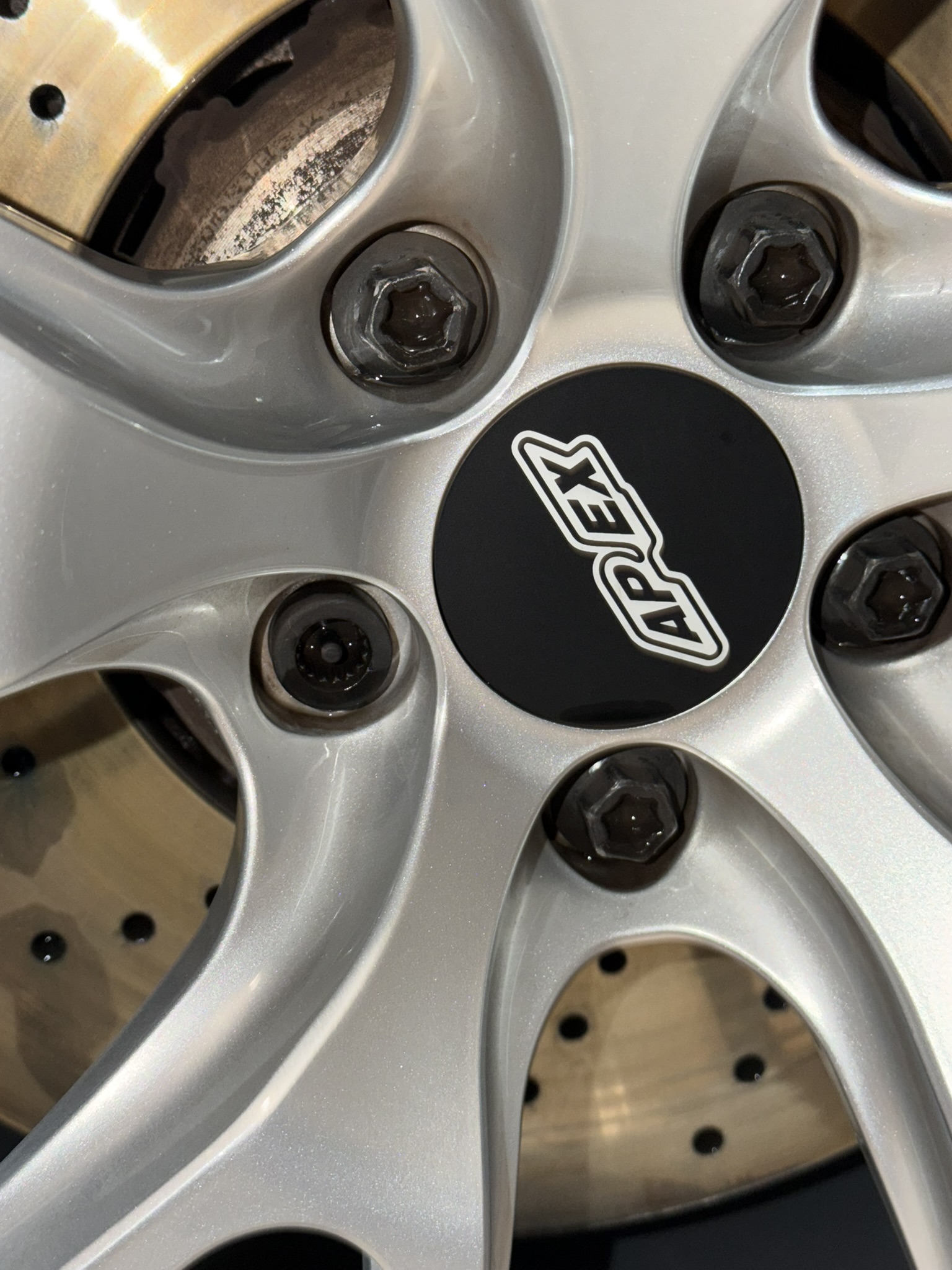

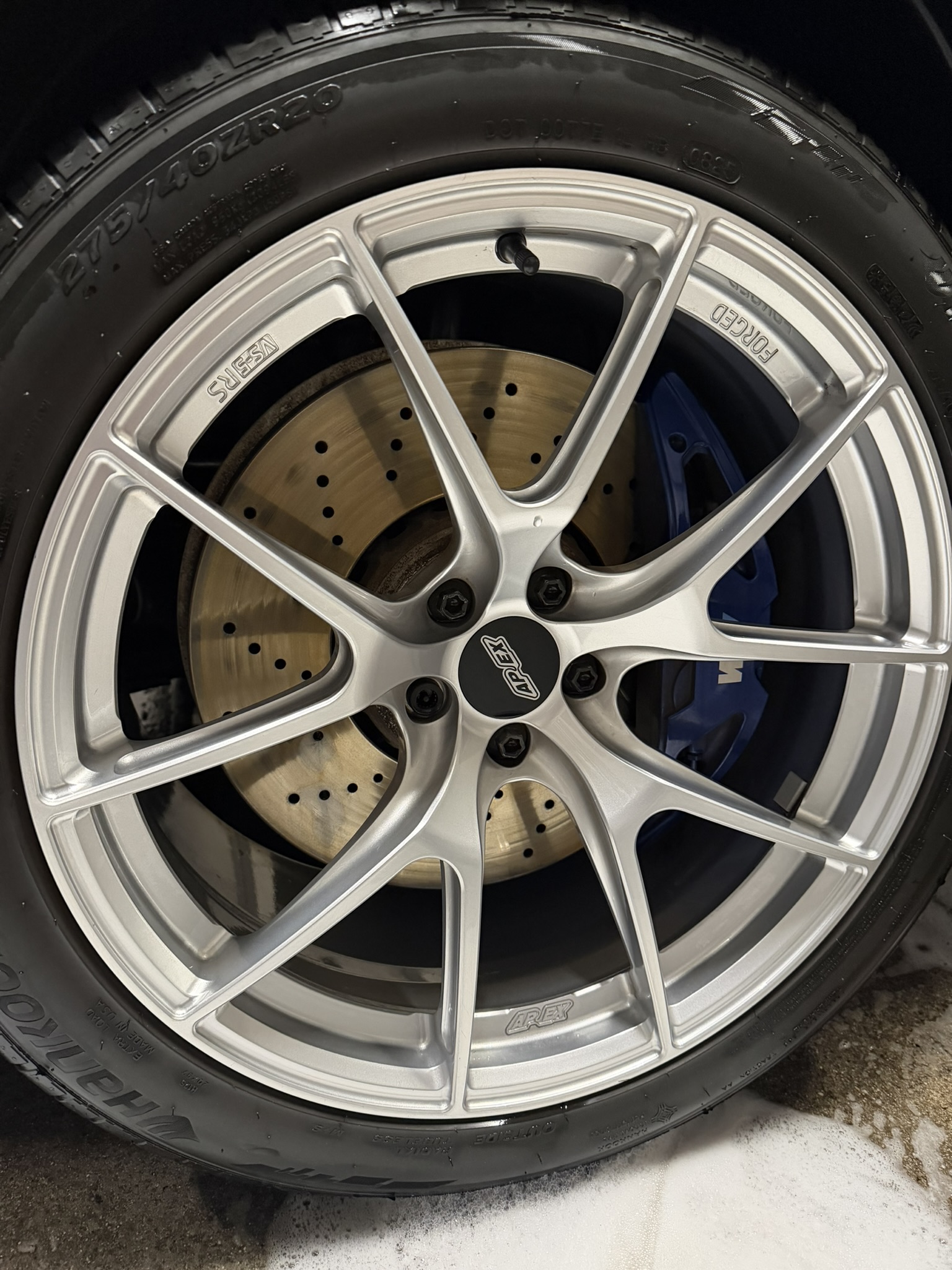

They're really nice! Fronts are 20x9.5 ET +20 and rears are 20x11 ET +30. I plan on getting BBS FI-R Evo's or 826m style next. Haven't quite decided yet but before that... I have to get these locking lugs off :thumbdown

I had the same issue one time . I stuck a ratchet on the lug and then got the handle off my big jack . That gave me about 4 feet of leverage . Stuck that over the ratchet handle and just pulled down with all my might . Pretty crazy how my impact couldn't get it done but my skinny a55 could loosen them .
You will then have to check the threads to make sure they aren't stripped as the over tightening could cause that . If they are stripped , pretty sure your dealer could fix them or you might have to buy a new hub but they aren't too expensive .
I have FI-R Evo's on order....

Specs f21x10 et22 r21x10.5 et26
No pics yet... Soon however

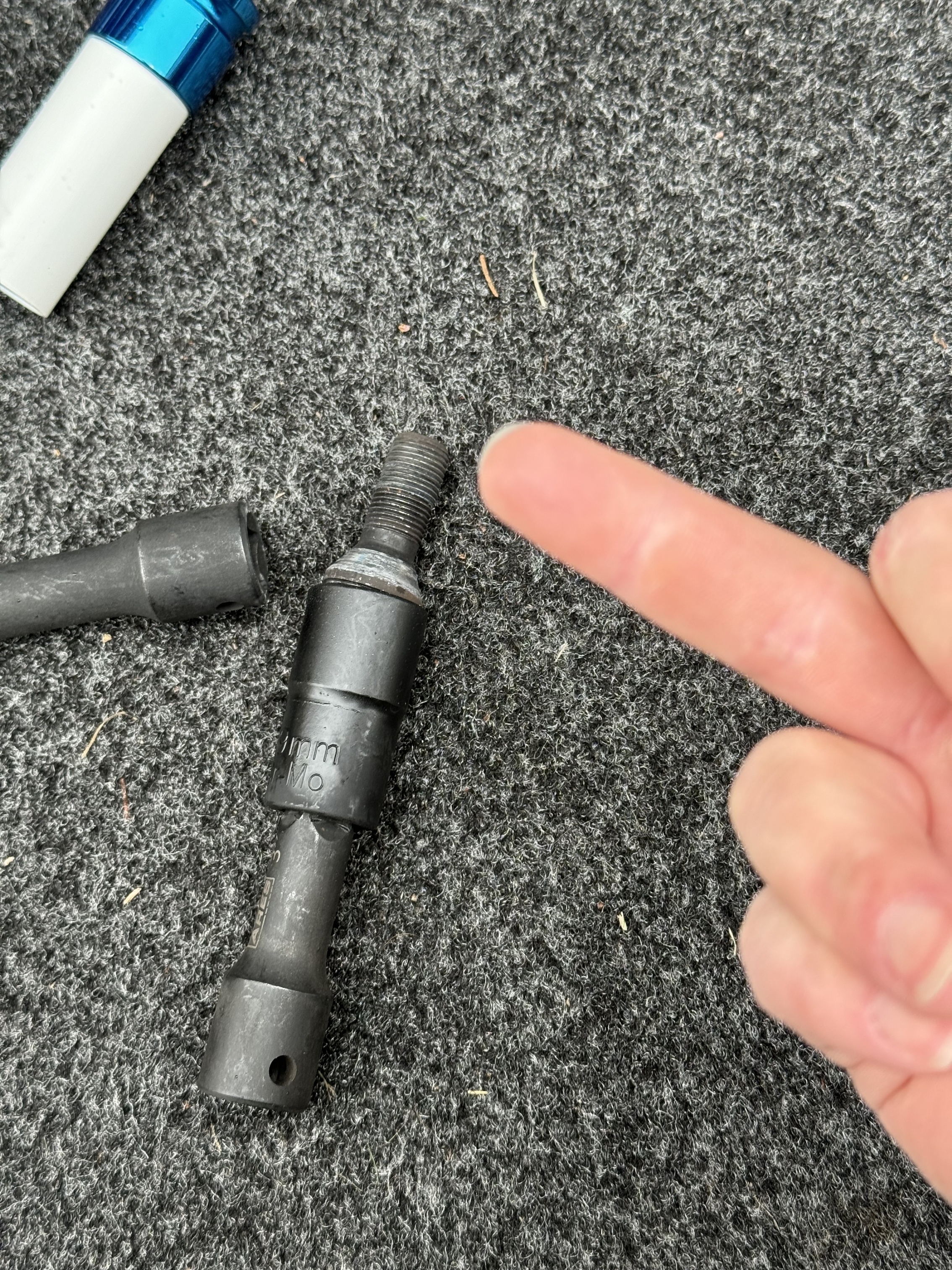

I broke 3 BMW keys trying to get one off. Finally I was able to hammer(sledge) a 12point socket onto the locking lug bolt to remove "key" section of the lug bolt. Then I was able to use a locking lug nut removal socket on the remaining round part of the lug bolt. Not a fun experience.
3rd picture is priceless :laughabov
I bet I reenact this every time I'm working on my vehicles .
