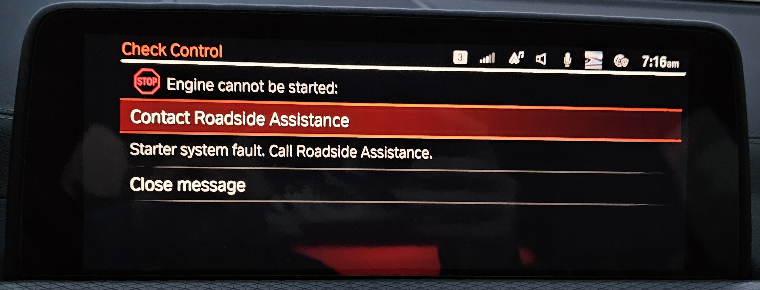

I got this message this AM when going to work. My car didn't even try to start at first, but did after a 3rd push. My battery is only a few months old, I just as the replaced it (and coded it in) Novemberish.
Anyone seen this before? I won't have my code scanner until I get home.

I had the same message on my '21 for two weeks until I could get it into the shop (36k miles). The car would fail to do anything when I tried to start it, I would wait about 10 seconds and try again, and it would start normally. The starter was replaced under warranty, part number 12-41-8-671-505. Codes were cleared and all is well.
added:
The starter failed while on the original, fully charged battery. I coded sport mode at startup in the first 5,000 miles and never used A.S.S.

I used my Autel to scan the car, 2 related codes. Looks like I'll be calling BMW in ze morning to schedule a drop off while it is still under warranty! I had just driven it twice over the weekend, each trip was 45 minutes mostly highway each way.
DTC - 216119
Intermittent
Line Disconnection, starter motor actuation (50L/B+)
DTC - 804095
Intermittent
Engine start fault during starter operation: current overload of driver KL50L

Likely not applicable in your scenario but I had this happen on a 2019 X3M40i with codes 80495 and 80442A. Dealer replaced the starter as per TSB for start failure in below freezing temperatures in case anyone experiences this with an 18/19 in the future. The Bosch starter was replaced with one made by Denso.

Service completed - My starter was replaced under new car warranty! Theres $600-$750 in parts alone I didn't have to spend on Part 12-41-8-671-505.
