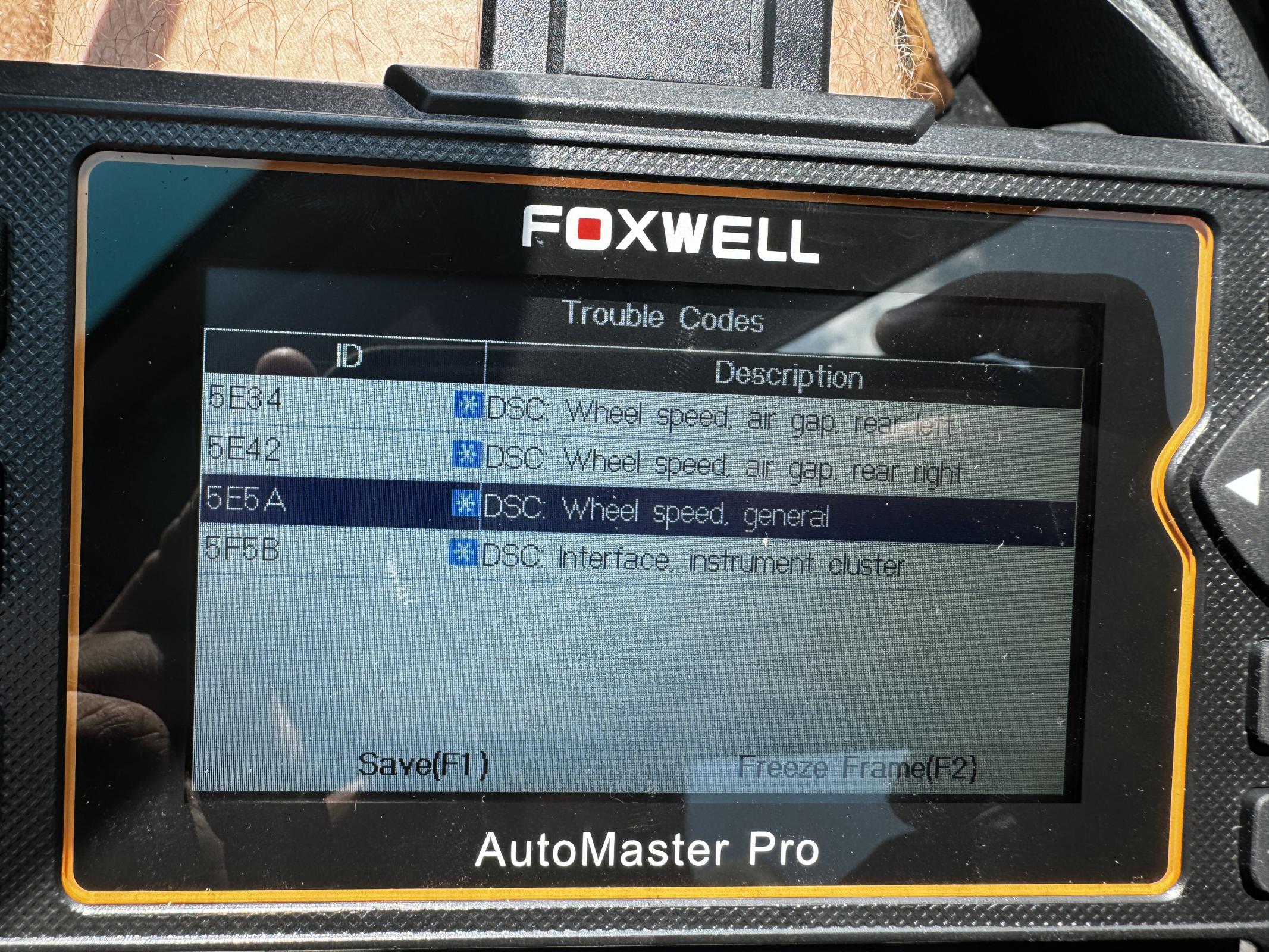

Attempted a few more trials this weekend. Added washers drove the car. Removed washers drove the car. And got similar results in fluctuating speeds. I’m sure the regulator rings are warped and need to be replaced. I’ve got some new codes this weekend as well. I’ll attempt to attach them here although not sure if I’ll do it correctly. Not sure if it’ll be worth it to just replace the entire axle with the already installed regulator rings or just replace rings. I got this car on a trade from a VW so I’m not trying to spend tons of money on a car with over 220,000 miles. Just trying to get it road ready but still safe at the same time. I’m almost tempted to just drive the car as is. It brakes great and doesn’t give many issues while driving. 👍🏼

Strange that you got also front speed sensor failures, did you reset all failures after you did various tests and then test drive again to see final failures? If you don’t fix it you will have issues with 4 wheel drive and more critical with the abs, assuming you have the known three lights on. You can disable the vtg with the fuse, but the lights / missing functions will stay…. I would replace the rings only, because fairly cheap but you will have to remove all rust, if the rings are too loose you will have to glue them tight, remember the correct location…. ( sensor needs to be in centre of the ring) If you observe that the joints are already worn out (play) you better exchange the whole drive shaft… the rear left side is more difficult due to exhaust and stabilisators, not much space, but doable. i bought the little stabilisators and flexed the old one out (too much rust, could not open properly) …. Cheers Ralph
