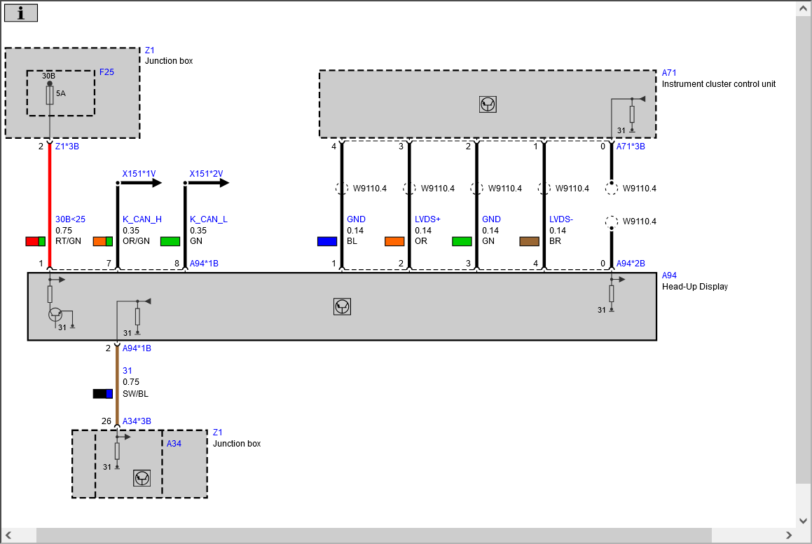

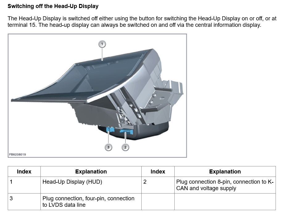

Here's some info about the HUD:
A94 = HUD
A94 = HUD

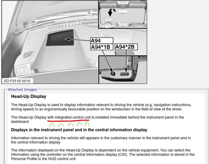

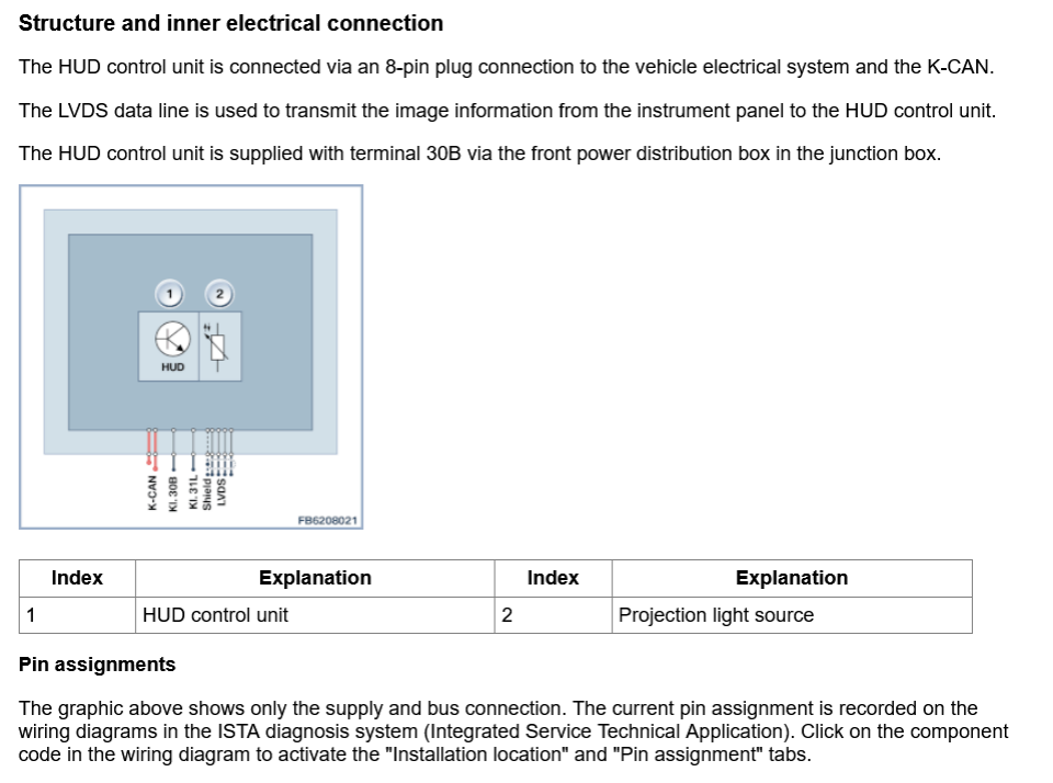

Yep…the “control unit” for the HUD is integrated into the HUD unit behind the instrument cluster…which is verified by the HUD info below (and above).
Has the OP checked the fuse (F25) and the electrical connections to make sure every electrical connection is seated properly and that the fuse is intact?
