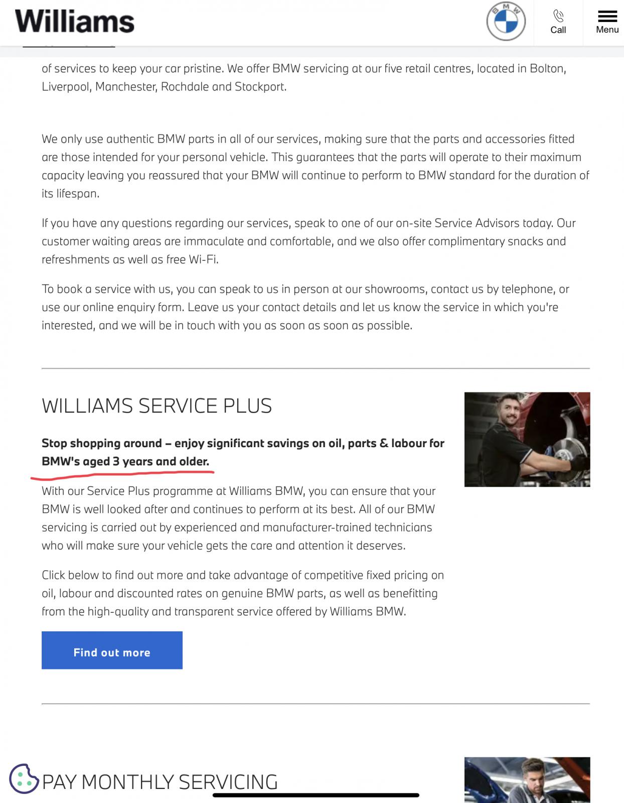

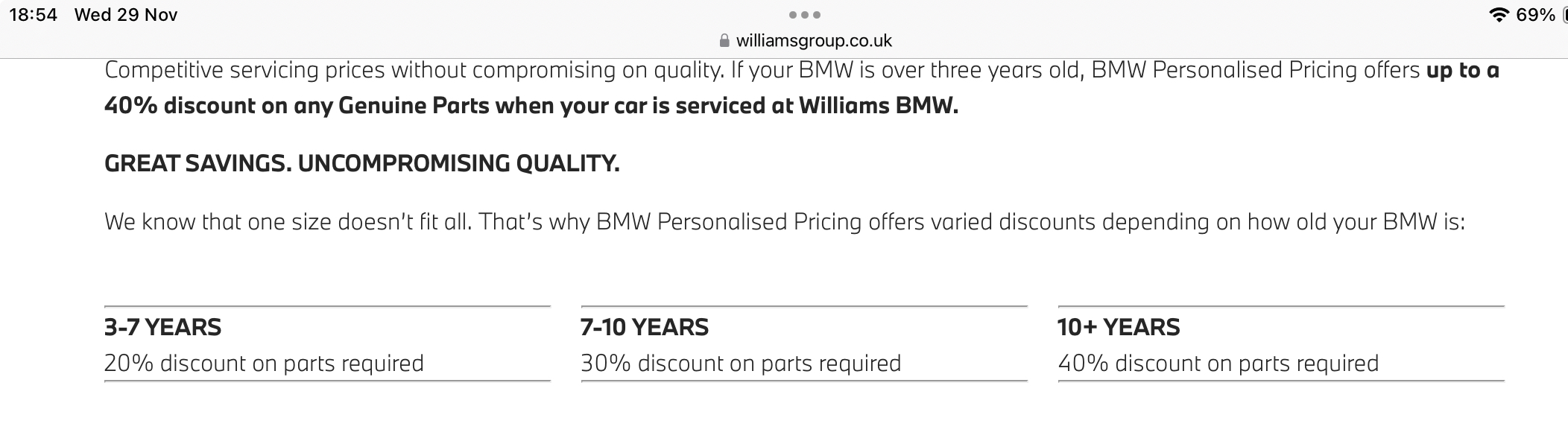

I know my local dealership does different pricing for 3 year old plus cars, it’s called service plus.
Based on that above pricing, it’s almost £200 more than the service plan pricing.

Just shows that they are milking you if you have a newer car. What's the age of your car got to do with a discount on the price of parts? They aren't doing it out of the good of their heart.

It’s an LCI so still we’ll under 3 years.
