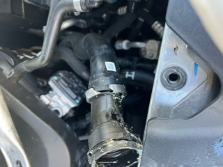

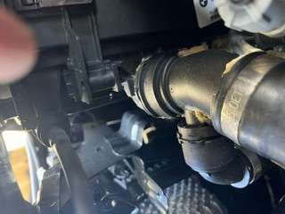

On my 2019 30i, there is a leak on the radiator connector (the y-shaped one). I cleaned it yesterday, and this morning found some residue on the connector where the 2 lines split out from the connector. Looks like something cracked on the plastic, and now it is slowly leaking. Slowly leaking, as I topped the coolant off about a month ago, and that was the first time I topped it off since getting it in 2019. Could be getting bigger, but will see. My question is, can I do this myself? Do I need to empty the coolant, or is it easy enough to remove the hoses, disconnect the y shaped connector from the radiator, install a new one, and top it off. This seems to be a common issue, anyone hear if BMW is going to do anything about it?
You can see the coolant residue (the white stuff) forming where the lines split.

Its the one circled below. I guess my question is though, instead of having to replace the hthe entire assembly (hoses, and connector) is it possible to disconnect the hoses from the connector, then remove/replace the connector from the radiator, then re-attach the hoses? That way I wont have to mess with trying to replace the hoses too, that would make this job alot easier wouldn't it?

x3Prancer wroteNo. I don't think they even sell the connector without the hoses attached. It's actually really easy to replace the connectors with the hoses attached. You just need a pick to release the connector.Its the one circled below. I guess my question is though, instead of having to replace the hthe entire assembly (hoses, and connector) is it possible to disconnect the hoses from the connector, then remove/replace the connector from the radiator, then re-attach the hoses? That way I wont have to mess with trying to replace the hoses too, that would make this job alot easier wouldn't it?

x3Prancer wroteI agree completely that the problem is the molded plastic fitting - the sharp angle created where the small hose is T'eed off should have been designed with more support/webbing to help prevent this part from cracking.Its the one circled below. I guess my question is though, instead of having to replace the hthe entire assembly (hoses, and connector) is it possible to disconnect the hoses from the connector, then remove/replace the connector from the radiator, then re-attach the hoses? That way I wont have to mess with trying to replace the hoses too, that would make this job a lot easier wouldn't it?

While creative, your proposed solution to replace just the plastic fitting is likely more work than just replacing the entire hose. As has been stated, you can't buy just the fitting so would need to buy a new hose assembly then cut off and discard the new hose to get you just the plastic part that is leaking. Removing the metal band clamp from your existing hose could be done but would require care in order to not damage the rubber.
I recently replaced the hose assembly (along with replacing the plastic connector pipe that mates to the cylinder block) and it's doable by the average home mechanic. The connector pipe replacement is not at all necessary (unless it's also leaking) and omitting this step would make the job much easier.

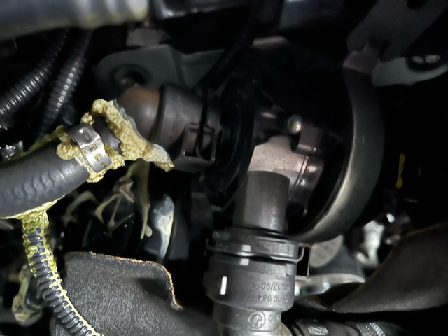

Hi everyone - had a coolant issue myself just recently. Had a really slow leak. Went searching through the engine bay and found no evidence of a leak. Read around and decided to try the expansion cap.
No luck. Still a slow leak. Then (see first picture) I discovered white crust under the forward tube on the expansion tank. During a pressure test this bit would even leak if I jiggled it. This also made sense since it would only be gasses escaping here - so slow and no evidence. Must have found it! Replaced the front tube.
Did a pressure test and no luck - still losing pressure. Not sure, I left the car sit overnight. Came back the next morning to try a pressure test again and when I pressurized it I heard a slow drip. I went investigating and was able to trace down the turbo coolant hoses where they enter the turbo. It was the top hose. See second picture.
This all made sense now - The system only leaks when it has pressure. It only has pressure when it is hot, and the turbo is hot. So any leaking coolant would get vaporized instantly and leave very little evidence.
I pulled the tube and replaced the O-rings for $6 each. Here's the scary thing though - the o-rings are only 14 months and 14k miles old! They were in a very compressed flat shape. The new o-rings were 1.5mm thick and the ones I pulled out were compressed down to 1.25mm. So I'm a bit confused here why they would go bad so fast - Maybe a fluke or maybe there's some issue with the o-rings. See the last picture for a visual of old (barely) vs new oring.

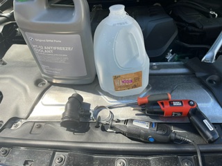

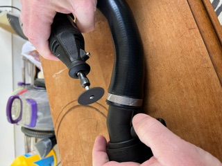

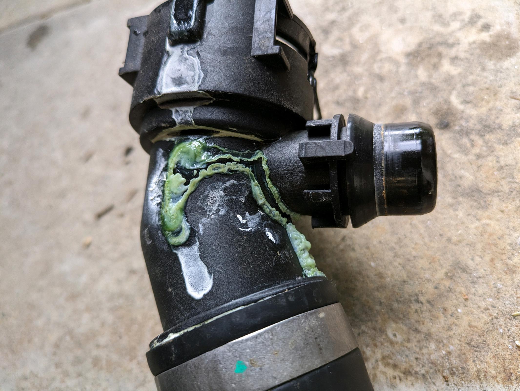

So, as seen from my previous post in the thread, the upper radiator hose connector had a leak in the area where the auxiliary host connects to it. The auxilliary hose leads to the heater core. This seems to be a common failure point. There were no other leaks that I could find. Instead of replacing the entire coolant hose, I opted to replace only the plastic connector. In order to do this, I had to purchase the entire hose, and cut off the clamp, and remove the hose from the connector. When I started to remove the auxilliary hose from the side of the main upper radiator hose connector, I couldn't. It was fused so badly I couldnt get them separated. It ended upbreaking off. Once I got the side piece off, I removed the main connector from the radiator, which wasn't so bad, just required some gentle tugging. After the connector was separated, i cut the clamp off of the main upper radiator hose, and separated the hose from the connector. Then I put the new connector in (I put a little vaseline to make it go in easier), then connected the uper radiator hose and the auxilliary hose to the connector using Koehler screw clamps. To access that area a little better, I removed the screw nearest the front of the car from the silver crash brace, and pushed that off to the side.
I had very little coolant loss. Maybe 1/2 - 3/4 of a jug, most of which was loss of coolant due to the leak from before. The resevoir was filled 3/4 of the way, and Im monioring it for a few days if it needs to get topped off.
Also one important thing I realized. Because the auxilliary hose got fused to the upper hose connector, I would have had to replace BOTH hoses completely, that would have made this job considerably more work if I replace the entire the hoses instead of just the connectors.
So far so good, the job took me in total about an hour.
Here are the parts I needed to buy:
Radiator Hoses:
64-21-9-354-459 (heater core hose for 2019 X3 sDrive)
17-12-7-535-529 (upper radiator hose for 2019 X3 sDrive)
Clamps:
Koehler Enterprises Hose Clamps, Hose Clamp Box of 10, Radiator Hose Clamp, Silver, Size SAE 20
Koehler Enterprises Hose Clamps, Hose Clamp Box of 10, Radiator Hose Clamp, Silver, Size SAE 28
BMW Coolant
Distilled water
You will need a dremel to cut the existing clamps off, a screwdriver, and pliers
Here are some pics.

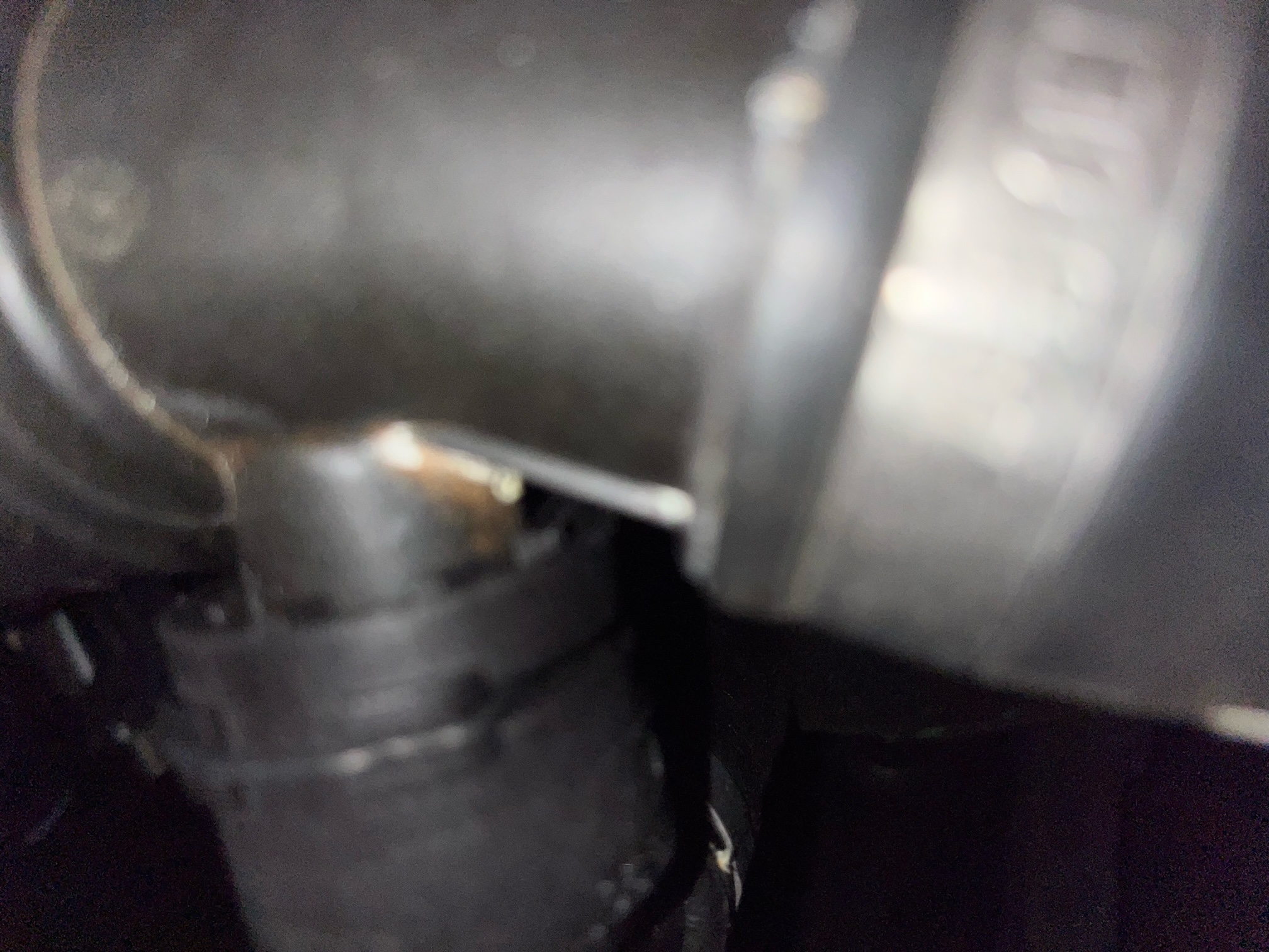

Can you guys help me to figure out if I have a leaking hose or it’s my radiator? I found my leak just now… it looked wet near the lower hose where it connects to the radiator.

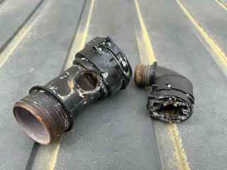

I'm pleased to announce that I had the classic drivers side upper radiator crack, same as everyone here. Replacement part is on the way.
Ill be fixing it myself, using the method
mct128i used. Wish me luck!
pej7445
mct128i
+1
06-14-2024
06-14-2024
abbike18 wroteGood luck with the repair, let us know how it goes!I'm pleased to announce that I had the classic drivers side upper radiator crack, same as everyone here. Replacement part is on the way.
Ill be fixing it myself, using the methodmct128i used. Wish me luck!
abbike18
06-15-2024
06-15-2024
pej7445 wroteOk, not bad at all! A few notes:Good luck with the repair, let us know how it goes!
1.) I didn't drain the coolant, just let it spill when I unhooked the pipe, and then rinsed things down heavily once I got the new pipe in. This seemed fine.
2.) my DME cables had colored marking on them already...just take a picture!
3.) the DME connectors can fool you that they are connected. Pull up on them to make sure
4.) it's def tight under the manifold, but totally doable without removing the intake. Althought
5.) the hardest part is removing and reinstalling the header side. On the removal, the clip came off and went down the engine bay. I would say just remove the clip with your hand instead of leaving it in the 'unlocked' position. To get the old tube off and new tube on, rocking back and forth is key.
All in, took me an hour start to finish. Really not bad at all.
Picture of the old hose attached for fun.
