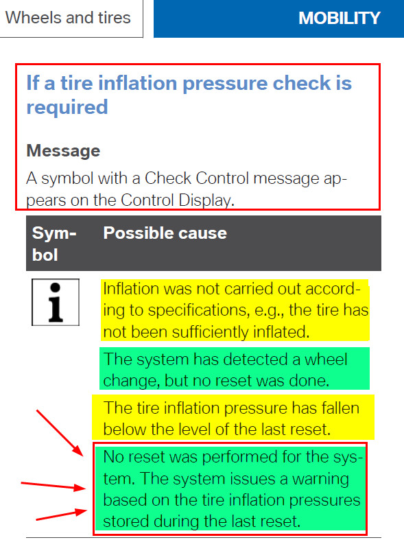

Gritty wrote
I'm currently having a similar issue. Had a screw in a rear tire, pressure dropped to 29. Fixed the leak and set tire pressure at 37 rears 35 fronts (idrive confrims same). Still having the warning error message days later?
You didn't write if you RESET/REINITIALIZED the system after you put more air in the tires.
You HAVE to reset if you add/remove air...or swap/change a wheel/tire. If you don't, the system is still using the previous baseline that was set...which is why you can still get warnings after adding air and NOT resetting the system.
See info below from the owners manual which gives FOUR reasons why you may still be getting a warning...take note of the last one:
