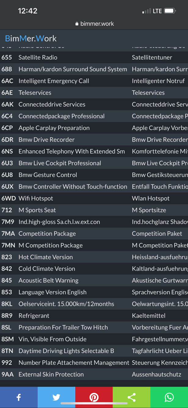

Thanks guys!
I did a little digging - the trailer hitch pre-wiring is option code S8SL - "Trailer Coupling Preparation". Any online vin decoder should tell you if the car has it. I ran the vins of two 2022s for sale locally and sure enough, both had the option. So, running the factory retrofit harness/module should be plug and play just like on my 2020.

My LCI Comp. is scheduled to be here this week and has the 8SL option code as part of the build. This was really important to me because I took the Stealth Hitch (with the adaptive wiring harness) off my M40i to install on the X3 M.

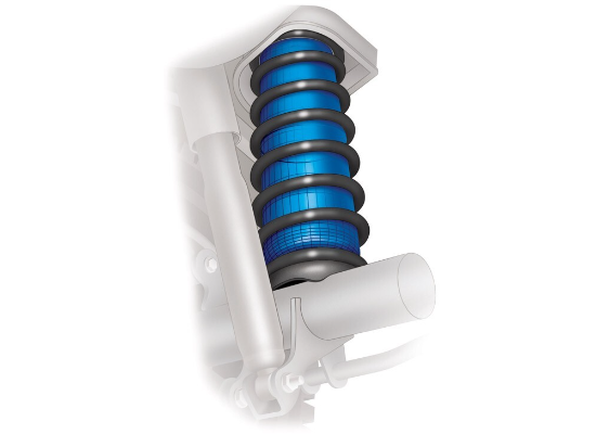

lagunablue1's user avatarlagunablue1 Great thread! I have only ever towed something once in my life (with my Armada) which has a rear air suspension (auto leveling).
For owners who do not have that option (or choose to remove it because it always fails and is overly complicated) they often get "coil helper bags" which are aftermarket air bags which fit in the coil spring and you manually inflate to get rid of the sag when towing.
Curious, would a setup like that work for the X3M to level it off?

spta97 wrote
This feels like "genius" advice I get at the Apple Store :laughabov
That's a great idea! I've heard about airbags before for leaf spring trucks, but I didn't know they made coil helper bags. It looks like firestone makes 15-20 version of the kit, so it would just be a matter of measuring the inner diameter and length of the springs.
Actually - something like that would definitely allow one to lower their X3M on springs or MSS and still be able to tow. Definitely something to do a bit more research on...
