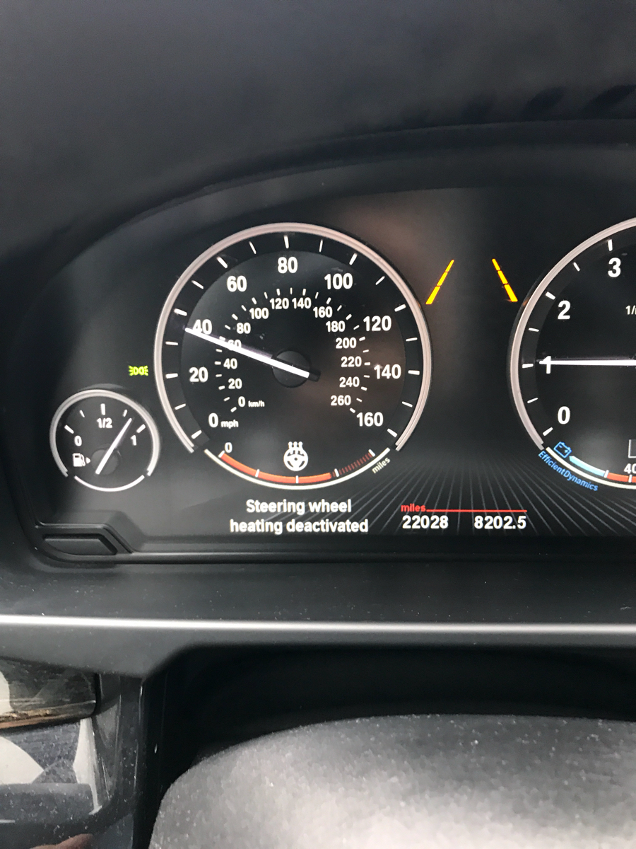

Is there an option to turn on a heated steering wheel on icon in the video display? I say this on a 335i rental recently.

Duke I wroteThere is a dash indicator. Not sure if you can code for icon on head unit.Is there an option to turn on a heated steering wheel on icon in the video display? I say this on a 335i rental recently.

Almaretto wroteDoes that mean you can display status on the dash...by default it only lights up the button when on and it's hard to see the button due to its location.There is a dash indicator. Not sure if you can code for icon on head unit.

ctdw wroteDoes that mean you can display status on the dash...by default it only lights up the button when on and it's hard to see the button due to its location.

I assume you mean this can be enabled? It does not display by default on the X4 M40i. I read in another forum that it didn't exist on the X4 dash so I assumed it was not even there to be programmed...that is good news if it can be.

ctdw wroteMy F015 has cold weather package, but not my F010. The picture is from an X5. Although the F010, F015, & F025 all use same instrument cluster (KOMBI, CAFD_00000069), the coding to enable is in another F015 ECU module not found in your car. I can look for the setting, but I assume it would have been enabled from factory on your '17 F026.I assume you mean this can be enabled? It does not display by default on the X4 M40i. I read in another forum that it didn't exist on the X4 dash so I assumed it was not even there to be programmed...that is good news if it can be.
EDIT: Do you happen to have link for other forum thread?

I have cold weather package as well. I have seen other forum postings complaining about the fact the X4/X3 does not have a visual display on the dash for the heated wheel and mine definitely does not show anything. If you discover it's there and can be enabled, that would be good news. Here are just a couple links I found...
