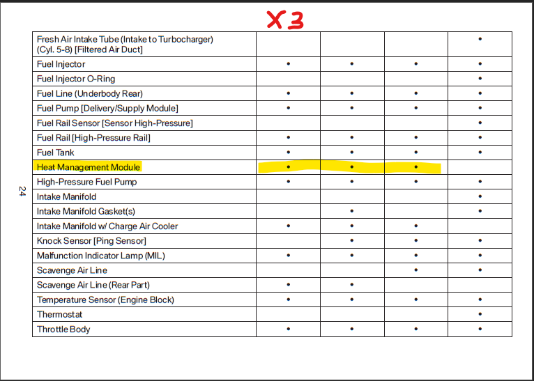

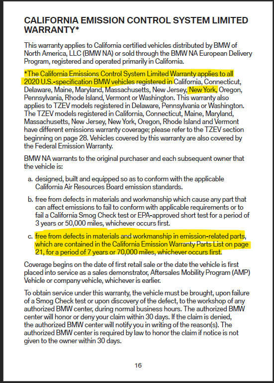

I did some digging into the issue and found that the failed component is covered under an extended California emission component warranty. The coverage extends to vehicles sold in New York.
The split cooling valve is part of the Heat Management Module and is clearly listed under covered items. I already scheduled an appointment with BMW for diagnosis/repair, and the vehicle is 2K miles past the new vehicle warranty expiration. Hopefully they don't give any push back.
Attachment 3234735
Attachment 3234736
Yea it should be covered under the emission warranty. Hopefully they don't give you much trouble lol

Dealer looked up the VIN and unfortunately there is no 7-70 warranty on the X3. Seems a bit odd. Why would the manual that came with the car state something that isn't so.
That's total BS. Either go to another dealer or complaint with BMWNA.

I contacted BMW NA. They assured me that the X3 does indeed qualify for the 7-70 California emission warranty. Waiting to hear back from SA.

Just wanted to provide an update:
- I was quoted ~3k for repair costs
- Explained that this should be covered under the limited warranty, but initially received push back. After providing the warranty booklet with the important parts highlighted, things changed and car was covered under warranty.
Just FYI!!
