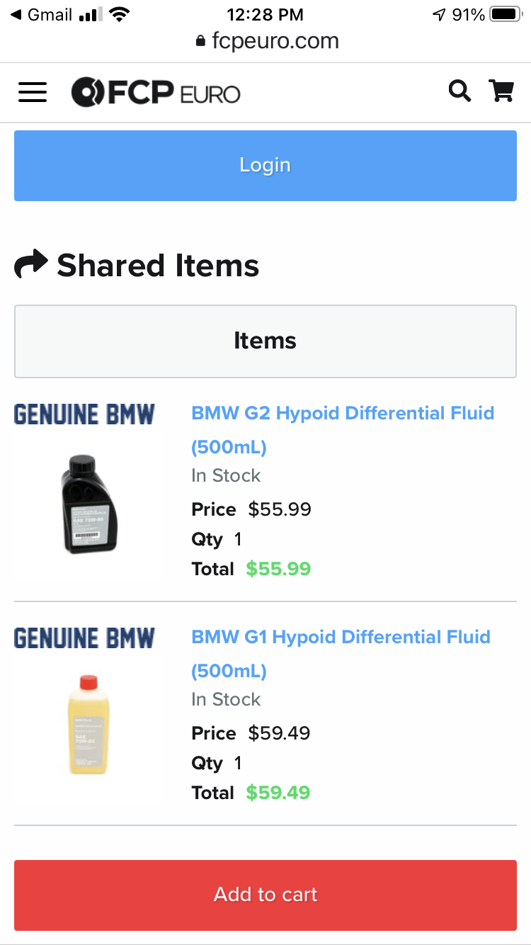

Just received this info based on my cars VIN - (2012 X3 N52 )….think I can do better on pricing with Redline, etc.?
