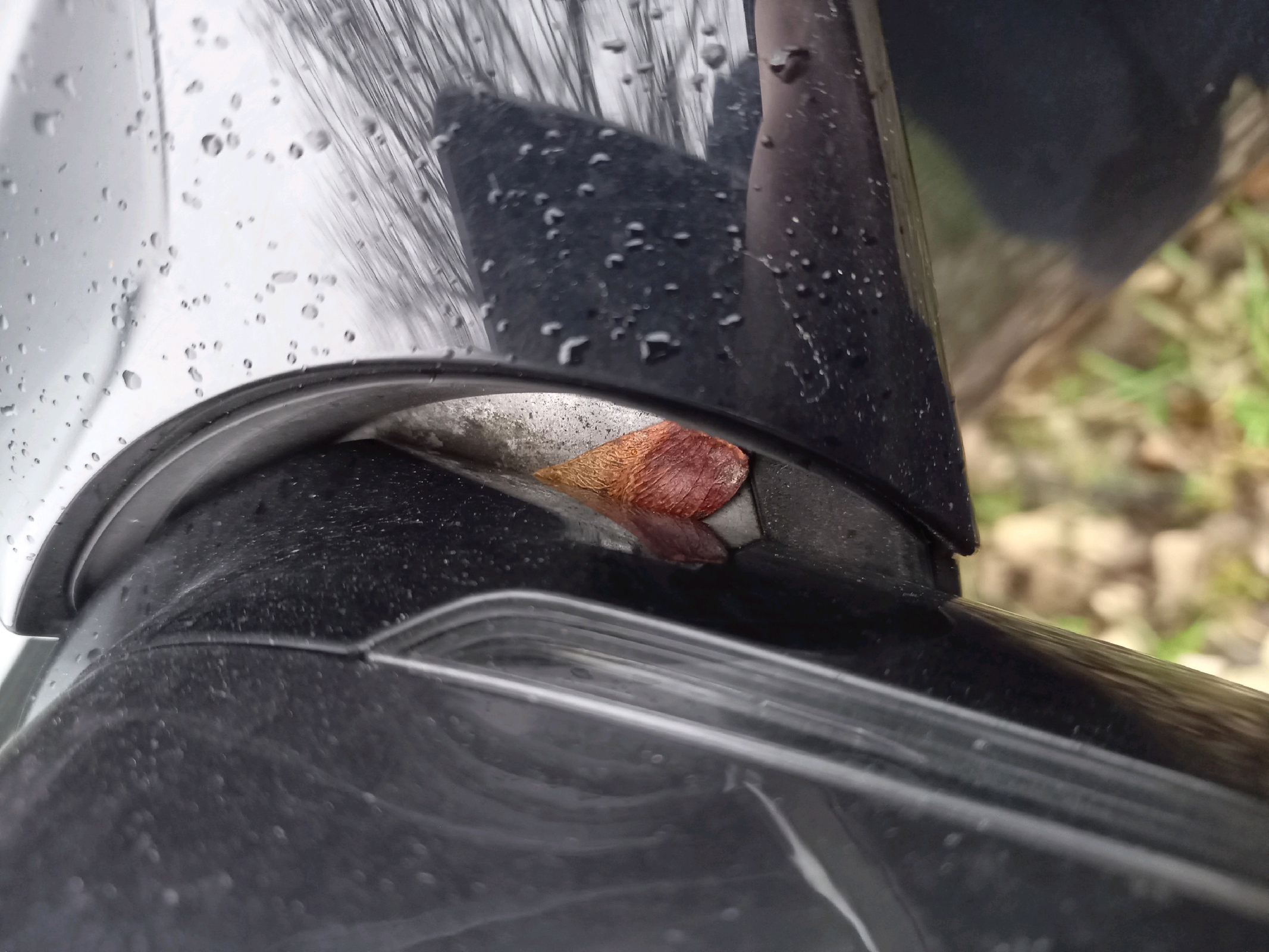

      12-08-2022, 04:45 AM   #6
titomi
titomi's Avatar
946
2,046
Drives: X3 G01 30i xDrive
Join Date: Feb 2018
Location: EU
2018 X3 G01  [0.00]
Reviving an old thread, as I started to have issues with passenger side mirror. I lock the car with the fob, mirror are folded, as they should. When I return after some time, and unlock, get in and start moving, I notice that the mirror is still folded. I stop and use the manual switch on the door to fold both in, a unfold again - in which case both mirrors unfold no problem. This happed maybe 4 times during last month.
I don't think that somebody is messing with the mirror, as it happened in different places. I think it started after I washed the car, the same way as usually - but really not sure. Maybe just a coincidence.
Any ideas? The car is MY18, so out of warranty for 2 months now unfortunately.

      12-22-2022, 02:58 PM   #11
titomi
titomi's Avatar
946
2,046
Join Date: Feb 2018
Location: EU
2018 X3 G01  [0.00]
Found the problem. Can't believe, that this was causing it. Removed it, and for the last 2 weeks had no problem
