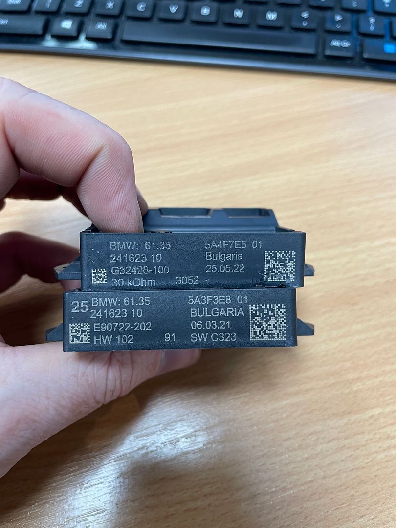

I have found some new information today regarding the 32x delete.
It would appear what looks like the module on my car is actually a termination resistor for the LIN Bus luckily I bought the required module some time back the attached documentation tells you the module needed. If you notice on the photo it says 30kOhm on the label this means it's NOT a module but a terminating resistor for the Lin Bus.
The antennas are fitted to the resistor even though they don't function there must be thoughts about retrofit!
Now it also appears some cars left the factory with the termination resistor fitted but without the 32x code! These cars just need the module swapping and should work without coding. I am going to swap mine to the functional module and see what happens but I'm not hopeful of it working without coding as there's no function in the idrive normally under tailgate section.

I swapped modules this evening. Didn’t get a chance to do the coding. Nothing works even after letting the car go to sleep. Pic of the two modules below. Interesting to note the difference between Neil’s module and mine. BMW must be using two different suppliers for the same part number.

Same part number Kevin just mine has a shitty sticker label lol

It works!
I made the following three changes listed by kalyke in the below thread:
https://www.******.com/threads/hands...te.4474/page-2
  • HU_MGU: Backdoor_SMO_INSTALLED nicht aktiv -> aktiv
  • BDC_BODY: VAM_SMART_OPENER nicht aktiv -> aktiv_HK
  • BDC_BODY: VAM_ENABLE_SMART_CLOSE nicht_aktiv -> aktiv
I just used Bimmercode. I made no changes to the VO, so this will be wiped if the car gets an update. I would be slow to change the VO on a new car in case it stops updates, as the VO in the car wont match the server.

Originally Posted by spangle1980 View Post
Sorry to keep being a dumb-ass - but for a frame of reference is that screw hole there that which the diffuser attached to?
Thus, did you remove the diffuser completely to see it? If so, at the extremeties of each side of the diffuser (behind the rear wheels) there is a some kind of push pin plug type thing (plastic) that I didn't want to mess with (you can pull it out so far but I didn't know if it's right to yank it out completely). Also, since I unscrewed the diffuser fixings (those which had a proper bolt I could unscrew) I didn't want to force the diffuser away from the bumper without knowing that's the correct thing to do for fear of breaking some clips :->
Again, apologies for being lame in this regard!
No mate
You don't have to remove the defuser just open it up between the bumper frame.
I've swapped my module tonight without taking the defuser off
      10-19-2022, 01:53 PM   #66
njw1967
njw1967's Avatar
England
691
740
Drives: BMW X3 M40
Join Date: Aug 2012
Location: Yorkshire
Mine is sorted and working
No VO code change see how it goes if it gets wiped with update I will just code it again 👍🏻
Thanks to everyone who has contributed
