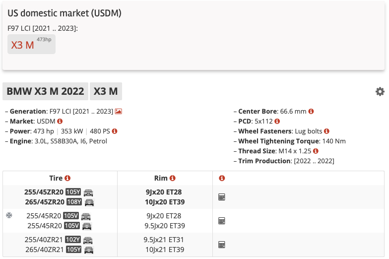

Why not square?
That is correct.
thanks for keeping me honest. We don't need "alternative facts" on this forum, or theories that aren't at least based on reality. Thanks for the chart.
I wonder why BMW even staggered the wheels by only .5 inch. Moreover, why they staggered the size of the tires from 255 to 265. Seems like they would have erred to 265 and 265, a completely square setup which avails rotation. these tires wear out so fast, it would give some longevity to the tires.

Originally Posted by Ice9 View Post
thanks for keeping me honest. We don't need "alternative facts" on this forum, or theories that aren't at least based on reality. Thanks for the chart...
For wheel spec: https://www.wheel-size.com/size/bmw/
For setup comparaison: https://www.willtheyfit.com
... Moreover, why they staggered the size of the tires from 255 to 265. Seems like they would have erred to 265 and 265, a completely square setup which avails rotation. these tires wear out so fast, it would give some longevity to the tires.
For the square set up they stick with the front tire with, 255 and 255, probably something to do with clearance especially in the winter.

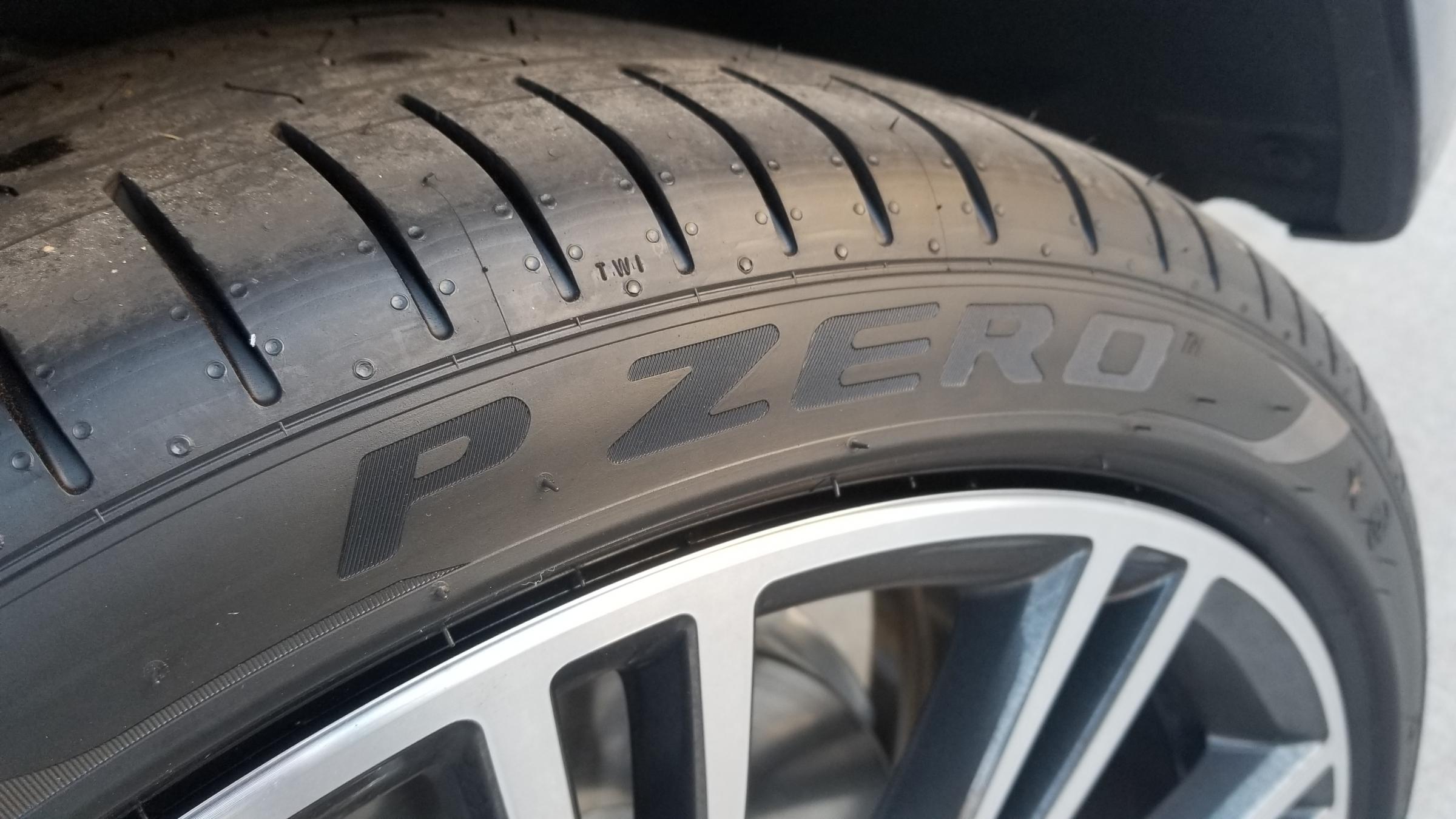

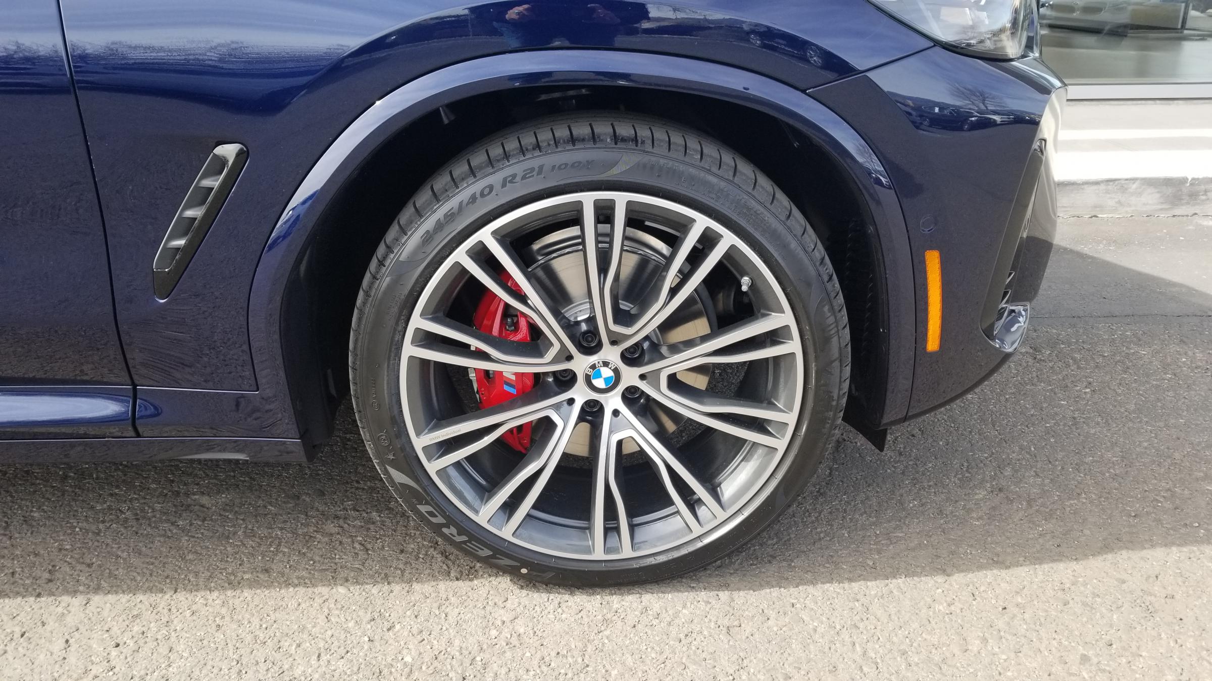

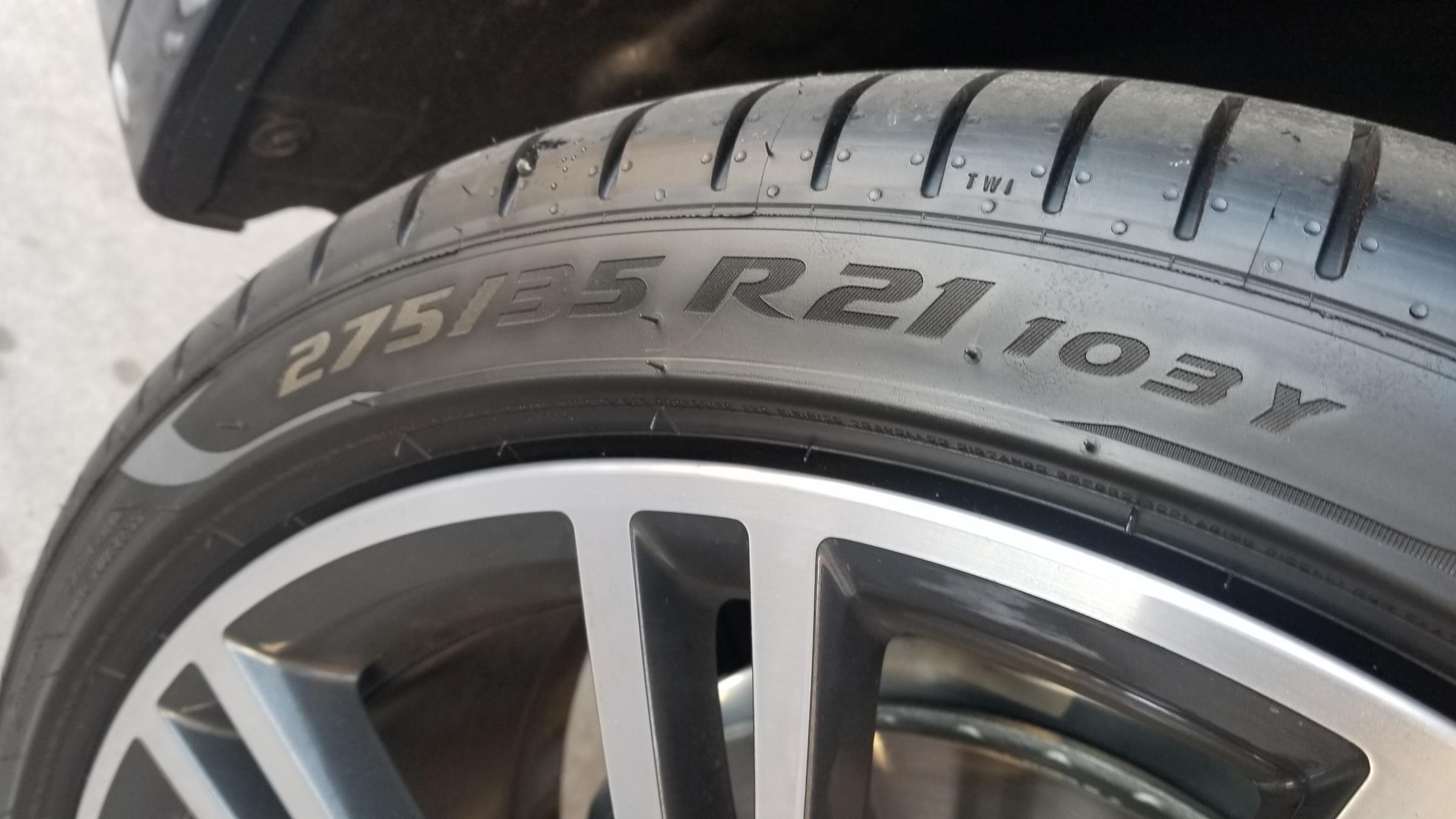

FS: New OE 21" Pirelli P Zero Run Flats $1000
Are you running 21" winter tires, and need some new summer tires for the upcoming months? If you are getting ready to drop $1900+ for some summer RFT's, here is a good deal:
My '22 M40i with 21" wheels was just delivered. Luckily, mounted with Pirelli P Zero (not Alenza's). I have driven them 50 miles, and frankly, they are way better, smoother and quieter than I expected. But, I need all season tires, so I am dismounting these while they are still new, and they are for sale. $1000, firm, you pay shipping (guess about $50 unboxed). At Tire Rack, they are $1904/set. If you want to stay with summer run flats, these are the best, they are new, and they are cheap. Located in Santa Fe, NM.
245/40/21
275/35/21
