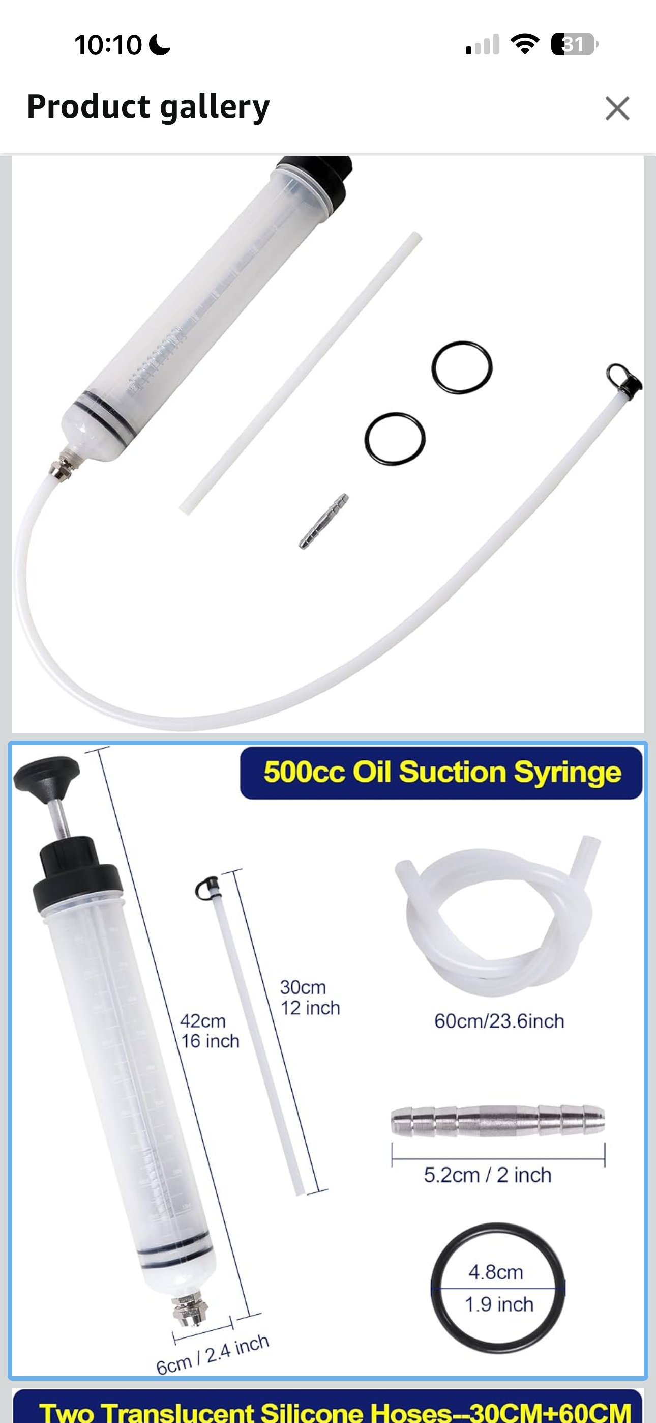

You dont even need to waste time removing the cross member. 14mm allen thats been removed from the socket and use a 14mm wrench. Or used the special tool you can get from amazon that’s pre assembled the same way. I flushed mine 3 times with triax dtf-1. Use the soft silicone hose so that you can snake it down through all those loopholes inside the case. The hard hose won’t work. Gets super easy each time I changed it.
My vehicle transfer case before the flush was pretty bad, like really bad. Felt like the the drivetrain was about to explode everytime I turn. Now its butter smooth.

Do you have a link to the hose. I have tried a variety of hoses but never felt like it was the right one for the TC job.
It is surprising how nasty that TC fluid gets.
'19 X3 M40 Carbon Black/Oyster, '21 X7 40i AW/Black, Past BMWs: '18 M550i, '18 330 GT, '16 X5 40e, '11 E90M3, '06 X5 4.4, '03 330i ZHP, '02 M3, '97 Z3 2.8, '96 Z3 2.8, '95 M3 (2x), '94 530i (manual), '92 525i (manual), '88 M3, '87 325iS
Its the one that was included with the manual pump that I bought. The one that is knotted up.
Can you put a link to the product? As you can imagine, there are many out there....this looks similar?
https://a.co/d/gVm7PPG

https://a.co/d/hkvvqjQ
You need to look for the opaque white silicone flex tube. Not the clear tube as they are pvc.
