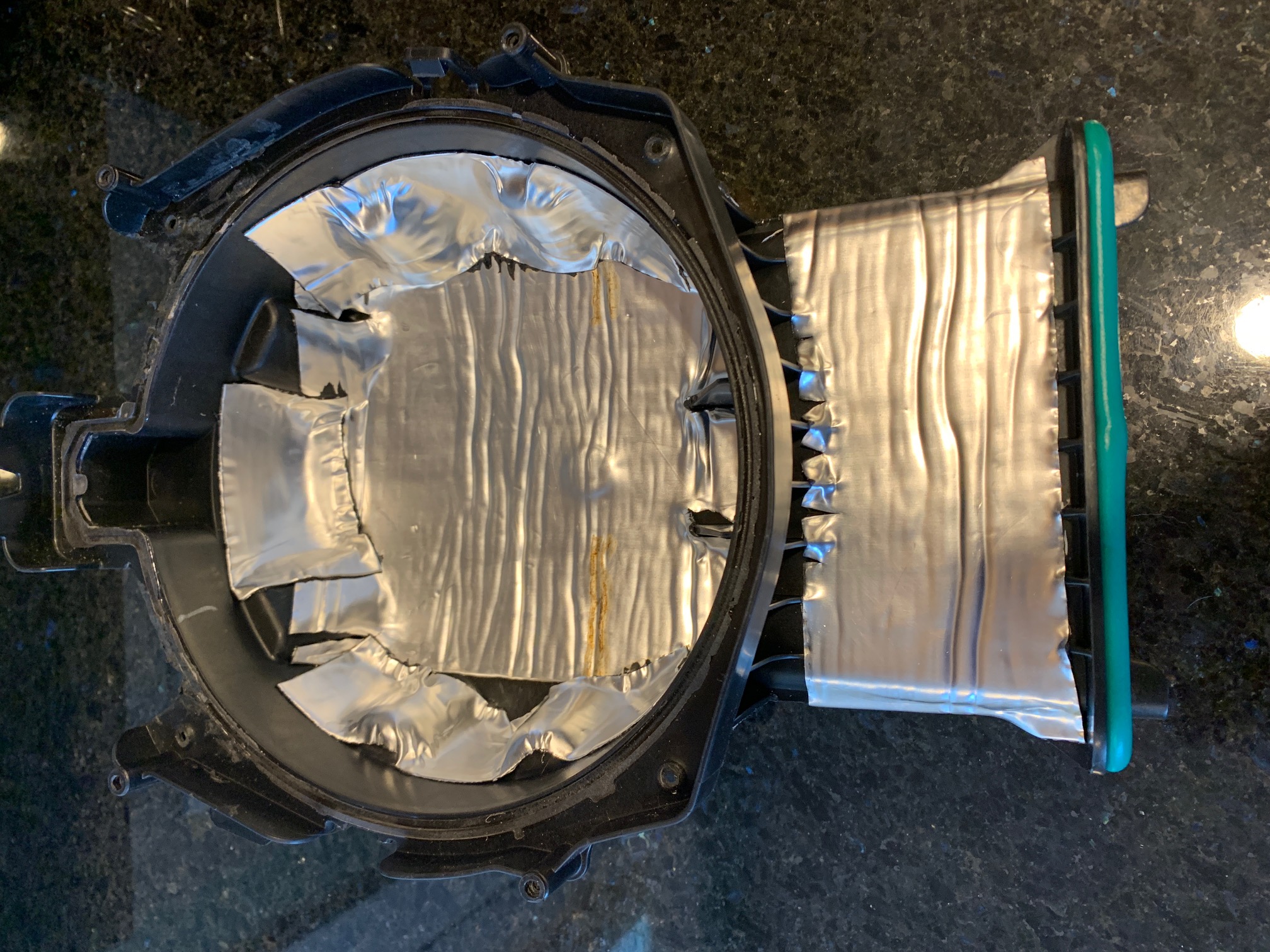

Not that it will help this issue, but since I had the enclosure out I decided to put sound deadening material (I use Peal and Seal which is basically the same stuff as Dynomat but way cheaper).
I figure it can't hurt
I'm off to Lowes tonight to get another roll. I'll probably need a bunch once I get the JL W7 HO Box hooked up as I basically did the entire trunk on my E46 M3 when it was in there as it was rattle city before lol!
