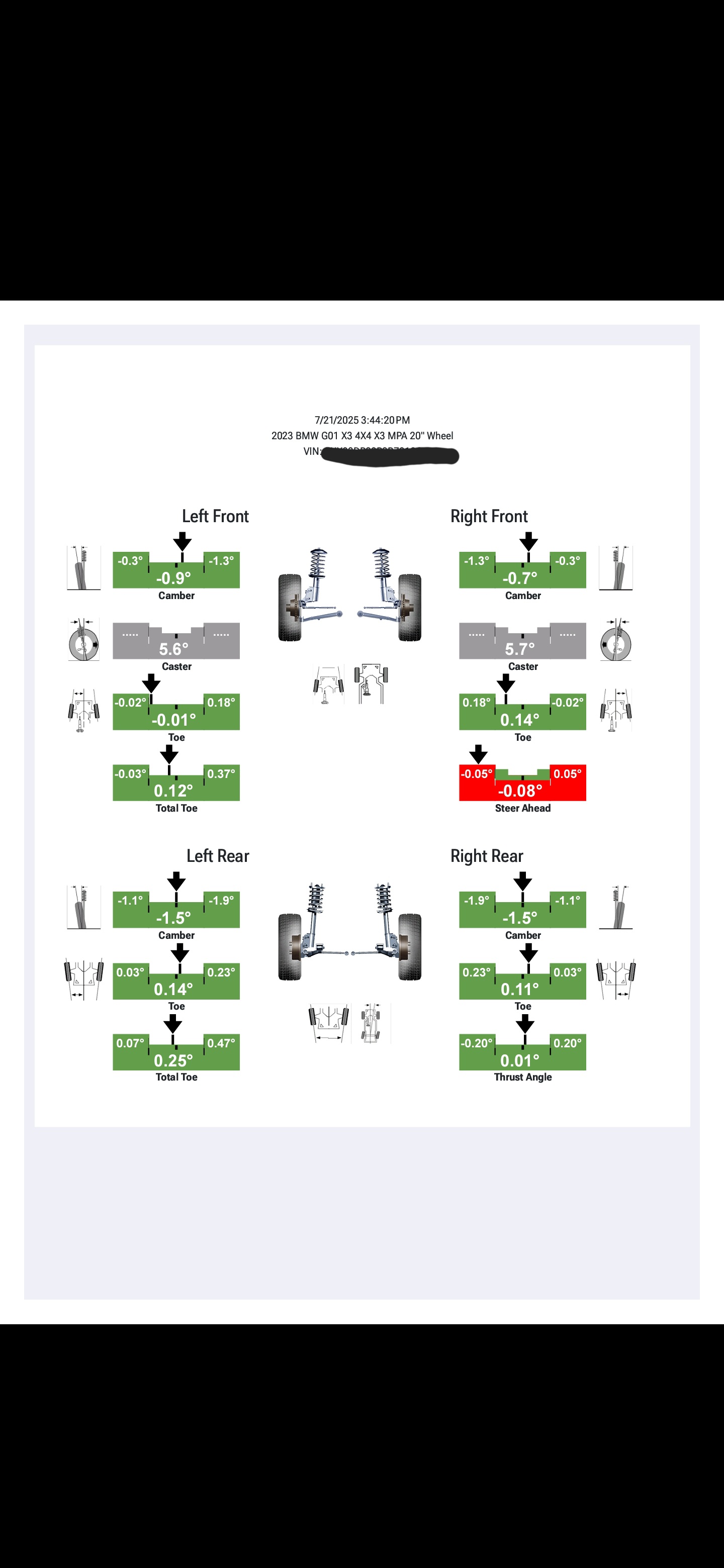

Alignment results
My tires finally arrived and had them installed on my new wheels...pictures coming tomorrow due to rain.
Here are my alignment results and the only thing I question is the steer ahead showing in red. I did not see the alignment results until after I got home.

I’m not certified mechanic but I think the steering wheel may not have been locked straight during the alignment, new wheels should have very little to do with this part of an alignment.

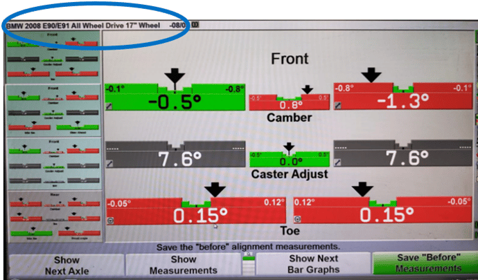

2020 330i xdrive   [0.00]
if you are changing the size of your wheels and also if the width of the wheel varies by 1”, it is recommended to have an alignment done.
the ride height, wheel size/off set and tire size all play a large role in the vehicle’s suspension geometry
in order to load and proceed with proper alignment specs for any model, you have to input the ride height and wheels size of the vehicle
hunter alignment
to answer your question, your steer ahead should be dead straight (zero’d out) as that is what determines whether the car tracks straight with the steering wheel leveled
(see attachment above)
