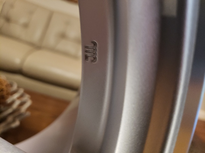

Apologies if this was covered already and I missed it, but are these wheels TUV / JWL / VIA certified, or otherwise advertised / certified for a particular load rating?

Sorry to ask, but for those in the class that dont have an engineering background or any real comprehension of metal, what does any of that mean? is that good?
I am in the same boat but using google research (i know very advanced).
Basically JWTC or commonly knows JWL stands for Japan Light Alloy Wheel. A set of established standards for alloy wheels in Japan. These standards are amongst the most rigorous in the industry and are required for all wheels used on vehicles in Japan.
While intended for Japan JWL has become a global benchmark for wheel quality and safety.

For anyone that has received their set of wheels from XY Wheel, was the face (or anywhere) stamped with the JWTC or JWL mark? Or was there a label on the inner barrel similar to what Volk/RAYS applies on their wheels?
I should know this soon. FedEx has my stuff so almost.
On the BBS CC-R set they made for me there was a JWL stamp on them, no markings at all on the backside though.
