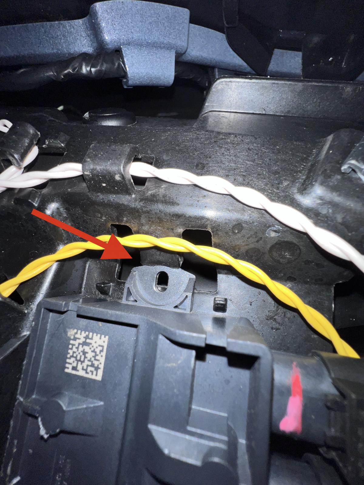

This 'tang' thang. Looks like so? I'm being paraoind so I don't snap something. If that *is* the thing I have to somehow press for it to fall out, I'm totally puzzled as to how you guys (without taking the WHOLE diffuser off) managed to figure all this shit out :-)
Just push the tang towards the white wire it will bend and allow the module to fall out
Swapped mine last night took me about 8 mins
