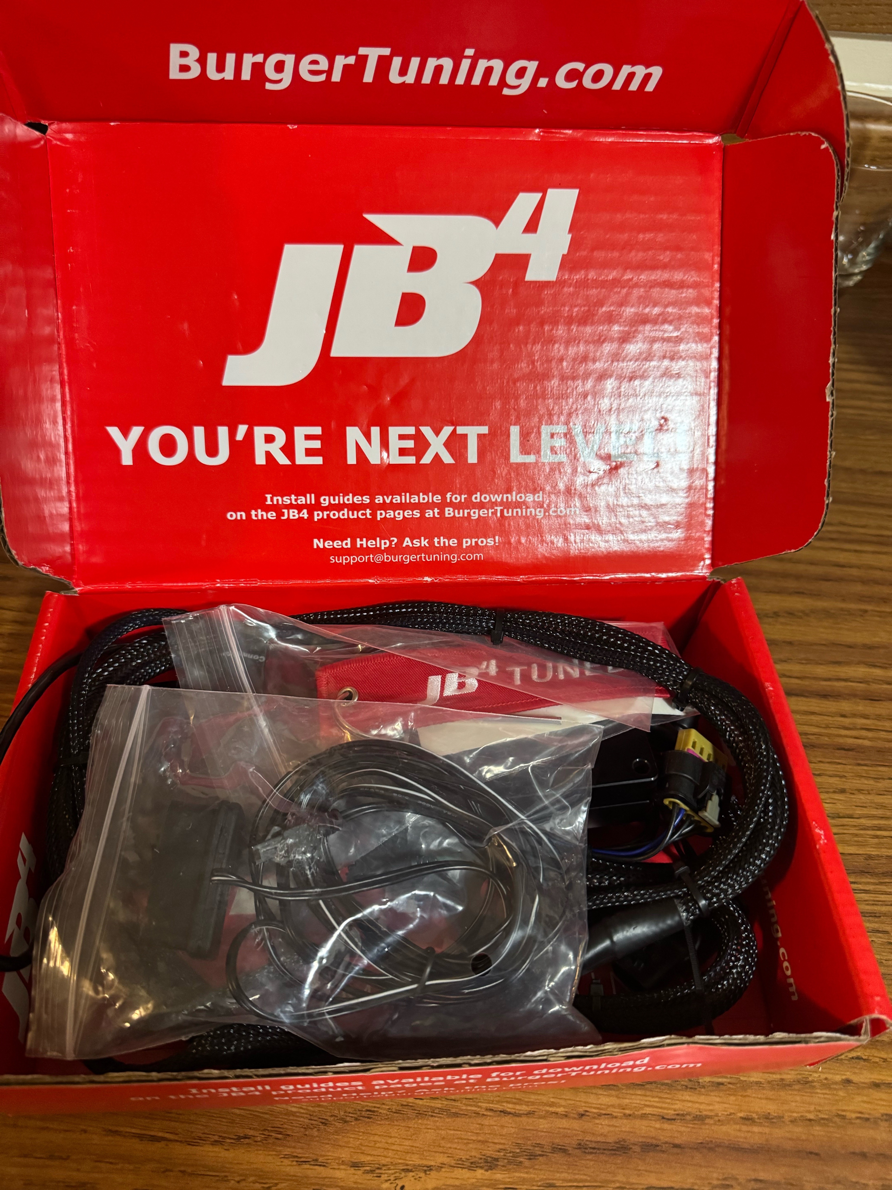

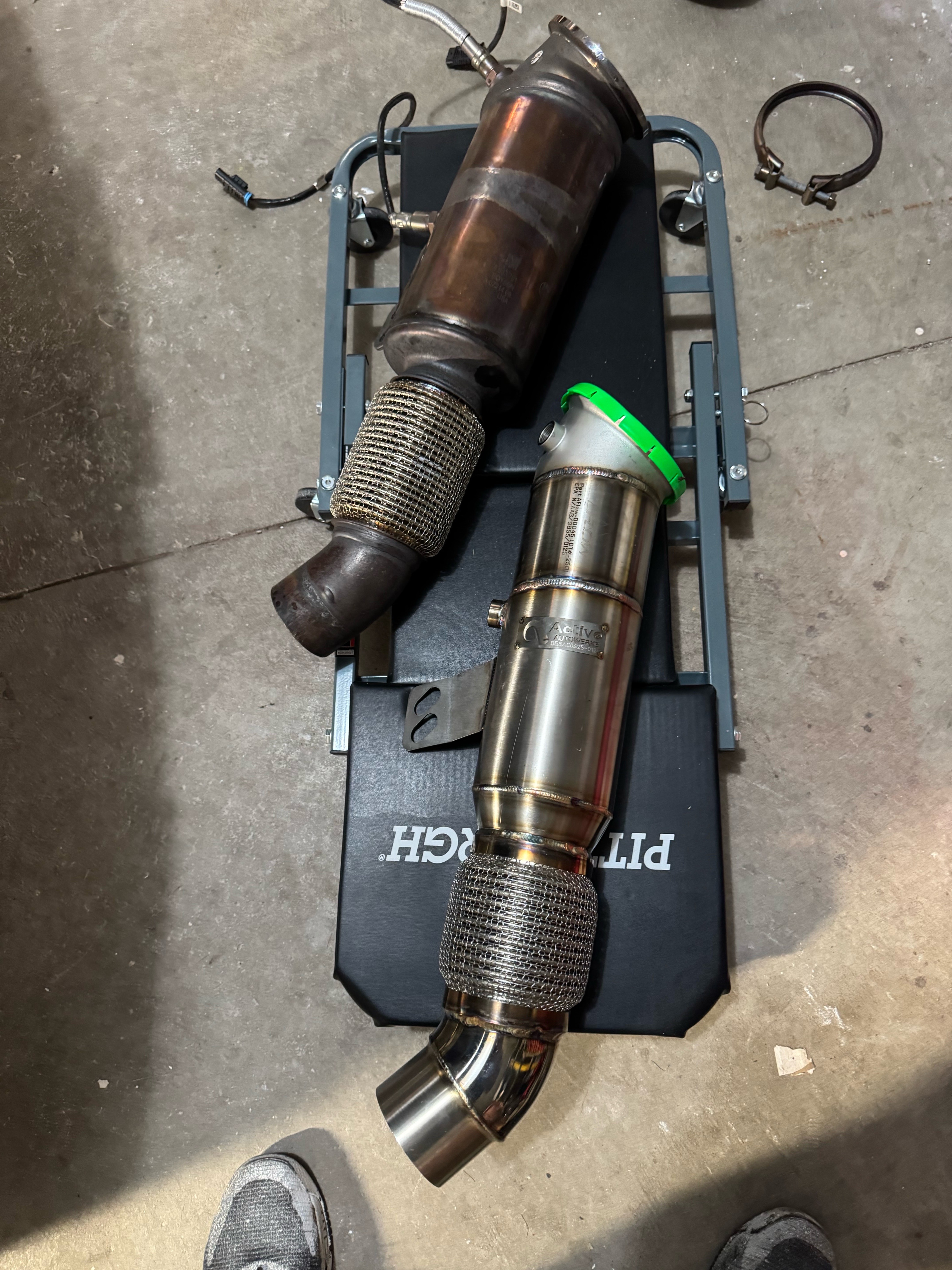

Update: I ended up installing an Active Autowerke High Flow catted DP and a JB4 tune. Will be installing an aFe Momentum cold air intake this weekend. I’ll upload before and after videos once I get the cat-back exhaust installed as well!

Update: I ended up installing an Active Autowerke High Flow catted DP and a JB4 tune. Will be installing an aFe Momentum cold air intake this weekend. Ill upload before and after videos once I get the car back exhaust installed as well!
Get the updated Fuel Pressure board to run higher boost and more ethanol with JB4. Im running map 5 with E35 and its crazy fast for an SAV!!

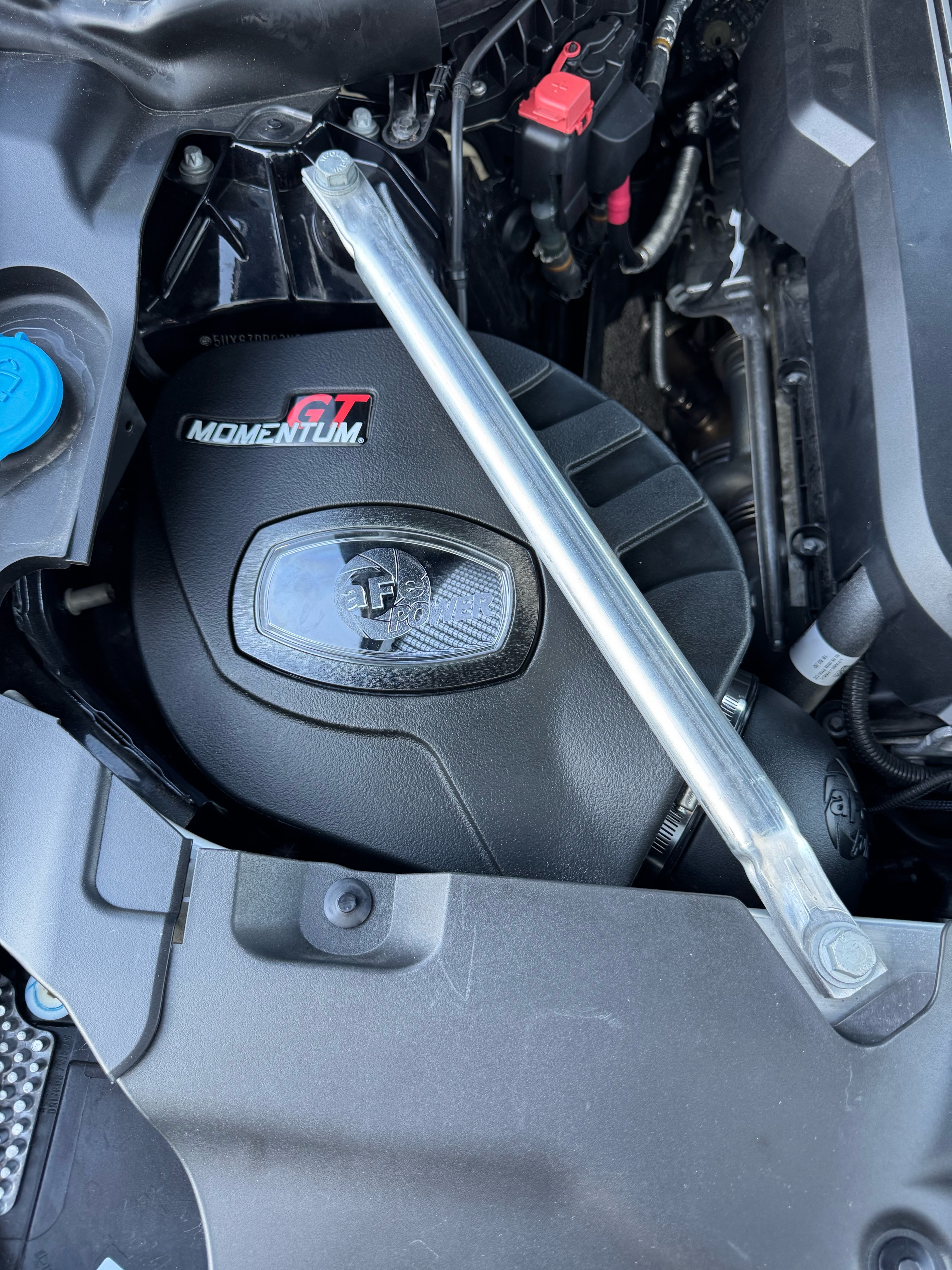

The aFe CAI is in! Turbo sounds didn’t change much but the car feels quicker in map 2.

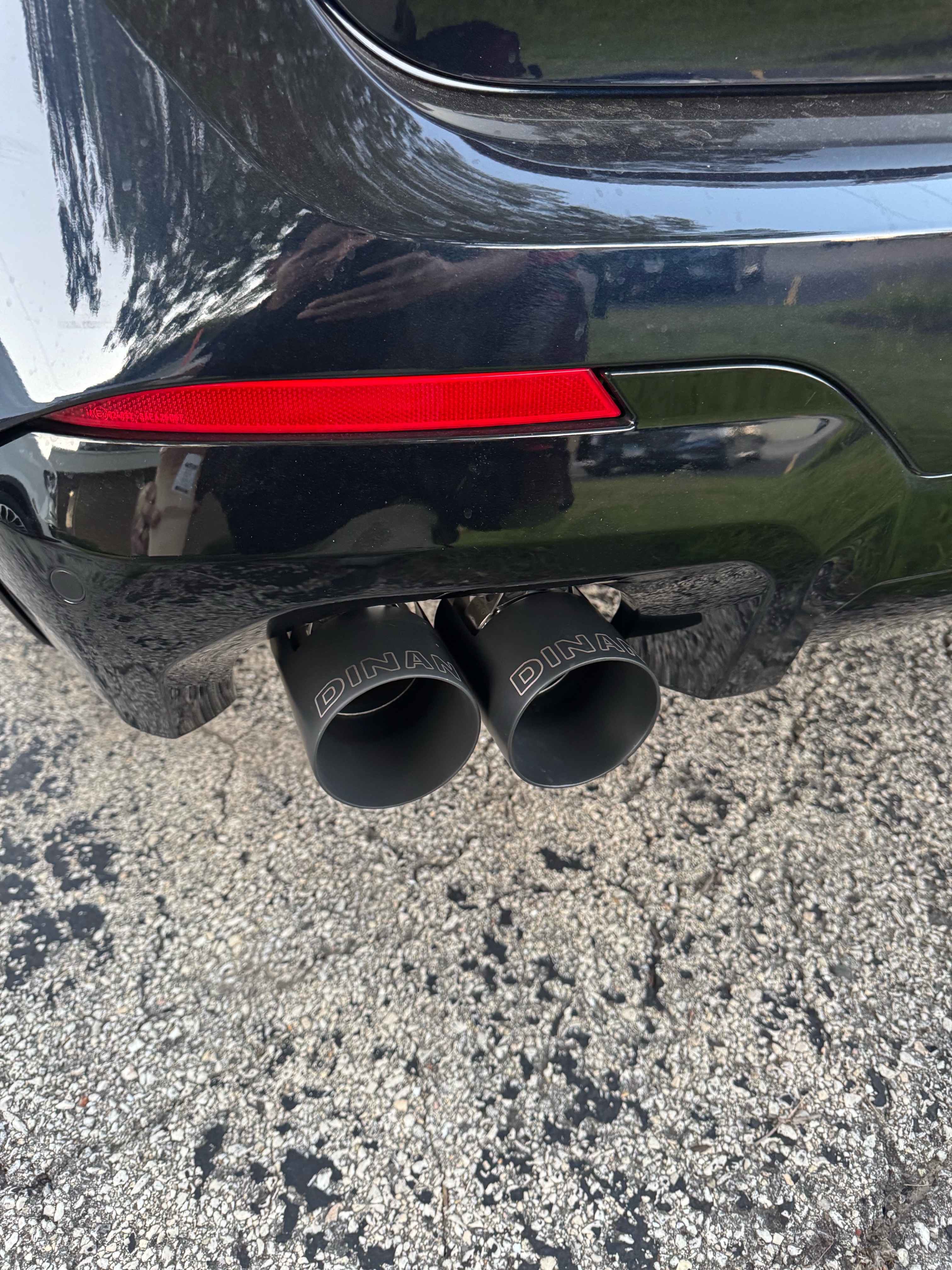

Installed the Dinan Cat-back exhaust and what a difference it makes. It sounds unreal. A little too loud for my wife but I’m told it’s not as loud or wild as the Valvetronice exhaust. I’m happy with the results!
Definitely recommend for anyone thinking of upgrading their stock exhaust.

Surprised the Momentum intake is not that noticeable for you. I may have to consider one. My MST intake noises are comical and even occasionally embarrasing. I can conjur up a race with any high schooler within a block radius just by going 30% throttle and letting off quickly. The whistle and whoosh is like a mating call for them.
I was considering an MST intake but it was out of stock for 2 months before I landed on the one I have now. I’m thinking of swapping out my aFe intake for a Dinan but not sure what difference it will make in terms of sound.
