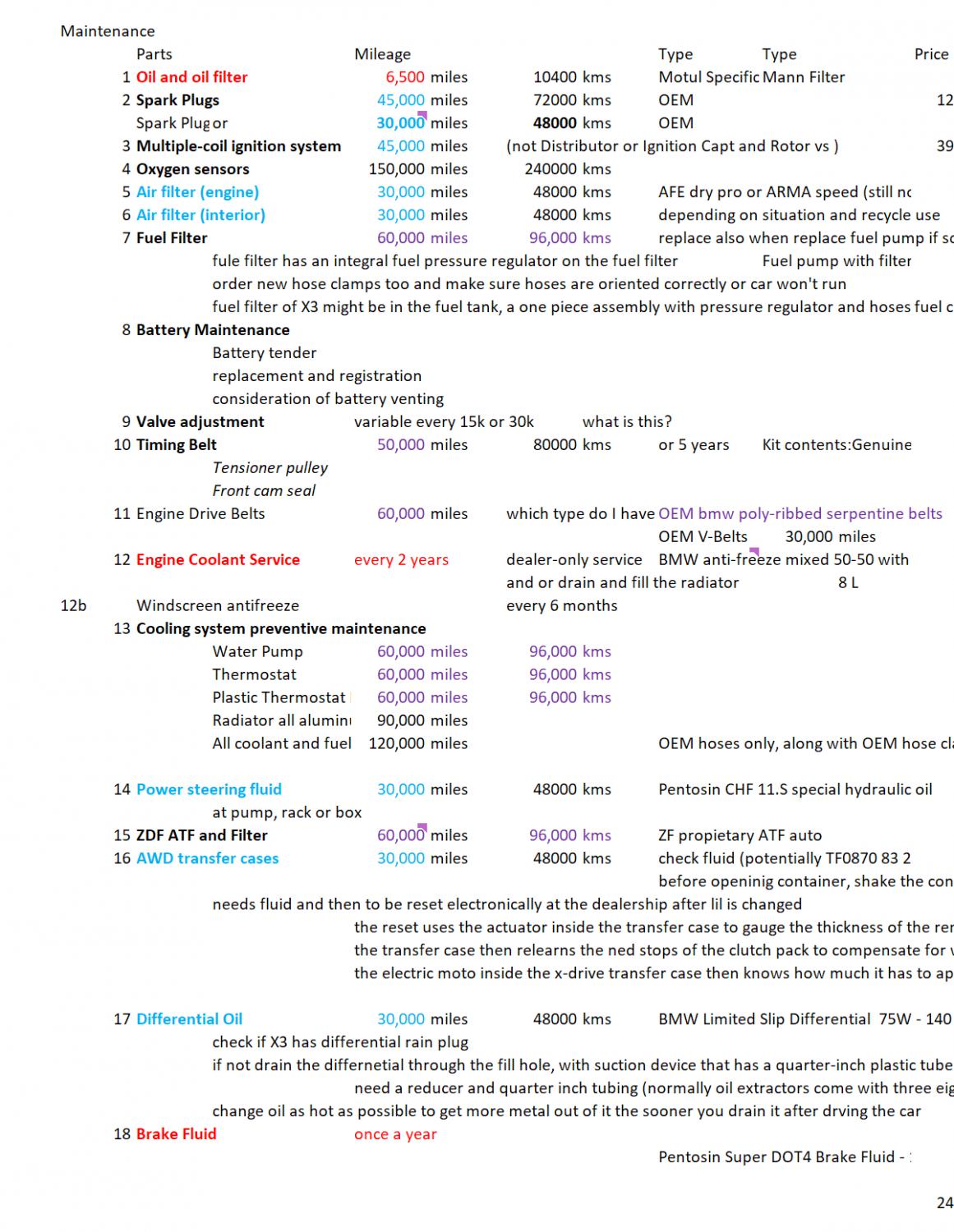

This: Some well known bmw expert (don't recall his name) had put together a guide and this is a summary of it.

Very nice, this is what I was hoping to see. So spark plugs are interesting...normally 60-100k miles I would assume. Not that these are difficult to get to compared to what I'm used to (Subarus, ugh)
Fuel filter is one I haven't checked for..on my ZHP there was an inline filter under the vehicle on a hard line..do we have the same somewhere up under all those trays or is it just the integrated filter in the fuel pump housing assembly?
What I'm really frustrated by is I got my vehicle certified, off lease, at 29k miles. If there are 30k service items like differential, transfer case, transmission, brake fluid, I am unable to get the service history for that...I've asked the dealership no less than 4 times now to provide me the records for what was done during the certification so I know if I need to do those items but so far they haven't provided it and seem very disinterested in doing so. All I can see is some generic service notes on the carfax.
Is there fluid for electric power steering? Assuming not..

To be clear, this is what an independent guy who had lots of experience with BMW recommends. This is not a BMW recommended list, so you will not get anything from the dealership unfortunately.
The guide is also recommended mostly for those who want to keep their cars for more than a decade, which seems like the minority of members on this forum.
EDIT: someone knows if X3s have a fuel filter?

The list makes no sense. Coils are very high mileage replacement items.
Fuel filters are normally integral with the fuel pump which is immersed in the fuel tank. This means the fuel filter is generally unserviceable and does not need replacement. Is BMW different? It’s not a 1980s NA IDI 7.3L Ford Powerstroke.
Axle (differential) and transfer case oil change is also high mileage work, over 50k miles in my view.
Of course anyone with a passion to do these things are free to do them as often as desired, if that’s how a person enjoys spending their time and money. But this is not necessary.
I enjoy DIY but have owned and serviced enough vehicles over the years to know how often these things need done.

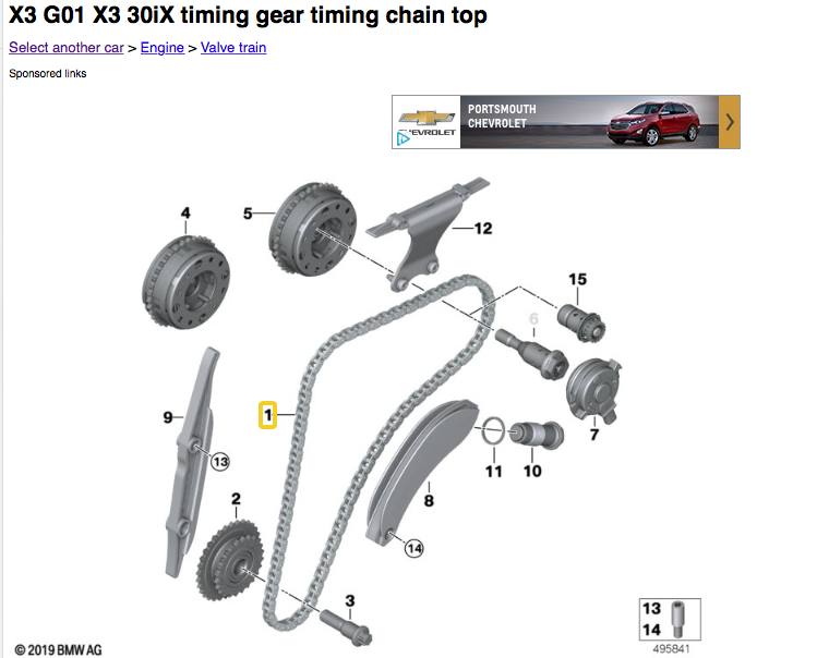

I got nervous seeing timing "belt" in this list, but it looks like it is a chain and 50k seems a LOT premature for a chain??

Disregard the list above.
Serpentine belts, or poly-v groove belts or fan belts, whatever you like to call them are an approx 75k mile replacement item. Most engines the belts are no drama to replace, you do need to know how to locate and release the tensioner. It’s a 10 minute easy job, from hood pop to hood slam including cleanup, if you know what you are doing.

Yes, we have a timing chain. BMW says it's lifetime, but who knows what's considered lifetime by them. Honda defines it as 250k. I'm going to be very aggressive with my oil changes, because to replace the timing chain(s)/tensioner it's an engine-out job. I'm pretty DIY, but that's too much for me, and I certainly don't want to pay a shop to do it. If I can get a minimum of 150k out of it, I'll be satisfied.

Again, the list is a summary per the "Mike Millers Old School Maintenance SChedule" he was one of the main tech guys at bmw car club of america and has written in depth about service schedules. They are a decade old, so yea most likely certain items can be replaced later on as hopefully tech and material have gotten better.
Check the thread below:
https://www.bimmerpost.com/forums/sh...php?p=24577914
