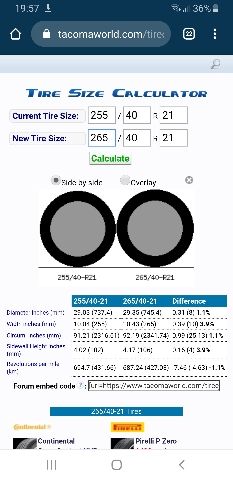

If you comparing 255 40 21 in front (confirmed that they fit) to 265 40 21 they are very similar in size (see link) so maybe he is right. However, you would like to have it confirmed before ordering.
https://www.tacomaworld.com/tirecalc...0r21-265-40r21

Location: Chicago
Wouldn't
255/40R21
295/35R21
be a better fit?
https://tiresize.com/calculator/
shows 0.3% variance with this setup.
Whereas with 295/40R21 there is a 4.5% variance.
I love fat tires in the rear...

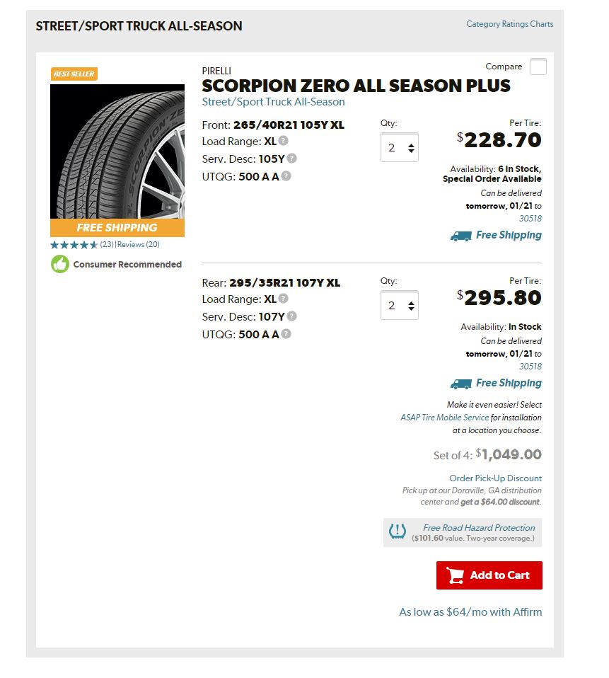

Wonder if you could run 265/40 on the front. Pirelli has a all-season tire in 265/40 & 295/35 for around $1000 a set.
