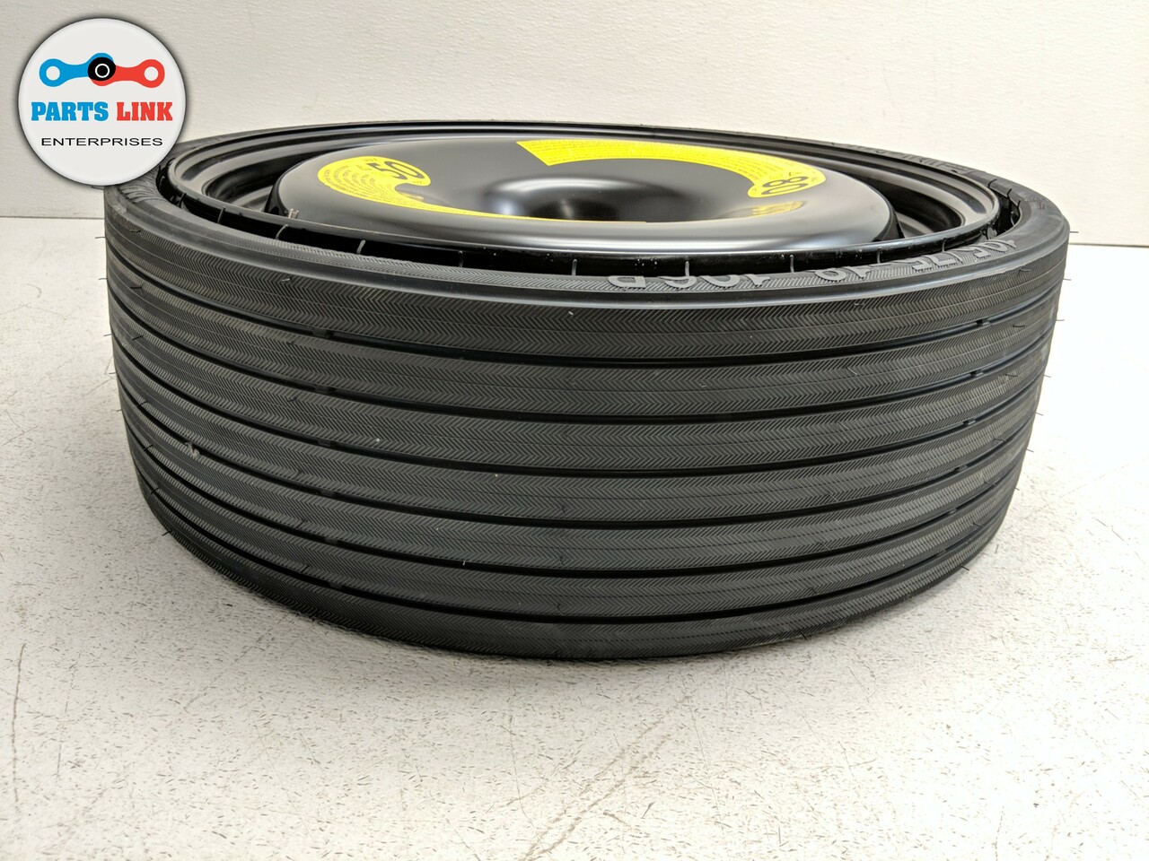

LOVE to know if this VW/audi collapsible would fit??

By the looks of it, that spare is too wide to fit

Maybe a waste of time because it's not confirmed an audi wheels is same bolt pattern. But your thinking the width because the BMW donut is narrower than the spare rim (so your talking hight?)
I will be needing new tires VERY soon and like to mimic this spare hack - THANKS for posting!

Can you give us the PSI you took the donut down to fit?

About 10....its basically a flat tire with a mounted bead.
