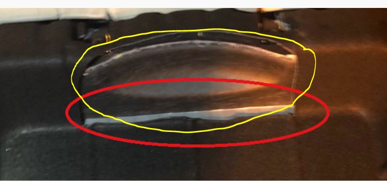

I will be doing this mod. Is cutting the sub floor near the 2nd row seats necessary? It looks like the top of the tire will not go beyond the base of the sub floor's storage area anyway:
      03-07-2021, 03:44 PM   #54
75fusca
75fusca's Avatar
37
145
Drives: 2018 BMW X3 30i
Join Date: Feb 2014
Location: Canada
What material is the black "block" below de fiber floor near the rear seats?
Was it "carved" by you guys to accommodate the tire?
Thanks!

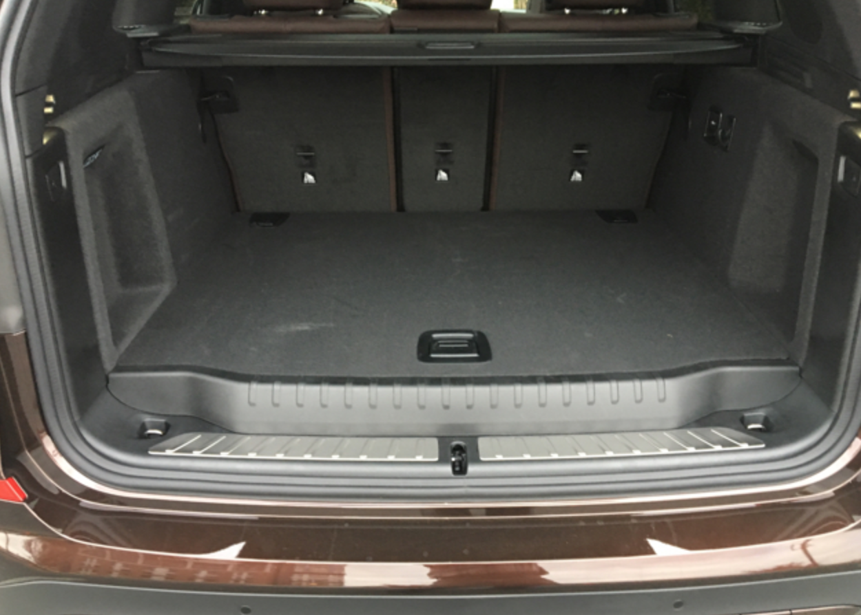

I finished putting the spare tire into the regular trunk today. I added a
tire plug kit, soap water spray bottle, and air pump and tools needed for
repairing a tire instead of using the spare. Additionally, I used vinyl coated
stainless steel security cables (2) and snap hooks to secure the tire to
the base using the battery's frame. I included link to the cables/hooks below.
I really like this solution, I now have Michelin Pilot A/S 4's, and options in
case I ever get a flat. I would have to say, even if I kept the runflats, I may
have done this anyway, because what if i get a flat tire in the middle of
nowhere far from anything? I dont understand what makes car manufacturers
these days stop putting spare tires in. I have 2 more cables and hooks that
I can use to secure the floor using the cargo rails on either side, but
haven't done that yet, dont think I need to.
Links for cables/hooks:
https://www.amazon.com/s?k=Safety+Ca...ref=nb_sb_noss
https://www.amazon.com/s?k=sprookber...ref=nb_sb_noss

I had to let out alot of air, and wiggle the spare tire down to allow the floor
to close unimpeded. Once the tire was in, I put in a little air back in,
but not much.
The main reason I did this was I did not like the runflat tire.
If you like your runflats, then you might not want to do this, maybe,
unless you are driving thru the Desert LOL
