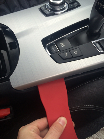

Ok so first step
Open up the arm rest and proceed to remove the trim around the gear shifter by popping the clips on each side. i used a flat wide trim tool so as not to mark the softer trim underneath. Moderate force got this to move with no trouble.
and here
then lift the trim up slowly, this will reveal the 3 connectors connecting the iDrive and other fittings on the trim.
now begin to unclip the connectors
here
here
some of these were a little tight but gentle tug moved them all with little fuss.
leaving you with this, you should be able to see the clip points for the trim to work out where to pry etc..
