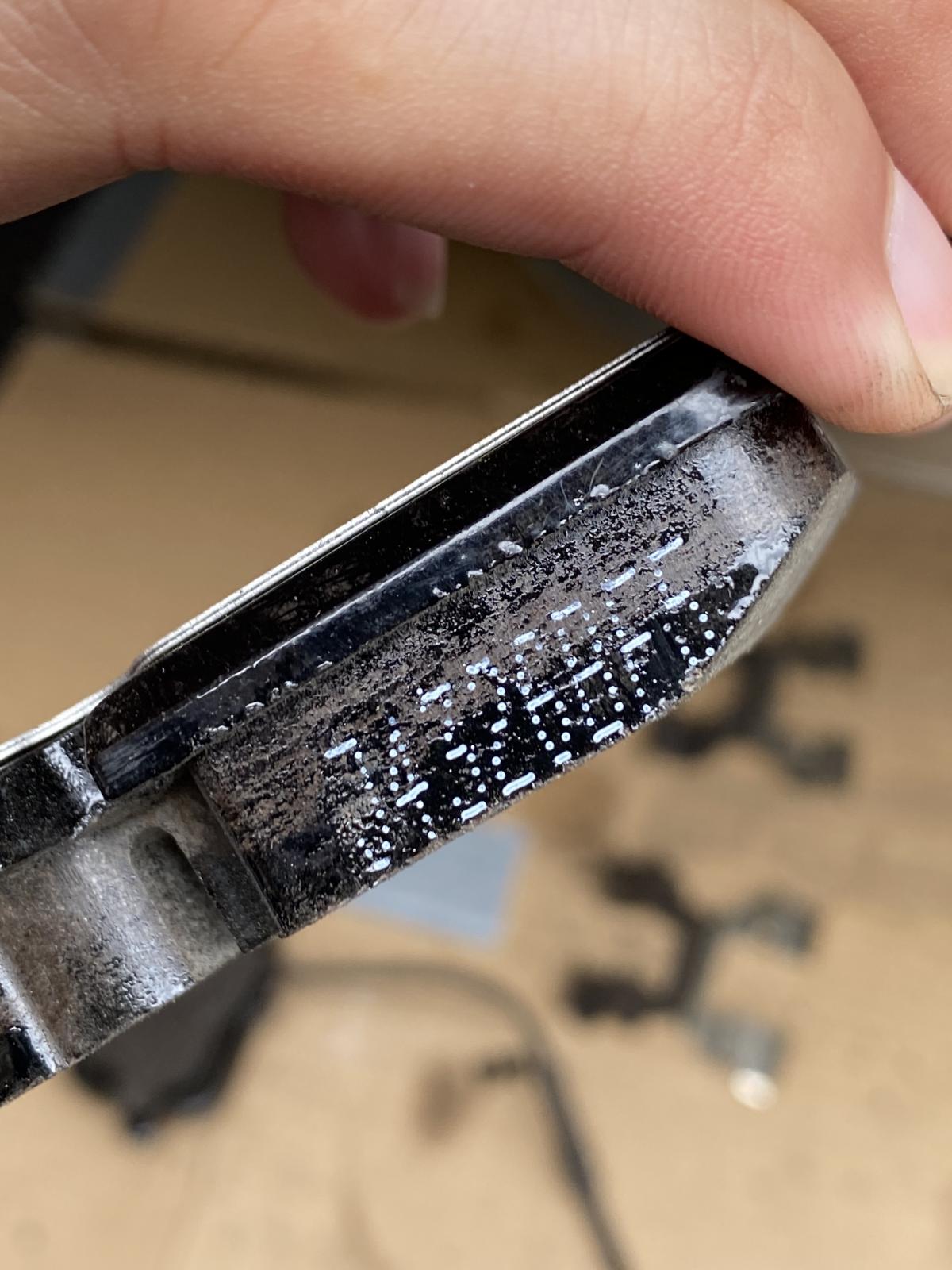

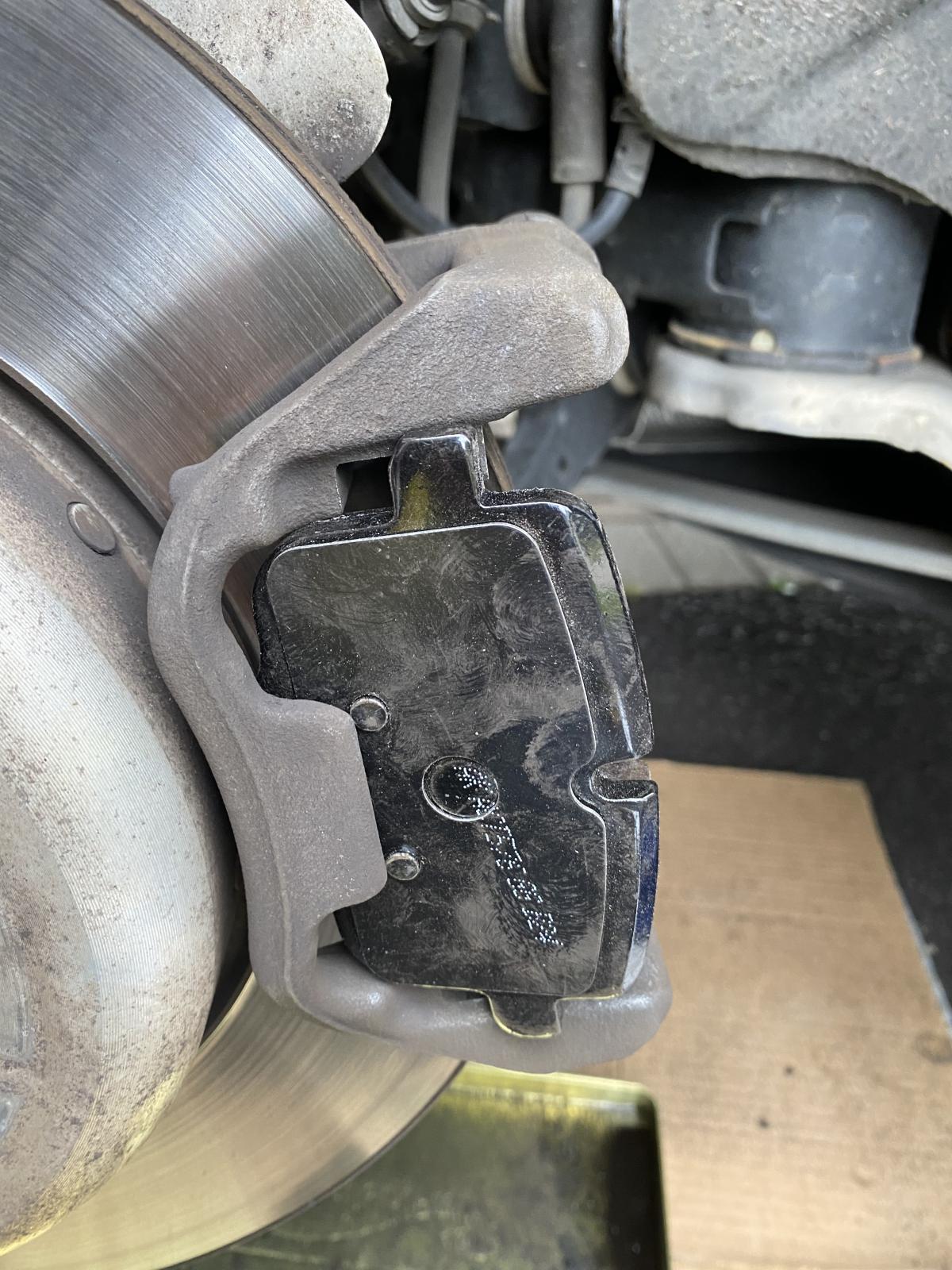

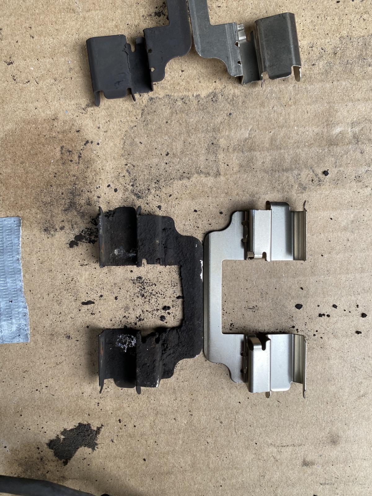

Akebono brake pads does not fit, please advise
I have a 2021 X3 xDrive 30i. It has ~54k km on it, and the CBS shows the rear brake change is due in 900km. I ordered EUR1850A (rear) and EUR1892A (front) from RockAuto. Today, when I was doing the rear brake pad job, I found out that the rear pads don't fit the caliper (the ears are a bit too long), and the included clips don't fit snugly either (I had to bend the tabs a little bit to get it installed). Did I order the wrong part? I triple checked both the Akebono website and the RockAuto website, and both sites show that they will fit. Or did RockAuto send me the wrong parts? Please advise, thanks.
For anyone who's interested in some data. My rear rotor is at 19.3mm and rear inside pad is at 3.5mm.

[QUOTE=jellycsc;31285195]I have a 2021 X3 xDrive 30i. It has ~54k km on it, and the CBS shows the rear brake change is due in 900km. I ordered EUR1850A (rear) and EUR1892A (front) from RockAuto. Today, when I was doing the rear brake pad job, I found out that the rear pads don't fit the caliper (the ears are a bit too long), and the included clips don't fit snugly either (I had to bend the tabs a little bit to get it installed). Did I order the wrong part? I triple checked both the Akebono website and the RockAuto website, and both sites show that they will fit. Or did RockAuto send me the wrong parts? Please advise, thanks.
Looks like the correct part number for the non sport brake pads, front and rear. I was going to go with the Akebono’s but ended up getting Power Stops . That sucks when you already have everything apart and then you find out there’re wrong .

[QUOTE=X3rd Time Is a Charm;31285231]
It indeed sucks. Plus it's my first time changing/DIYing the brake pads

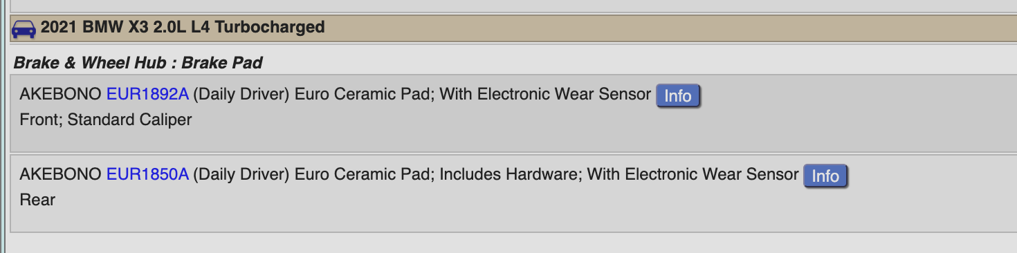

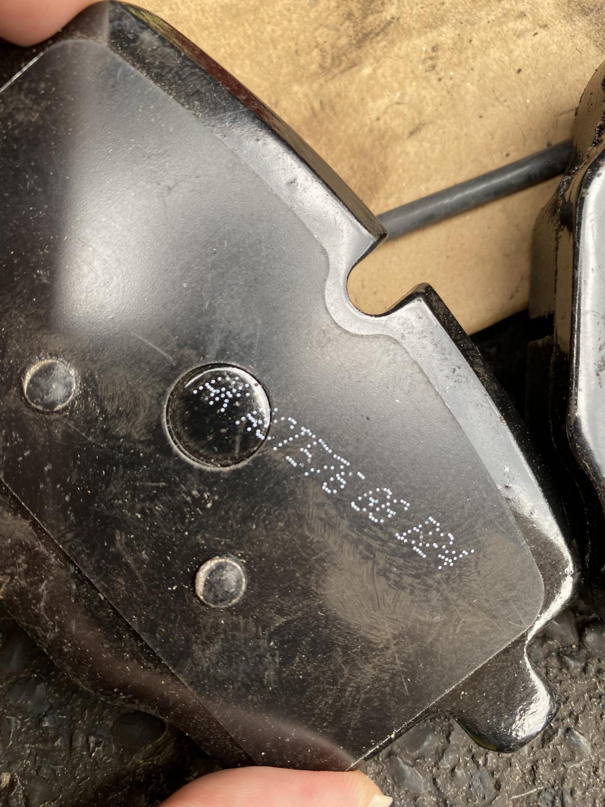

I don't know the correct answer, but how did you choose 1850A and not 1473?
1850A includes the wear sensor. It seems like you are pointing at the right direction. FCP Euro shows that EUR1473 is for non-M brakes, and EUR1850A "Only for cars M Sport Brake (S2NHA) and M Red High Gloss Sport Brake (S3M2A)". Can anyone confirm?
https://www.fcpeuro.com/products/bmw...t-rear-eur1473
https://www.fcpeuro.com/products/bmw...ebono-eur1850a
I was under the impression that 1850A and 1473 both contain the same pads, but 1850A has an extra wear sensor. This seems to be wrong.

Check the Akebono part selector:
https://akebonobrakes.mypartfinder.com/
I just placed an order for EUR1473. Fingers crossed, I hope it will fit this time. The part selector shows both EUR1473 and EUR1850A will fit.

Location: Markham, ON, Canada
Update - EUR1473 fits perfectly on my X3 non-M rear caliper. The initial bite feels weaker than OE, and overall feels more linear.

Originally Posted by Ppt999 View Post
So did the rear kit came with brake sensor cable or you have to buy seperate
Wear sensor is not included in the EUR1473 kit. I picked one up from my local dealer.
