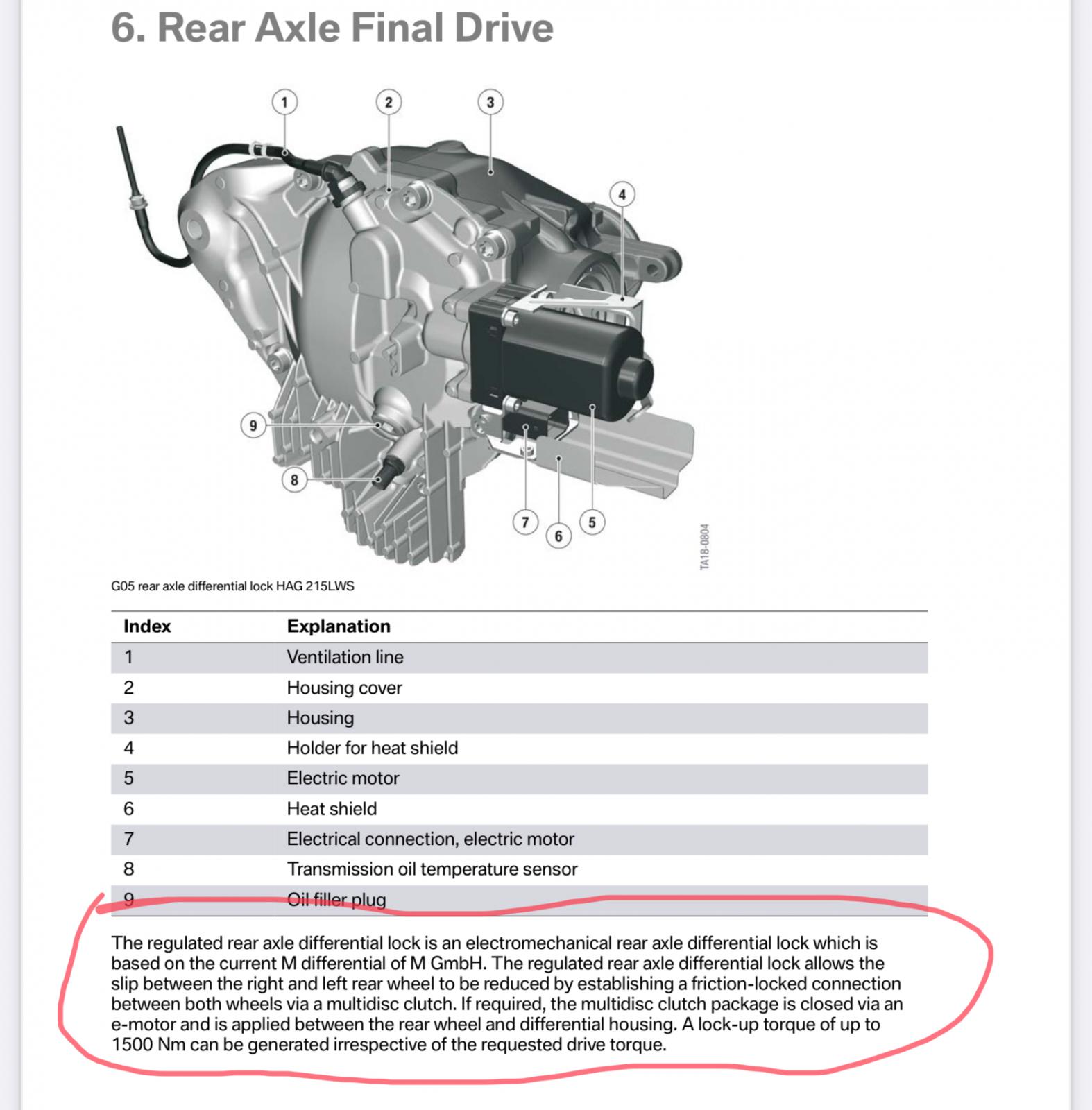

No it’s not BMW marketing speak for a common LSD.
The BMW HAG215 as optionally fitted (standard in some markets) to the G01 M40 is an active electromechanical regulated locking GHAS limited slip diff, so more advanced than common basic mechanical LSD.
The HAG215 M Sport diff design is based on the HAG225 diff used in a true M F97, but it is not the same part, although both employ the same active electromechanical approach.
Look for option code 2T4 M Sport Differential on the VIN to check the type of diff fitted.

The BMW M Sport diff option code 2T4 is standard on the G01 M40 in the UK, but afaik it’s not an option on other G01 models here.
It’s an option in the US market on M40 afaik.

It’s more of a traction and performance safety feature on the M40, as I don’t think BMW is trying to cater to a target market that wants to drift a family SUV, or is confused by thinking it’s a sport car.
Here’s what BMW claims, and notice how there’s no mention of F97 X3 M like performance or drifting, shock….

Right... all I am saying is... it's kind of irrelevant if its the same exact diff if it can't be used the same exact nor similar way.
In the X3M it's a performance setup... in the M40i, its a safety / traction setup.
Also - many people are looking to slide / drift their suv... have you driven an X3M? It bends physics...

I didn’t say it was the same exact diff, in fact I said they are different parts but shared the same active electromechanical approach i.e. both use an electric motor and controller linked to the DSC to alter a clutch pack.
Yes, I’ve driven an X3 M Comp, and owned plenty of very fast sports cars, but the F97 or M40 isn’t a very fast sports car, it’s a capable family SUV.
As for drifting, buy a car designed for that if it’s your thing. I can’t say my what do a I want from an SUV list has ever had drifting on it, but something that improves traction performance and offers better handling would be.
