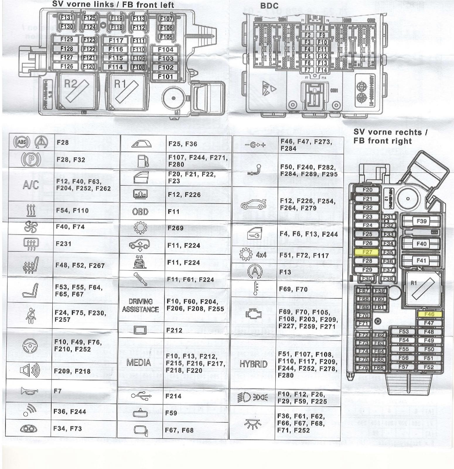

Fuse F46 will work with a fuse tap. Access is quick and easy underneath the glove box, just remove a panel and you will see the fuse box. Get the right size fuse tap, it's on the larger size.

Thanks. Is F27 supposed to be empty? Do we know what it was meant for? This is in front oassanfwr side fuse panel on G01?

I used F46 for a radar detector, it powers down when the ignition is witched off and 6 to 8 minutes elapse. Not sure about F27 but it could be vacant and usable. Someone on here will have the answer for the usability of F27.
I will search more dash cam threads. Thanks. Was F46 unused in your case or did you use add-a-fuse?
Add-a-Fuse, and it works perfect.

[QUOTE=hyde;31019605]Got it. I prefer to use empty if possible but I'll consider this, I'm sure it's just as safe but I guess I got lazy when I had bunch of empty slots that were switched power only. Is there a bolt you used for ground near the fuse block?
Yes, you will see the bolt when you get the plastic cover off below the glove-box, you cannot miss it, makes for a good chassis ground. If sitting in the passenger seat it would be on the right side under the glove-box.
