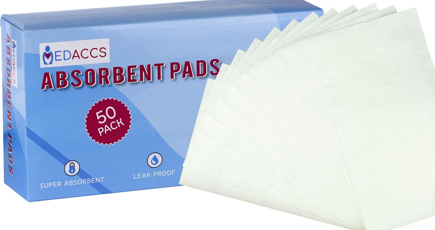

Not a permanent solution, but if water is sloshing around in the battery compartment, place these in the leak area to absorb the water, until the leak is corrected.
Not a bad idea. I might even use that just in case the issue comes back. My trust in the dealer being able to fix anything is growing smaller by the day.
