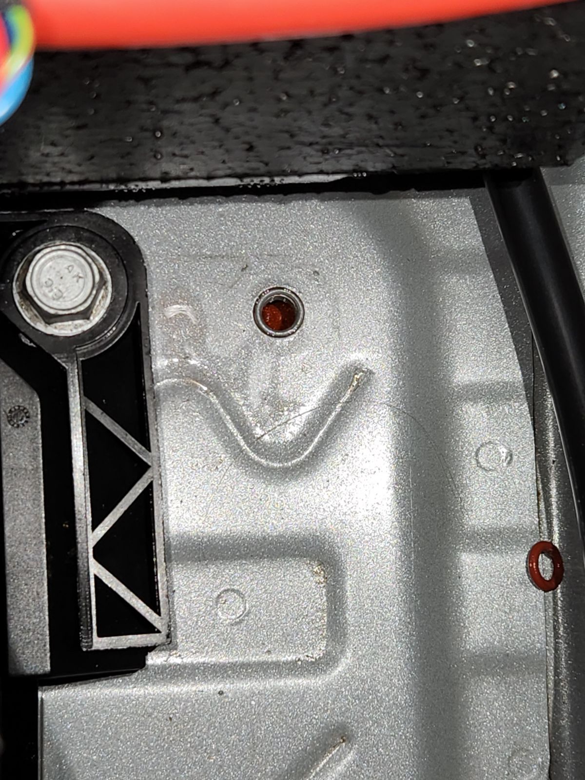

Checked and the vent hose for the battery was not connected. This Pic is the right side of the battery looking forward. Found this threaded hole and o ring with nothing connected. The washer fluid is red. Was told that my father in law used the vehicle at his dealership and would transport oil and other fluids. We cleaned up the excess and I guess will wait and see if it leaks more.
The threaded hole is for the next size up battery.
Was the red fluid slippery like oil or like watery washer fluid?
Never seen red washer fluid, only blue or orange rain x brand.
No idea what the o-ring is for, maybe nothing to do with anything back there
