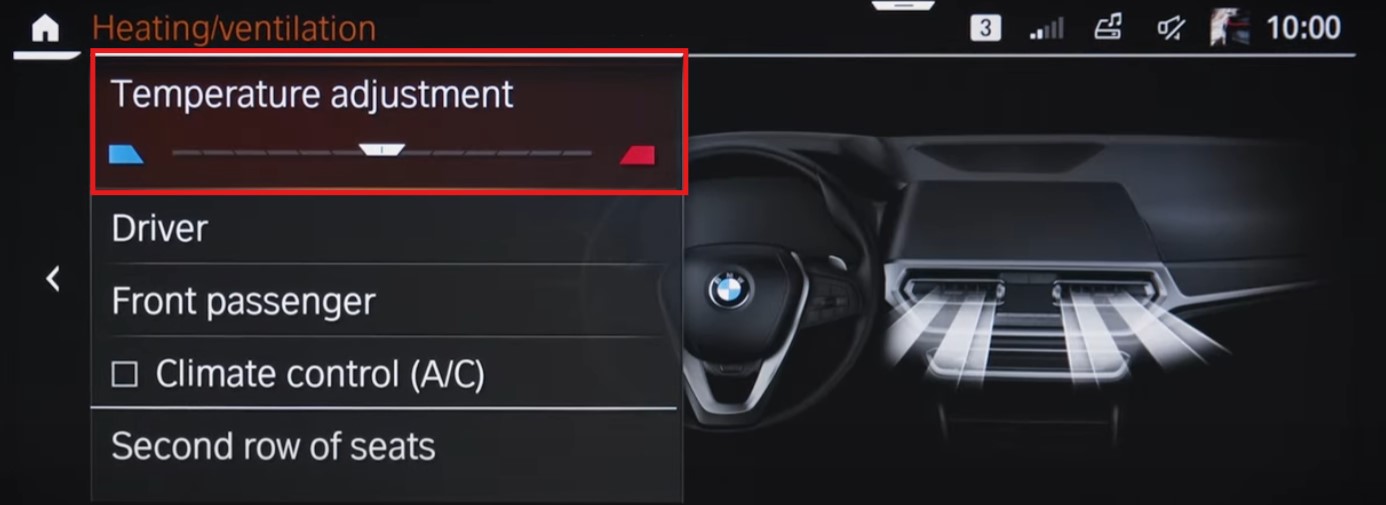

Older BMWs used to have the Red/Blue dial on the dash which brought in hot and cold air depending on the position. It is now digital in the A/C menu, you may want to look for it and set it accordingly.

Originally Posted by Th3Walrus View Post
First sentence of 2nd paragraph:
When you said face temp even I thought you meant the one that faces you, which is the numbers, not the MENU adjusted temp. No the engine will not eat up air as it comes in because it is moving to quickly in ducts around it, if you are idle, possibly, but moving no, it should be near the outside temp +/-5 degrees.
