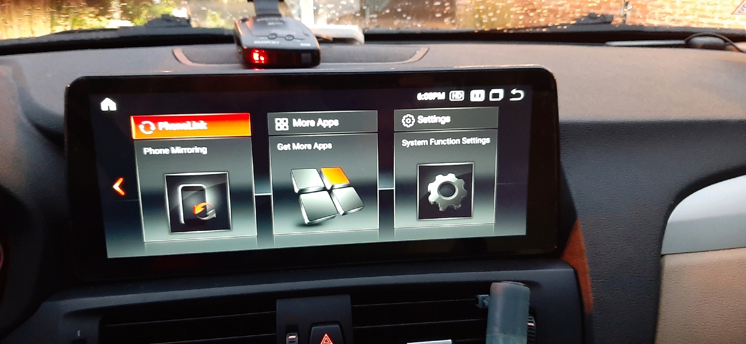

i was checking the new android stuff in aliexpress. I found this new screen 12.3 with the left edge cutted to fit the dashboard. Also i am not interested in android (i have oem carplay as i did nbt evo retrofit). I asked the seller and he told me it can be set to always start up in OEM Menu instead of android.
      04-18-2022, 06:33 PM   #7
aspame82
Mr
Peru
21
103
Drives: BMW X3 XDrive28i Xline 2017
Location: Lima Peru
      04-18-2022, 06:45 PM   #8
aspame82
Mr
Peru
21
103
Location: Lima Peru
<a href="https://imgbb.com/"><img src="https://i.ibb.co/NKNHH90/bmw-x3-f25-12-3-android.jpg" alt="bmw-x3-f25-12-3-android" border="0"></a>

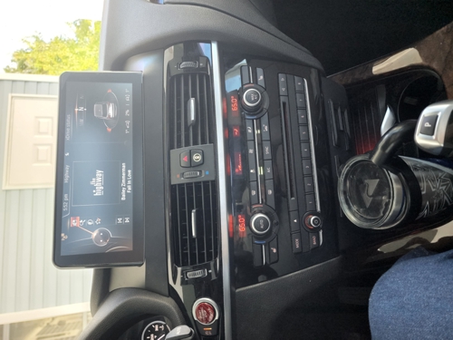

OK - so after a couple of different members here pointed to AVIN for a good source for the aftermarket upgrade screen....... I did some shopping and reviewing (and a LOT of over-thinking).
Bought the 10.25 screen from AVINUSA.com
I just like the look of the 10" screen over that of the 12" screen that (to me) looks a little oversized for the dash design.
Since I wasn't interested in the multimedia, navigation, or android components of their system, and only was interested in utilizing the display screen / I opted to take advantage of their "sale".......... outdated Android 9 hardware version.... for $199.
Customer service was EXCELLENT answering my questions and offering self-guided installation detail, as well as trouble shooting steps.
I didn't connect any antenna, microphones, aux cables, or anything else not related to my purpose.... Didn't need the best software or processor, etc.
Just took out the OEM 8.8" screen, and wired in the new 10.25" screen - changed a couple of avin system settings - and DONE!
I went slow, took my time, and double and triple checked everything along the way.
Start to Finish / including troubleshooting the system settings that needed changed for my setup - - all in about 2-hrs.
VERY Pleased....... the larger screen - especially with the 360 degree cameras, and reversing - a total blessing for my aging eyes!
Here's the system I bought and installed:
https://avinusa.com/10-25-multimedia...6-cic-nbt.html
I can't speak to the electronics, android system, or gps, etc... only the display screen functionality with my stock OEM usage. A++ for my needs.
      06-14-2022, 09:21 AM   #10
dtox9
dtox9's Avatar
391
237
Drives: '17 X5 F15
Join Date: May 2020
Location: Florida
Here's a couple of pics...

I got this from avinuse. It's 12.3 plug and play

As far as installation, it's pretty easy. I watched a couple of YouTube videos. Just type in search avinusa installation and you will see a few to choose from. It is all plug and play no cutting wires. I would look for bmwdiyguy. He is very thorough. As far as options I went with the DVR forward and rear facing cameras. I just hot spot through my Samsung Galaxy 50 phone. The system is great you can add any apps you want. If you have kids they can watch a movie if you want. Let me know how you make out
